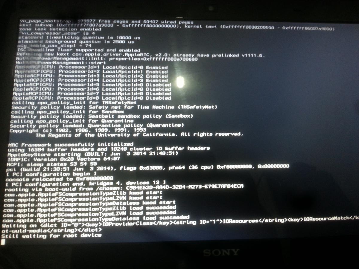

mathpinab Posted July 30, 2014 Share Posted July 30, 2014 Olá pessoal, estou tendo problemas pra fazer o hack neste laptop pra poder começar eu não consigo dar boot na instalação retail de forma alguma, fica travado nisso, o q devo fazer? Link to comment https://www.insanelymac.com/forum/topic/299918-instala%C3%A7%C3%A3o-no-sony-vaio-sve14123cbb-intel-hd-4000/ Share on other sites More sharing options...
Allan Posted July 30, 2014 Share Posted July 30, 2014 Configure seu BIOS: http://olarila.com/forum/viewtopic.php?f=2&t=1804 E se persistir, veja isso: http://olarila.com/forum/viewtopic.php?f=2&t=36 Ou como notei, você tem entradas USB 3.0, leia isso: Still waiting for root device: This happens because: Using a 3.0 USB port to boot into the installer without having GenericUSBXHCI.kext in /Extra/Extensions or /EFI/Clover/kexts of the USB Sata Mode isn’t set to AHCI in BIOS or is in RAID Mode that Apple doesn’t support To fix this: Add GenericUSBXHCI.kext to /Extra Extensions or /EFI/Clover/kexts of the USB Add AHCIInjector.kext for systems using RAID Mode Set Sata Mode to AHCI If using Clover, you can try creating a config.plist with “still waiting for root device“ patch and use it Link to comment https://www.insanelymac.com/forum/topic/299918-instala%C3%A7%C3%A3o-no-sony-vaio-sve14123cbb-intel-hd-4000/#findComment-2046263 Share on other sites More sharing options...
