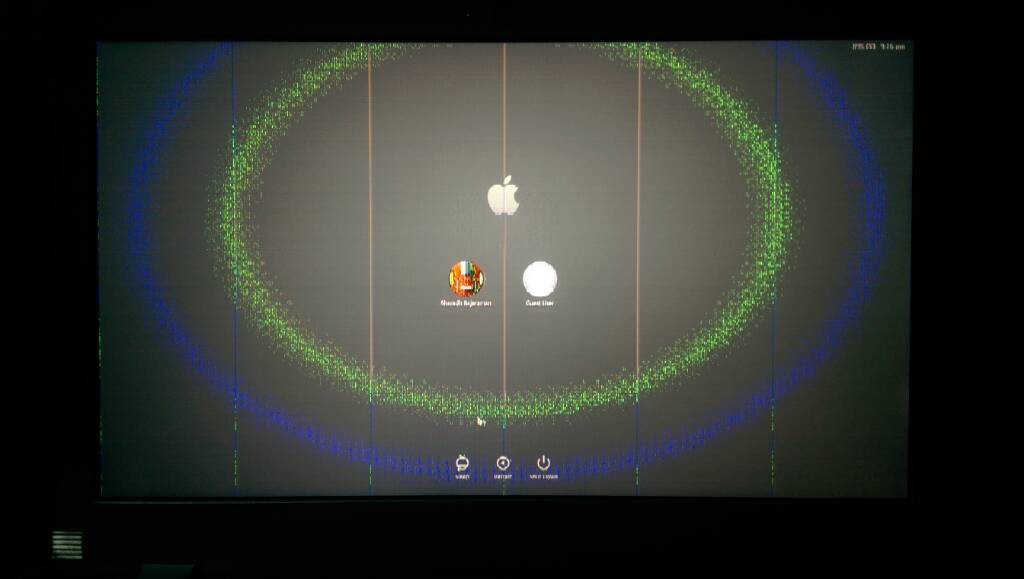

SRSR333 Posted July 14, 2014 Author Share Posted July 14, 2014 This is an example of what I see, most of the time. As mentioned I get very inconsistent results, so I sometimes get just minor artifacts, sometimes this garbling, and sometimes a perfect screen. I've installed Chimera, all necessary drivers and power management onto my OS SSD, and with all IGPlatformID values, I see such a screen, or even worse, a completely black or grey screen with vertical lines. Oddly, the problem solves itself when the screen goes to sleep, and I tap the keyboard to turn it on. I get full acceleration, but such screen garbling is unbearable. It flashes a lot and I have to wait a couple minutes every time before I can log in. Link to comment https://www.insanelymac.com/forum/topic/299464-intel-hd-4600-not-working/#findComment-2040485 Share on other sites More sharing options...
RehabMan Posted July 14, 2014 Share Posted July 14, 2014 IMAG0535.jpg This is an example of what I see, most of the time. As mentioned I get very inconsistent results, so I sometimes get just minor artifacts, sometimes this garbling, and sometimes a perfect screen. I've installed Chimera, all necessary drivers and power management onto my OS SSD, and with all IGPlatformID values, I see such a screen, or even worse, a completely black or grey screen with vertical lines. Oddly, the problem solves itself when the screen goes to sleep, and I tap the keyboard to turn it on. I get full acceleration, but such screen garbling is unbearable. It flashes a lot and I have to wait a couple minutes every time before I can log in. Try setting the resolution of the bootloader to match your native LCD panel resolution. It could also be a brightness control issue... So, if you haven't fixed brightness yet, you should do that first. Link to comment https://www.insanelymac.com/forum/topic/299464-intel-hd-4600-not-working/#findComment-2040495 Share on other sites More sharing options...
SRSR333 Posted July 14, 2014 Author Share Posted July 14, 2014 Try setting the resolution of the bootloader to match your native LCD panel resolution. It could also be a brightness control issue... So, if you haven't fixed brightness yet, you should do that first. By 'setting resolution', do you mean adding "Graphics Mode"="1920x1080x32" to my boot arguments? As for brightness, I intend to fix that alongside my DSDT, once I get MaciASL working. It doesn't start up, when it was perfectly fine just a couple of hours ago. Link to comment https://www.insanelymac.com/forum/topic/299464-intel-hd-4600-not-working/#findComment-2040496 Share on other sites More sharing options...
