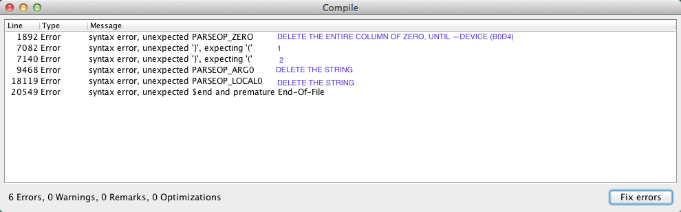

Trying to compile a DSDT for my new Asus N56JR laptop but cannot seem to resolve the errors, which are as follows:
(156 errors before using 'fix errors' with DSDT Editor)
Attached is my DSL if anyone knows how to resolve these issues :(
Thanks!
Update:  I managed to edit out all of the errors, but have some warnings and notices that I cannot get rid of.  If anyone cares to help out with this, attached is my edited (fixed) DSDT as well..

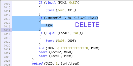

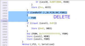

Ok, it's complicated to explain... but:
First fix the lines 1892, 9468 and 18119
Now proceed with the line 7082:
And with the line 7140:

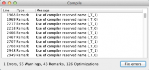

Compile and you see this:
Apply patch for T_X Rename and correct other errors, warning and remarks.
I attach the fixed DSDT
ASUS-N56JR-DSDRT.aml.zip
