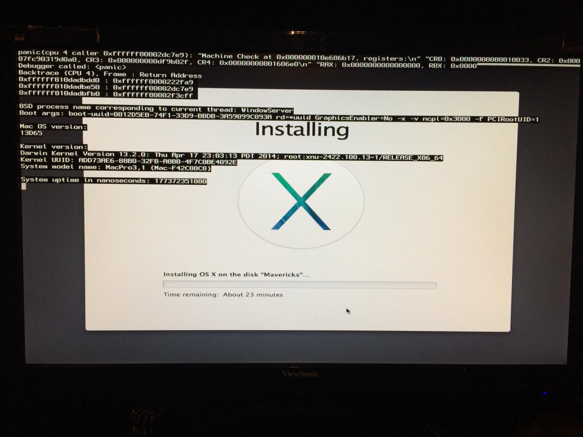

La Pistola Posted June 8, 2014 Share Posted June 8, 2014 Ok, I bought these parts because they were on the list of approved list over at tonymax86. Motherboard: GA-Z87X-UD5 THCPU: Intel Core i7-4770K Quad-CoreMemory: Crucial Ballistix Tactical Tracer 16GB Kit (8GBx2) DDR3 1600 MT/s (PC3-12800)Graphics: EVGA GeForce GTX550TiHD: Seagate Barracuda 1 TB 7200RPM SATAPower Supply: Corsair RM Series 650 Watt ATX/EPS 80PLUSWireless: TP-LINK TL-WDN4800 Dual Band Wireless N900 PCI Express Adapter Because I am having so much trouble installing, I have reduced the build down to one stick of ram, and the on-board GPU for now. The problem: When I boot with my USB drive I made with #####, everything seems fine up until it starts installing OS X. It goes for a few min, then gives me an error like this: Panic(cpu 4 caller 0xffffff80002dc7e9)" "Machine Check at 0x000000010d5be3, registers:\n" "CR0: 0x0000000080010033, CR2: 0x000000011dc4a000, CR3: 0x000000000d45e029, CR4" 0x00000000001606e0\n" "RAX: 0x000000000000a01c, RBX: 0x0000 Backtrace (CPU 4), Frame : Return Address 0xffffff810c0e3dd0 : 0xffffff8000222fa9 0xffffff810c0e3e50 : 0xffffff80002dc7e9 0xffffff810c0e3fb0 : 0xffffff80002f3cff BSD process name corresponding to current thread: OS X Installer Boot args: boot-uuid=EEEDA047-BF5F-31E8-9E5D-02E04C5DC583 rd=*uuid -x GraphicsEnabler=Yes -v Mac OS Version 13D65 Kernel version: Darein Kernel Version 13.2.0: Thu Ape 17 23:03:13 PDT 2014; root:xnu-2422.100.13~1/RELEASE_X86_64 Kernel UUID: ADD73AE6-88B0-32FB-A8BB-4F7C8BE4092E System model name: MacPro3,1 (Mac-F42C88C8) System uptime in nanoseconds: 166964622842 and looks something like this: Things I have tried: Changing Ram Sticks. (the other 8GB Crucial Ballistix Tactical Tracer stick, and two other 4GB sticks, one at a time.) Many different boot flag combos, including: -x -v -f GraphicsEnabler=Yes GraphicsEnabler=No PCIRootUID=1 PCIRootUID=0 npci=0x3000 maxmem=2048 maxmem=4096 Used a few different USB drives Used a friends USB drive that he used to install Mavericks on his machine Swapped out to a different Hard Drive None of that seems to have changed the outcome as far as I can tell. Here is a link to what is in the log that the installer writes to the hard drive when it fails. http://pastebin.com/wefJfD55 Here is an album of bios screenshots: https://www.dropbox.com/sh/45202occr6e2vve/AABunogK3yQ7CADNzpWCZDhKa 1 Link to comment https://www.insanelymac.com/forum/topic/298615-ga-z87x-ud5-th-cpu-panic-error-on-install/ Share on other sites More sharing options...

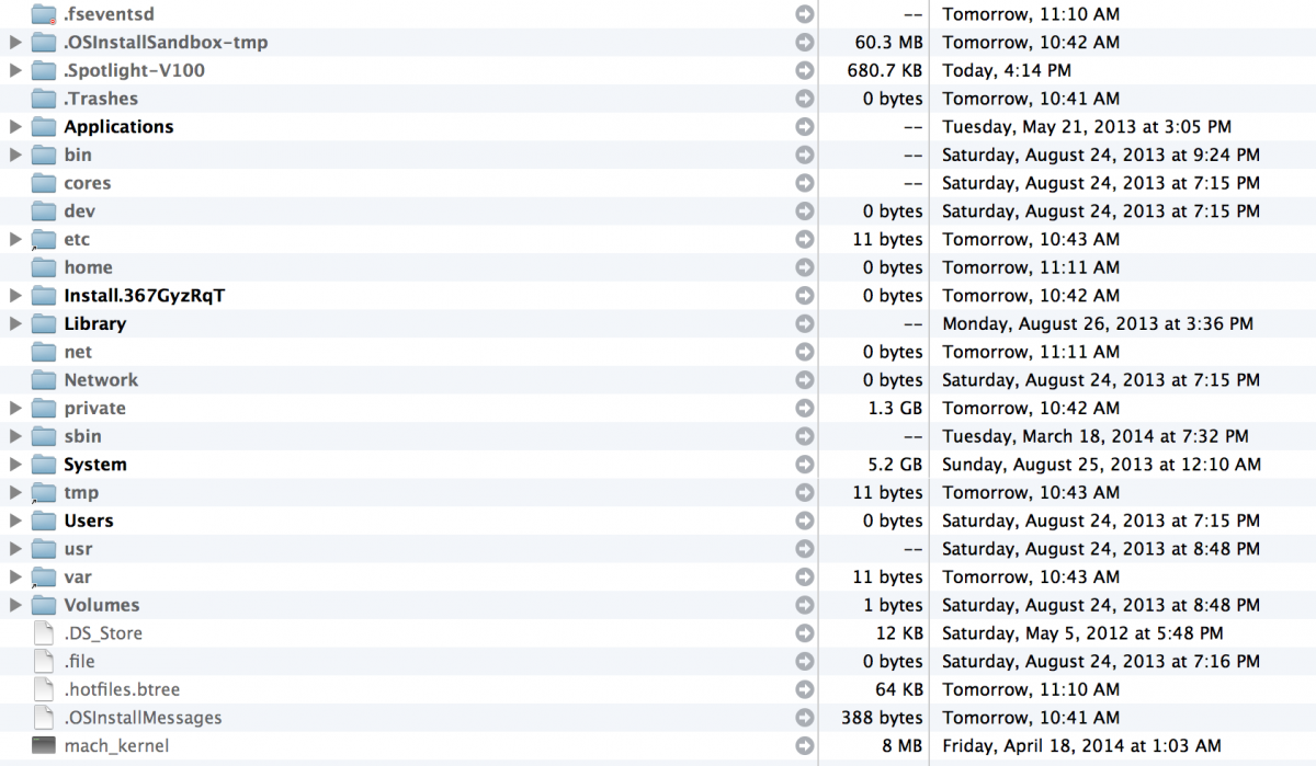

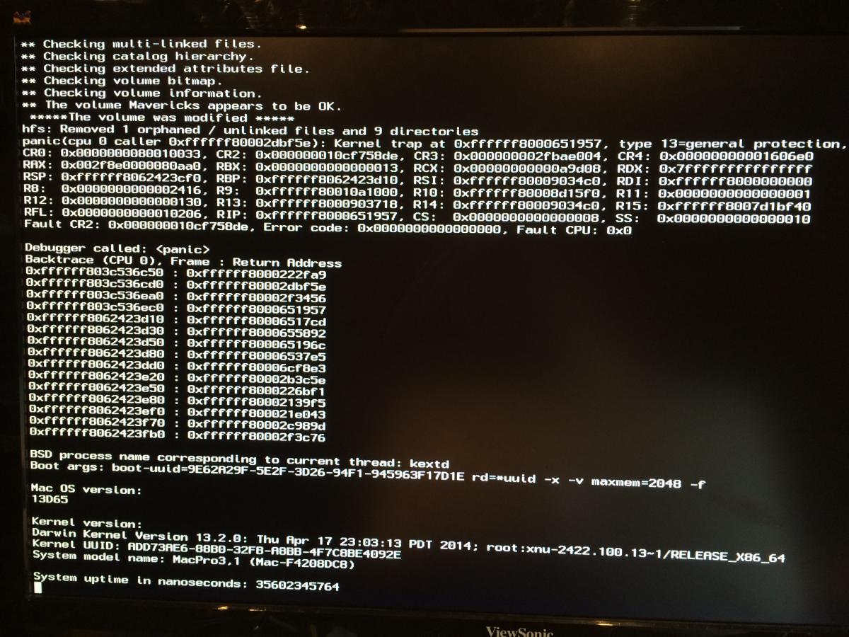

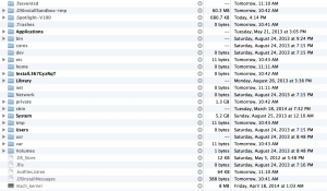

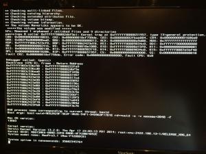

La Pistola Posted June 8, 2014 Author Share Posted June 8, 2014 Ok, I got it... kind of. I used the "MyHack" app this time, and it managed to install, but it crashed at the end when another myhack menu came up at the end of the install (more or less the same cpu Panic error). When I try to boot to the installed hard drive, I get to the part about migrating from another computer, and it crashes when I tell it to skip (more or less the same cpu Panic error). Here is what the drive that I installed to looks like when I hook it to my laptop: To get it to install/boot I used -x -v flags. So, what do I do now? Thanks for your help guys! Here is the only log file I could find: (mkmf.log) find_header: checking for sqlite3.h... -------------------- yes "xcrun clang -o conftest -I//System/Library/Frameworks/Ruby.framework/Versions/2.0/usr/include/ruby-2.0.0/universal-darwin13 -I//System/Library/Frameworks/Ruby.framework/Versions/2.0/usr/include/ruby-2.0.0/ruby/backward -I//System/Library/Frameworks/Ruby.framework/Versions/2.0/usr/include/ruby-2.0.0 -I. -D_XOPEN_SOURCE -D_DARWIN_C_SOURCE -D_DARWIN_UNLIMITED_SELECT -D_REENTRANT -g -Os -pipe conftest.c -L. -L/System/Library/Frameworks/Ruby.framework/Versions/2.0/usr/lib -L. -L/usr/local/lib -arch x86_64 -lruby.2.0.0 -lpthread -ldl -lobjc " /Applications/Xcode.app/Contents/Developer/Toolchains/OSX10.9.xctoolchain/usr/bin/clang -o conftest -I//System/Library/Frameworks/Ruby.framework/Versions/2.0/usr/include/ruby-2.0.0/universal-darwin13 -I//System/Library/Frameworks/Ruby.framework/Versions/2.0/usr/include/ruby-2.0.0/ruby/backward -I//System/Library/Frameworks/Ruby.framework/Versions/2.0/usr/include/ruby-2.0.0 -I. -D_XOPEN_SOURCE -D_DARWIN_C_SOURCE -D_DARWIN_UNLIMITED_SELECT -D_REENTRANT -g -Os -pipe conftest.c -L. -L/System/Library/Frameworks/Ruby.framework/Versions/2.0/usr/lib -L. -L/usr/local/lib -arch x86_64 -lruby.2.0.0 -lpthread -ldl -lobjc checked program was: /* begin */ 1: #include "ruby.h" 2: 3: int main(int argc, char **argv) 4: { 5: return 0; 6: } /* end */ "xcrun clang -I//System/Library/Frameworks/Ruby.framework/Versions/2.0/usr/include/ruby-2.0.0/universal-darwin13 -I//System/Library/Frameworks/Ruby.framework/Versions/2.0/usr/include/ruby-2.0.0/ruby/backward -I//System/Library/Frameworks/Ruby.framework/Versions/2.0/usr/include/ruby-2.0.0 -I. -D_XOPEN_SOURCE -D_DARWIN_C_SOURCE -D_DARWIN_UNLIMITED_SELECT -D_REENTRANT -g -Os -pipe -arch x86_64 -c conftest.c" /Applications/Xcode.app/Contents/Developer/Toolchains/OSX10.9.xctoolchain/usr/bin/clang -I//System/Library/Frameworks/Ruby.framework/Versions/2.0/usr/include/ruby-2.0.0/universal-darwin13 -I//System/Library/Frameworks/Ruby.framework/Versions/2.0/usr/include/ruby-2.0.0/ruby/backward -I//System/Library/Frameworks/Ruby.framework/Versions/2.0/usr/include/ruby-2.0.0 -I. -D_XOPEN_SOURCE -D_DARWIN_C_SOURCE -D_DARWIN_UNLIMITED_SELECT -D_REENTRANT -g -Os -pipe -arch x86_64 -c conftest.c checked program was: /* begin */ 1: #include "ruby.h" 2: 3: #include <sqlite3.h> /* end */ -------------------- find_library: checking for sqlite3_libversion_number() in -lsqlite3... -------------------- yes "xcrun clang -o conftest -I//System/Library/Frameworks/Ruby.framework/Versions/2.0/usr/include/ruby-2.0.0/universal-darwin13 -I//System/Library/Frameworks/Ruby.framework/Versions/2.0/usr/include/ruby-2.0.0/ruby/backward -I//System/Library/Frameworks/Ruby.framework/Versions/2.0/usr/include/ruby-2.0.0 -I. -D_XOPEN_SOURCE -D_DARWIN_C_SOURCE -D_DARWIN_UNLIMITED_SELECT -D_REENTRANT -g -Os -pipe conftest.c -L. -L/System/Library/Frameworks/Ruby.framework/Versions/2.0/usr/lib -L. -L/usr/local/lib -arch x86_64 -lruby.2.0.0 -lsqlite3 -lpthread -ldl -lobjc " /Applications/Xcode.app/Contents/Developer/Toolchains/OSX10.9.xctoolchain/usr/bin/clang -o conftest -I//System/Library/Frameworks/Ruby.framework/Versions/2.0/usr/include/ruby-2.0.0/universal-darwin13 -I//System/Library/Frameworks/Ruby.framework/Versions/2.0/usr/include/ruby-2.0.0/ruby/backward -I//System/Library/Frameworks/Ruby.framework/Versions/2.0/usr/include/ruby-2.0.0 -I. -D_XOPEN_SOURCE -D_DARWIN_C_SOURCE -D_DARWIN_UNLIMITED_SELECT -D_REENTRANT -g -Os -pipe conftest.c -L. -L/System/Library/Frameworks/Ruby.framework/Versions/2.0/usr/lib -L. -L/usr/local/lib -arch x86_64 -lruby.2.0.0 -lsqlite3 -lpthread -ldl -lobjc conftest.c:5:57: error: use of undeclared identifier 'sqlite3_libversion_number' int t(void) { void ((*volatile p)()); p = (void ((*)()))sqlite3_libversion_number; return 0; } ^ 1 error generated. checked program was: /* begin */ 1: #include "ruby.h" 2: 3: /*top*/ 4: extern int t(void); 5: int t(void) { void ((*volatile p)()); p = (void ((*)()))sqlite3_libversion_number; return 0; } 6: int main(int argc, char **argv) 7: { 8: if (argc > 1000000) { 9: printf("%p", &t); 10: } 11: 12: return 0; 13: } /* end */ "xcrun clang -o conftest -I//System/Library/Frameworks/Ruby.framework/Versions/2.0/usr/include/ruby-2.0.0/universal-darwin13 -I//System/Library/Frameworks/Ruby.framework/Versions/2.0/usr/include/ruby-2.0.0/ruby/backward -I//System/Library/Frameworks/Ruby.framework/Versions/2.0/usr/include/ruby-2.0.0 -I. -D_XOPEN_SOURCE -D_DARWIN_C_SOURCE -D_DARWIN_UNLIMITED_SELECT -D_REENTRANT -g -Os -pipe conftest.c -L. -L/System/Library/Frameworks/Ruby.framework/Versions/2.0/usr/lib -L. -L/usr/local/lib -arch x86_64 -lruby.2.0.0 -lsqlite3 -lpthread -ldl -lobjc " /Applications/Xcode.app/Contents/Developer/Toolchains/OSX10.9.xctoolchain/usr/bin/clang -o conftest -I//System/Library/Frameworks/Ruby.framework/Versions/2.0/usr/include/ruby-2.0.0/universal-darwin13 -I//System/Library/Frameworks/Ruby.framework/Versions/2.0/usr/include/ruby-2.0.0/ruby/backward -I//System/Library/Frameworks/Ruby.framework/Versions/2.0/usr/include/ruby-2.0.0 -I. -D_XOPEN_SOURCE -D_DARWIN_C_SOURCE -D_DARWIN_UNLIMITED_SELECT -D_REENTRANT -g -Os -pipe conftest.c -L. -L/System/Library/Frameworks/Ruby.framework/Versions/2.0/usr/lib -L. -L/usr/local/lib -arch x86_64 -lruby.2.0.0 -lsqlite3 -lpthread -ldl -lobjc conftest.c:5:15: warning: implicit declaration of function 'sqlite3_libversion_number' is invalid in C99 [-Wimplicit-function-declaration] int t(void) { sqlite3_libversion_number(); return 0; } ^ 1 warning generated. checked program was: /* begin */ 1: #include "ruby.h" 2: 3: /*top*/ 4: extern int t(void); 5: int t(void) { sqlite3_libversion_number(); return 0; } 6: int main(int argc, char **argv) 7: { 8: if (argc > 1000000) { 9: printf("%p", &t); 10: } 11: 12: return 0; 13: } /* end */ -------------------- have_func: checking for rb_proc_arity()... -------------------- yes "xcrun clang -o conftest -I//System/Library/Frameworks/Ruby.framework/Versions/2.0/usr/include/ruby-2.0.0/universal-darwin13 -I//System/Library/Frameworks/Ruby.framework/Versions/2.0/usr/include/ruby-2.0.0/ruby/backward -I//System/Library/Frameworks/Ruby.framework/Versions/2.0/usr/include/ruby-2.0.0 -I. -D_XOPEN_SOURCE -D_DARWIN_C_SOURCE -D_DARWIN_UNLIMITED_SELECT -D_REENTRANT -g -Os -pipe conftest.c -L. -L/System/Library/Frameworks/Ruby.framework/Versions/2.0/usr/lib -L. -L/usr/local/lib -arch x86_64 -lsqlite3 -lruby.2.0.0 -lsqlite3 -lpthread -ldl -lobjc " /Applications/Xcode.app/Contents/Developer/Toolchains/OSX10.9.xctoolchain/usr/bin/clang -o conftest -I//System/Library/Frameworks/Ruby.framework/Versions/2.0/usr/include/ruby-2.0.0/universal-darwin13 -I//System/Library/Frameworks/Ruby.framework/Versions/2.0/usr/include/ruby-2.0.0/ruby/backward -I//System/Library/Frameworks/Ruby.framework/Versions/2.0/usr/include/ruby-2.0.0 -I. -D_XOPEN_SOURCE -D_DARWIN_C_SOURCE -D_DARWIN_UNLIMITED_SELECT -D_REENTRANT -g -Os -pipe conftest.c -L. -L/System/Library/Frameworks/Ruby.framework/Versions/2.0/usr/lib -L. -L/usr/local/lib -arch x86_64 -lsqlite3 -lruby.2.0.0 -lsqlite3 -lpthread -ldl -lobjc checked program was: /* begin */ 1: #include "ruby.h" 2: 3: /*top*/ 4: extern int t(void); 5: int t(void) { void ((*volatile p)()); p = (void ((*)()))rb_proc_arity; return 0; } 6: int main(int argc, char **argv) 7: { 8: if (argc > 1000000) { 9: printf("%p", &t); 10: } 11: 12: return 0; 13: } /* end */ -------------------- have_func: checking for sqlite3_initialize()... -------------------- yes "xcrun clang -o conftest -I//System/Library/Frameworks/Ruby.framework/Versions/2.0/usr/include/ruby-2.0.0/universal-darwin13 -I//System/Library/Frameworks/Ruby.framework/Versions/2.0/usr/include/ruby-2.0.0/ruby/backward -I//System/Library/Frameworks/Ruby.framework/Versions/2.0/usr/include/ruby-2.0.0 -I. -D_XOPEN_SOURCE -D_DARWIN_C_SOURCE -D_DARWIN_UNLIMITED_SELECT -D_REENTRANT -g -Os -pipe conftest.c -L. -L/System/Library/Frameworks/Ruby.framework/Versions/2.0/usr/lib -L. -L/usr/local/lib -arch x86_64 -lsqlite3 -lruby.2.0.0 -lsqlite3 -lpthread -ldl -lobjc " /Applications/Xcode.app/Contents/Developer/Toolchains/OSX10.9.xctoolchain/usr/bin/clang -o conftest -I//System/Library/Frameworks/Ruby.framework/Versions/2.0/usr/include/ruby-2.0.0/universal-darwin13 -I//System/Library/Frameworks/Ruby.framework/Versions/2.0/usr/include/ruby-2.0.0/ruby/backward -I//System/Library/Frameworks/Ruby.framework/Versions/2.0/usr/include/ruby-2.0.0 -I. -D_XOPEN_SOURCE -D_DARWIN_C_SOURCE -D_DARWIN_UNLIMITED_SELECT -D_REENTRANT -g -Os -pipe conftest.c -L. -L/System/Library/Frameworks/Ruby.framework/Versions/2.0/usr/lib -L. -L/usr/local/lib -arch x86_64 -lsqlite3 -lruby.2.0.0 -lsqlite3 -lpthread -ldl -lobjc conftest.c:5:57: error: use of undeclared identifier 'sqlite3_initialize' int t(void) { void ((*volatile p)()); p = (void ((*)()))sqlite3_initialize; return 0; } ^ 1 error generated. checked program was: /* begin */ 1: #include "ruby.h" 2: 3: /*top*/ 4: extern int t(void); 5: int t(void) { void ((*volatile p)()); p = (void ((*)()))sqlite3_initialize; return 0; } 6: int main(int argc, char **argv) 7: { 8: if (argc > 1000000) { 9: printf("%p", &t); 10: } 11: 12: return 0; 13: } /* end */ "xcrun clang -o conftest -I//System/Library/Frameworks/Ruby.framework/Versions/2.0/usr/include/ruby-2.0.0/universal-darwin13 -I//System/Library/Frameworks/Ruby.framework/Versions/2.0/usr/include/ruby-2.0.0/ruby/backward -I//System/Library/Frameworks/Ruby.framework/Versions/2.0/usr/include/ruby-2.0.0 -I. -D_XOPEN_SOURCE -D_DARWIN_C_SOURCE -D_DARWIN_UNLIMITED_SELECT -D_REENTRANT -g -Os -pipe conftest.c -L. -L/System/Library/Frameworks/Ruby.framework/Versions/2.0/usr/lib -L. -L/usr/local/lib -arch x86_64 -lsqlite3 -lruby.2.0.0 -lsqlite3 -lpthread -ldl -lobjc " /Applications/Xcode.app/Contents/Developer/Toolchains/OSX10.9.xctoolchain/usr/bin/clang -o conftest -I//System/Library/Frameworks/Ruby.framework/Versions/2.0/usr/include/ruby-2.0.0/universal-darwin13 -I//System/Library/Frameworks/Ruby.framework/Versions/2.0/usr/include/ruby-2.0.0/ruby/backward -I//System/Library/Frameworks/Ruby.framework/Versions/2.0/usr/include/ruby-2.0.0 -I. -D_XOPEN_SOURCE -D_DARWIN_C_SOURCE -D_DARWIN_UNLIMITED_SELECT -D_REENTRANT -g -Os -pipe conftest.c -L. -L/System/Library/Frameworks/Ruby.framework/Versions/2.0/usr/lib -L. -L/usr/local/lib -arch x86_64 -lsqlite3 -lruby.2.0.0 -lsqlite3 -lpthread -ldl -lobjc conftest.c:5:15: warning: implicit declaration of function 'sqlite3_initialize' is invalid in C99 [-Wimplicit-function-declaration] int t(void) { sqlite3_initialize(); return 0; } ^ 1 warning generated. checked program was: /* begin */ 1: #include "ruby.h" 2: 3: /*top*/ 4: extern int t(void); 5: int t(void) { sqlite3_initialize(); return 0; } 6: int main(int argc, char **argv) 7: { 8: if (argc > 1000000) { 9: printf("%p", &t); 10: } 11: 12: return 0; 13: } /* end */ -------------------- have_func: checking for sqlite3_backup_init()... -------------------- yes "xcrun clang -o conftest -I//System/Library/Frameworks/Ruby.framework/Versions/2.0/usr/include/ruby-2.0.0/universal-darwin13 -I//System/Library/Frameworks/Ruby.framework/Versions/2.0/usr/include/ruby-2.0.0/ruby/backward -I//System/Library/Frameworks/Ruby.framework/Versions/2.0/usr/include/ruby-2.0.0 -I. -D_XOPEN_SOURCE -D_DARWIN_C_SOURCE -D_DARWIN_UNLIMITED_SELECT -D_REENTRANT -g -Os -pipe conftest.c -L. -L/System/Library/Frameworks/Ruby.framework/Versions/2.0/usr/lib -L. -L/usr/local/lib -arch x86_64 -lsqlite3 -lruby.2.0.0 -lsqlite3 -lpthread -ldl -lobjc " /Applications/Xcode.app/Contents/Developer/Toolchains/OSX10.9.xctoolchain/usr/bin/clang -o conftest -I//System/Library/Frameworks/Ruby.framework/Versions/2.0/usr/include/ruby-2.0.0/universal-darwin13 -I//System/Library/Frameworks/Ruby.framework/Versions/2.0/usr/include/ruby-2.0.0/ruby/backward -I//System/Library/Frameworks/Ruby.framework/Versions/2.0/usr/include/ruby-2.0.0 -I. -D_XOPEN_SOURCE -D_DARWIN_C_SOURCE -D_DARWIN_UNLIMITED_SELECT -D_REENTRANT -g -Os -pipe conftest.c -L. -L/System/Library/Frameworks/Ruby.framework/Versions/2.0/usr/lib -L. -L/usr/local/lib -arch x86_64 -lsqlite3 -lruby.2.0.0 -lsqlite3 -lpthread -ldl -lobjc conftest.c:5:57: error: use of undeclared identifier 'sqlite3_backup_init' int t(void) { void ((*volatile p)()); p = (void ((*)()))sqlite3_backup_init; return 0; } ^ 1 error generated. checked program was: /* begin */ 1: #include "ruby.h" 2: 3: /*top*/ 4: extern int t(void); 5: int t(void) { void ((*volatile p)()); p = (void ((*)()))sqlite3_backup_init; return 0; } 6: int main(int argc, char **argv) 7: { 8: if (argc > 1000000) { 9: printf("%p", &t); 10: } 11: 12: return 0; 13: } /* end */ "xcrun clang -o conftest -I//System/Library/Frameworks/Ruby.framework/Versions/2.0/usr/include/ruby-2.0.0/universal-darwin13 -I//System/Library/Frameworks/Ruby.framework/Versions/2.0/usr/include/ruby-2.0.0/ruby/backward -I//System/Library/Frameworks/Ruby.framework/Versions/2.0/usr/include/ruby-2.0.0 -I. -D_XOPEN_SOURCE -D_DARWIN_C_SOURCE -D_DARWIN_UNLIMITED_SELECT -D_REENTRANT -g -Os -pipe conftest.c -L. -L/System/Library/Frameworks/Ruby.framework/Versions/2.0/usr/lib -L. -L/usr/local/lib -arch x86_64 -lsqlite3 -lruby.2.0.0 -lsqlite3 -lpthread -ldl -lobjc " /Applications/Xcode.app/Contents/Developer/Toolchains/OSX10.9.xctoolchain/usr/bin/clang -o conftest -I//System/Library/Frameworks/Ruby.framework/Versions/2.0/usr/include/ruby-2.0.0/universal-darwin13 -I//System/Library/Frameworks/Ruby.framework/Versions/2.0/usr/include/ruby-2.0.0/ruby/backward -I//System/Library/Frameworks/Ruby.framework/Versions/2.0/usr/include/ruby-2.0.0 -I. -D_XOPEN_SOURCE -D_DARWIN_C_SOURCE -D_DARWIN_UNLIMITED_SELECT -D_REENTRANT -g -Os -pipe conftest.c -L. -L/System/Library/Frameworks/Ruby.framework/Versions/2.0/usr/lib -L. -L/usr/local/lib -arch x86_64 -lsqlite3 -lruby.2.0.0 -lsqlite3 -lpthread -ldl -lobjc conftest.c:5:15: warning: implicit declaration of function 'sqlite3_backup_init' is invalid in C99 [-Wimplicit-function-declaration] int t(void) { sqlite3_backup_init(); return 0; } ^ 1 warning generated. checked program was: /* begin */ 1: #include "ruby.h" 2: 3: /*top*/ 4: extern int t(void); 5: int t(void) { sqlite3_backup_init(); return 0; } 6: int main(int argc, char **argv) 7: { 8: if (argc > 1000000) { 9: printf("%p", &t); 10: } 11: 12: return 0; 13: } /* end */ -------------------- have_func: checking for sqlite3_column_database_name()... -------------------- no "xcrun clang -o conftest -I//System/Library/Frameworks/Ruby.framework/Versions/2.0/usr/include/ruby-2.0.0/universal-darwin13 -I//System/Library/Frameworks/Ruby.framework/Versions/2.0/usr/include/ruby-2.0.0/ruby/backward -I//System/Library/Frameworks/Ruby.framework/Versions/2.0/usr/include/ruby-2.0.0 -I. -D_XOPEN_SOURCE -D_DARWIN_C_SOURCE -D_DARWIN_UNLIMITED_SELECT -D_REENTRANT -g -Os -pipe conftest.c -L. -L/System/Library/Frameworks/Ruby.framework/Versions/2.0/usr/lib -L. -L/usr/local/lib -arch x86_64 -lsqlite3 -lruby.2.0.0 -lsqlite3 -lpthread -ldl -lobjc " /Applications/Xcode.app/Contents/Developer/Toolchains/OSX10.9.xctoolchain/usr/bin/clang -o conftest -I//System/Library/Frameworks/Ruby.framework/Versions/2.0/usr/include/ruby-2.0.0/universal-darwin13 -I//System/Library/Frameworks/Ruby.framework/Versions/2.0/usr/include/ruby-2.0.0/ruby/backward -I//System/Library/Frameworks/Ruby.framework/Versions/2.0/usr/include/ruby-2.0.0 -I. -D_XOPEN_SOURCE -D_DARWIN_C_SOURCE -D_DARWIN_UNLIMITED_SELECT -D_REENTRANT -g -Os -pipe conftest.c -L. -L/System/Library/Frameworks/Ruby.framework/Versions/2.0/usr/lib -L. -L/usr/local/lib -arch x86_64 -lsqlite3 -lruby.2.0.0 -lsqlite3 -lpthread -ldl -lobjc conftest.c:5:57: error: use of undeclared identifier 'sqlite3_column_database_name' int t(void) { void ((*volatile p)()); p = (void ((*)()))sqlite3_column_database_name; return 0; } ^ 1 error generated. checked program was: /* begin */ 1: #include "ruby.h" 2: 3: /*top*/ 4: extern int t(void); 5: int t(void) { void ((*volatile p)()); p = (void ((*)()))sqlite3_column_database_name; return 0; } 6: int main(int argc, char **argv) 7: { 8: if (argc > 1000000) { 9: printf("%p", &t); 10: } 11: 12: return 0; 13: } /* end */ "xcrun clang -o conftest -I//System/Library/Frameworks/Ruby.framework/Versions/2.0/usr/include/ruby-2.0.0/universal-darwin13 -I//System/Library/Frameworks/Ruby.framework/Versions/2.0/usr/include/ruby-2.0.0/ruby/backward -I//System/Library/Frameworks/Ruby.framework/Versions/2.0/usr/include/ruby-2.0.0 -I. -D_XOPEN_SOURCE -D_DARWIN_C_SOURCE -D_DARWIN_UNLIMITED_SELECT -D_REENTRANT -g -Os -pipe conftest.c -L. -L/System/Library/Frameworks/Ruby.framework/Versions/2.0/usr/lib -L. -L/usr/local/lib -arch x86_64 -lsqlite3 -lruby.2.0.0 -lsqlite3 -lpthread -ldl -lobjc " /Applications/Xcode.app/Contents/Developer/Toolchains/OSX10.9.xctoolchain/usr/bin/clang -o conftest -I//System/Library/Frameworks/Ruby.framework/Versions/2.0/usr/include/ruby-2.0.0/universal-darwin13 -I//System/Library/Frameworks/Ruby.framework/Versions/2.0/usr/include/ruby-2.0.0/ruby/backward -I//System/Library/Frameworks/Ruby.framework/Versions/2.0/usr/include/ruby-2.0.0 -I. -D_XOPEN_SOURCE -D_DARWIN_C_SOURCE -D_DARWIN_UNLIMITED_SELECT -D_REENTRANT -g -Os -pipe conftest.c -L. -L/System/Library/Frameworks/Ruby.framework/Versions/2.0/usr/lib -L. -L/usr/local/lib -arch x86_64 -lsqlite3 -lruby.2.0.0 -lsqlite3 -lpthread -ldl -lobjc conftest.c:5:15: warning: implicit declaration of function 'sqlite3_column_database_name' is invalid in C99 [-Wimplicit-function-declaration] int t(void) { sqlite3_column_database_name(); return 0; } ^ 1 warning generated. Undefined symbols for architecture x86_64: "_sqlite3_column_database_name", referenced from: _t in conftest-VSYjcN.o ld: symbol(s) not found for architecture x86_64 clang: error: linker command failed with exit code 1 (use -v to see invocation) checked program was: /* begin */ 1: #include "ruby.h" 2: 3: /*top*/ 4: extern int t(void); 5: int t(void) { sqlite3_column_database_name(); return 0; } 6: int main(int argc, char **argv) 7: { 8: if (argc > 1000000) { 9: printf("%p", &t); 10: } 11: 12: return 0; 13: } /* end */ -------------------- have_func: checking for sqlite3_enable_load_extension()... -------------------- no "xcrun clang -o conftest -I//System/Library/Frameworks/Ruby.framework/Versions/2.0/usr/include/ruby-2.0.0/universal-darwin13 -I//System/Library/Frameworks/Ruby.framework/Versions/2.0/usr/include/ruby-2.0.0/ruby/backward -I//System/Library/Frameworks/Ruby.framework/Versions/2.0/usr/include/ruby-2.0.0 -I. -D_XOPEN_SOURCE -D_DARWIN_C_SOURCE -D_DARWIN_UNLIMITED_SELECT -D_REENTRANT -g -Os -pipe conftest.c -L. -L/System/Library/Frameworks/Ruby.framework/Versions/2.0/usr/lib -L. -L/usr/local/lib -arch x86_64 -lsqlite3 -lruby.2.0.0 -lsqlite3 -lpthread -ldl -lobjc " /Applications/Xcode.app/Contents/Developer/Toolchains/OSX10.9.xctoolchain/usr/bin/clang -o conftest -I//System/Library/Frameworks/Ruby.framework/Versions/2.0/usr/include/ruby-2.0.0/universal-darwin13 -I//System/Library/Frameworks/Ruby.framework/Versions/2.0/usr/include/ruby-2.0.0/ruby/backward -I//System/Library/Frameworks/Ruby.framework/Versions/2.0/usr/include/ruby-2.0.0 -I. -D_XOPEN_SOURCE -D_DARWIN_C_SOURCE -D_DARWIN_UNLIMITED_SELECT -D_REENTRANT -g -Os -pipe conftest.c -L. -L/System/Library/Frameworks/Ruby.framework/Versions/2.0/usr/lib -L. -L/usr/local/lib -arch x86_64 -lsqlite3 -lruby.2.0.0 -lsqlite3 -lpthread -ldl -lobjc conftest.c:5:57: error: use of undeclared identifier 'sqlite3_enable_load_extension' int t(void) { void ((*volatile p)()); p = (void ((*)()))sqlite3_enable_load_extension; return 0; } ^ 1 error generated. checked program was: /* begin */ 1: #include "ruby.h" 2: 3: /*top*/ 4: extern int t(void); 5: int t(void) { void ((*volatile p)()); p = (void ((*)()))sqlite3_enable_load_extension; return 0; } 6: int main(int argc, char **argv) 7: { 8: if (argc > 1000000) { 9: printf("%p", &t); 10: } 11: 12: return 0; 13: } /* end */ "xcrun clang -o conftest -I//System/Library/Frameworks/Ruby.framework/Versions/2.0/usr/include/ruby-2.0.0/universal-darwin13 -I//System/Library/Frameworks/Ruby.framework/Versions/2.0/usr/include/ruby-2.0.0/ruby/backward -I//System/Library/Frameworks/Ruby.framework/Versions/2.0/usr/include/ruby-2.0.0 -I. -D_XOPEN_SOURCE -D_DARWIN_C_SOURCE -D_DARWIN_UNLIMITED_SELECT -D_REENTRANT -g -Os -pipe conftest.c -L. -L/System/Library/Frameworks/Ruby.framework/Versions/2.0/usr/lib -L. -L/usr/local/lib -arch x86_64 -lsqlite3 -lruby.2.0.0 -lsqlite3 -lpthread -ldl -lobjc " /Applications/Xcode.app/Contents/Developer/Toolchains/OSX10.9.xctoolchain/usr/bin/clang -o conftest -I//System/Library/Frameworks/Ruby.framework/Versions/2.0/usr/include/ruby-2.0.0/universal-darwin13 -I//System/Library/Frameworks/Ruby.framework/Versions/2.0/usr/include/ruby-2.0.0/ruby/backward -I//System/Library/Frameworks/Ruby.framework/Versions/2.0/usr/include/ruby-2.0.0 -I. -D_XOPEN_SOURCE -D_DARWIN_C_SOURCE -D_DARWIN_UNLIMITED_SELECT -D_REENTRANT -g -Os -pipe conftest.c -L. -L/System/Library/Frameworks/Ruby.framework/Versions/2.0/usr/lib -L. -L/usr/local/lib -arch x86_64 -lsqlite3 -lruby.2.0.0 -lsqlite3 -lpthread -ldl -lobjc conftest.c:5:15: warning: implicit declaration of function 'sqlite3_enable_load_extension' is invalid in C99 [-Wimplicit-function-declaration] int t(void) { sqlite3_enable_load_extension(); return 0; } ^ 1 warning generated. Undefined symbols for architecture x86_64: "_sqlite3_enable_load_extension", referenced from: _t in conftest-Ss0pxL.o ld: symbol(s) not found for architecture x86_64 clang: error: linker command failed with exit code 1 (use -v to see invocation) checked program was: /* begin */ 1: #include "ruby.h" 2: 3: /*top*/ 4: extern int t(void); 5: int t(void) { sqlite3_enable_load_extension(); return 0; } 6: int main(int argc, char **argv) 7: { 8: if (argc > 1000000) { 9: printf("%p", &t); 10: } 11: 12: return 0; 13: } /* end */ -------------------- have_func: checking for sqlite3_load_extension()... -------------------- no "xcrun clang -o conftest -I//System/Library/Frameworks/Ruby.framework/Versions/2.0/usr/include/ruby-2.0.0/universal-darwin13 -I//System/Library/Frameworks/Ruby.framework/Versions/2.0/usr/include/ruby-2.0.0/ruby/backward -I//System/Library/Frameworks/Ruby.framework/Versions/2.0/usr/include/ruby-2.0.0 -I. -D_XOPEN_SOURCE -D_DARWIN_C_SOURCE -D_DARWIN_UNLIMITED_SELECT -D_REENTRANT -g -Os -pipe conftest.c -L. -L/System/Library/Frameworks/Ruby.framework/Versions/2.0/usr/lib -L. -L/usr/local/lib -arch x86_64 -lsqlite3 -lruby.2.0.0 -lsqlite3 -lpthread -ldl -lobjc " /Applications/Xcode.app/Contents/Developer/Toolchains/OSX10.9.xctoolchain/usr/bin/clang -o conftest -I//System/Library/Frameworks/Ruby.framework/Versions/2.0/usr/include/ruby-2.0.0/universal-darwin13 -I//System/Library/Frameworks/Ruby.framework/Versions/2.0/usr/include/ruby-2.0.0/ruby/backward -I//System/Library/Frameworks/Ruby.framework/Versions/2.0/usr/include/ruby-2.0.0 -I. -D_XOPEN_SOURCE -D_DARWIN_C_SOURCE -D_DARWIN_UNLIMITED_SELECT -D_REENTRANT -g -Os -pipe conftest.c -L. -L/System/Library/Frameworks/Ruby.framework/Versions/2.0/usr/lib -L. -L/usr/local/lib -arch x86_64 -lsqlite3 -lruby.2.0.0 -lsqlite3 -lpthread -ldl -lobjc conftest.c:5:57: error: use of undeclared identifier 'sqlite3_load_extension' int t(void) { void ((*volatile p)()); p = (void ((*)()))sqlite3_load_extension; return 0; } ^ 1 error generated. checked program was: /* begin */ 1: #include "ruby.h" 2: 3: /*top*/ 4: extern int t(void); 5: int t(void) { void ((*volatile p)()); p = (void ((*)()))sqlite3_load_extension; return 0; } 6: int main(int argc, char **argv) 7: { 8: if (argc > 1000000) { 9: printf("%p", &t); 10: } 11: 12: return 0; 13: } /* end */ "xcrun clang -o conftest -I//System/Library/Frameworks/Ruby.framework/Versions/2.0/usr/include/ruby-2.0.0/universal-darwin13 -I//System/Library/Frameworks/Ruby.framework/Versions/2.0/usr/include/ruby-2.0.0/ruby/backward -I//System/Library/Frameworks/Ruby.framework/Versions/2.0/usr/include/ruby-2.0.0 -I. -D_XOPEN_SOURCE -D_DARWIN_C_SOURCE -D_DARWIN_UNLIMITED_SELECT -D_REENTRANT -g -Os -pipe conftest.c -L. -L/System/Library/Frameworks/Ruby.framework/Versions/2.0/usr/lib -L. -L/usr/local/lib -arch x86_64 -lsqlite3 -lruby.2.0.0 -lsqlite3 -lpthread -ldl -lobjc " /Applications/Xcode.app/Contents/Developer/Toolchains/OSX10.9.xctoolchain/usr/bin/clang -o conftest -I//System/Library/Frameworks/Ruby.framework/Versions/2.0/usr/include/ruby-2.0.0/universal-darwin13 -I//System/Library/Frameworks/Ruby.framework/Versions/2.0/usr/include/ruby-2.0.0/ruby/backward -I//System/Library/Frameworks/Ruby.framework/Versions/2.0/usr/include/ruby-2.0.0 -I. -D_XOPEN_SOURCE -D_DARWIN_C_SOURCE -D_DARWIN_UNLIMITED_SELECT -D_REENTRANT -g -Os -pipe conftest.c -L. -L/System/Library/Frameworks/Ruby.framework/Versions/2.0/usr/lib -L. -L/usr/local/lib -arch x86_64 -lsqlite3 -lruby.2.0.0 -lsqlite3 -lpthread -ldl -lobjc conftest.c:5:15: warning: implicit declaration of function 'sqlite3_load_extension' is invalid in C99 [-Wimplicit-function-declaration] int t(void) { sqlite3_load_extension(); return 0; } ^ 1 warning generated. Undefined symbols for architecture x86_64: "_sqlite3_load_extension", referenced from: _t in conftest-L5w2m0.o ld: symbol(s) not found for architecture x86_64 clang: error: linker command failed with exit code 1 (use -v to see invocation) checked program was: /* begin */ 1: #include "ruby.h" 2: 3: /*top*/ 4: extern int t(void); 5: int t(void) { sqlite3_load_extension(); return 0; } 6: int main(int argc, char **argv) 7: { 8: if (argc > 1000000) { 9: printf("%p", &t); 10: } 11: 12: return 0; 13: } /* end */ -------------------- have_func: checking for sqlite3_open_v2()... -------------------- yes "xcrun clang -o conftest -I//System/Library/Frameworks/Ruby.framework/Versions/2.0/usr/include/ruby-2.0.0/universal-darwin13 -I//System/Library/Frameworks/Ruby.framework/Versions/2.0/usr/include/ruby-2.0.0/ruby/backward -I//System/Library/Frameworks/Ruby.framework/Versions/2.0/usr/include/ruby-2.0.0 -I. -D_XOPEN_SOURCE -D_DARWIN_C_SOURCE -D_DARWIN_UNLIMITED_SELECT -D_REENTRANT -g -Os -pipe conftest.c -L. -L/System/Library/Frameworks/Ruby.framework/Versions/2.0/usr/lib -L. -L/usr/local/lib -arch x86_64 -lsqlite3 -lruby.2.0.0 -lsqlite3 -lpthread -ldl -lobjc " /Applications/Xcode.app/Contents/Developer/Toolchains/OSX10.9.xctoolchain/usr/bin/clang -o conftest -I//System/Library/Frameworks/Ruby.framework/Versions/2.0/usr/include/ruby-2.0.0/universal-darwin13 -I//System/Library/Frameworks/Ruby.framework/Versions/2.0/usr/include/ruby-2.0.0/ruby/backward -I//System/Library/Frameworks/Ruby.framework/Versions/2.0/usr/include/ruby-2.0.0 -I. -D_XOPEN_SOURCE -D_DARWIN_C_SOURCE -D_DARWIN_UNLIMITED_SELECT -D_REENTRANT -g -Os -pipe conftest.c -L. -L/System/Library/Frameworks/Ruby.framework/Versions/2.0/usr/lib -L. -L/usr/local/lib -arch x86_64 -lsqlite3 -lruby.2.0.0 -lsqlite3 -lpthread -ldl -lobjc conftest.c:5:57: error: use of undeclared identifier 'sqlite3_open_v2' int t(void) { void ((*volatile p)()); p = (void ((*)()))sqlite3_open_v2; return 0; } ^ 1 error generated. checked program was: /* begin */ 1: #include "ruby.h" 2: 3: /*top*/ 4: extern int t(void); 5: int t(void) { void ((*volatile p)()); p = (void ((*)()))sqlite3_open_v2; return 0; } 6: int main(int argc, char **argv) 7: { 8: if (argc > 1000000) { 9: printf("%p", &t); 10: } 11: 12: return 0; 13: } /* end */ "xcrun clang -o conftest -I//System/Library/Frameworks/Ruby.framework/Versions/2.0/usr/include/ruby-2.0.0/universal-darwin13 -I//System/Library/Frameworks/Ruby.framework/Versions/2.0/usr/include/ruby-2.0.0/ruby/backward -I//System/Library/Frameworks/Ruby.framework/Versions/2.0/usr/include/ruby-2.0.0 -I. -D_XOPEN_SOURCE -D_DARWIN_C_SOURCE -D_DARWIN_UNLIMITED_SELECT -D_REENTRANT -g -Os -pipe conftest.c -L. -L/System/Library/Frameworks/Ruby.framework/Versions/2.0/usr/lib -L. -L/usr/local/lib -arch x86_64 -lsqlite3 -lruby.2.0.0 -lsqlite3 -lpthread -ldl -lobjc " /Applications/Xcode.app/Contents/Developer/Toolchains/OSX10.9.xctoolchain/usr/bin/clang -o conftest -I//System/Library/Frameworks/Ruby.framework/Versions/2.0/usr/include/ruby-2.0.0/universal-darwin13 -I//System/Library/Frameworks/Ruby.framework/Versions/2.0/usr/include/ruby-2.0.0/ruby/backward -I//System/Library/Frameworks/Ruby.framework/Versions/2.0/usr/include/ruby-2.0.0 -I. -D_XOPEN_SOURCE -D_DARWIN_C_SOURCE -D_DARWIN_UNLIMITED_SELECT -D_REENTRANT -g -Os -pipe conftest.c -L. -L/System/Library/Frameworks/Ruby.framework/Versions/2.0/usr/lib -L. -L/usr/local/lib -arch x86_64 -lsqlite3 -lruby.2.0.0 -lsqlite3 -lpthread -ldl -lobjc conftest.c:5:15: warning: implicit declaration of function 'sqlite3_open_v2' is invalid in C99 [-Wimplicit-function-declaration] int t(void) { sqlite3_open_v2(); return 0; } ^ 1 warning generated. checked program was: /* begin */ 1: #include "ruby.h" 2: 3: /*top*/ 4: extern int t(void); 5: int t(void) { sqlite3_open_v2(); return 0; } 6: int main(int argc, char **argv) 7: { 8: if (argc > 1000000) { 9: printf("%p", &t); 10: } 11: 12: return 0; 13: } /* end */ -------------------- have_func: checking for sqlite3_prepare_v2()... -------------------- yes "xcrun clang -o conftest -I//System/Library/Frameworks/Ruby.framework/Versions/2.0/usr/include/ruby-2.0.0/universal-darwin13 -I//System/Library/Frameworks/Ruby.framework/Versions/2.0/usr/include/ruby-2.0.0/ruby/backward -I//System/Library/Frameworks/Ruby.framework/Versions/2.0/usr/include/ruby-2.0.0 -I. -D_XOPEN_SOURCE -D_DARWIN_C_SOURCE -D_DARWIN_UNLIMITED_SELECT -D_REENTRANT -g -Os -pipe conftest.c -L. -L/System/Library/Frameworks/Ruby.framework/Versions/2.0/usr/lib -L. -L/usr/local/lib -arch x86_64 -lsqlite3 -lruby.2.0.0 -lsqlite3 -lpthread -ldl -lobjc " /Applications/Xcode.app/Contents/Developer/Toolchains/OSX10.9.xctoolchain/usr/bin/clang -o conftest -I//System/Library/Frameworks/Ruby.framework/Versions/2.0/usr/include/ruby-2.0.0/universal-darwin13 -I//System/Library/Frameworks/Ruby.framework/Versions/2.0/usr/include/ruby-2.0.0/ruby/backward -I//System/Library/Frameworks/Ruby.framework/Versions/2.0/usr/include/ruby-2.0.0 -I. -D_XOPEN_SOURCE -D_DARWIN_C_SOURCE -D_DARWIN_UNLIMITED_SELECT -D_REENTRANT -g -Os -pipe conftest.c -L. -L/System/Library/Frameworks/Ruby.framework/Versions/2.0/usr/lib -L. -L/usr/local/lib -arch x86_64 -lsqlite3 -lruby.2.0.0 -lsqlite3 -lpthread -ldl -lobjc conftest.c:5:57: error: use of undeclared identifier 'sqlite3_prepare_v2' int t(void) { void ((*volatile p)()); p = (void ((*)()))sqlite3_prepare_v2; return 0; } ^ 1 error generated. checked program was: /* begin */ 1: #include "ruby.h" 2: 3: /*top*/ 4: extern int t(void); 5: int t(void) { void ((*volatile p)()); p = (void ((*)()))sqlite3_prepare_v2; return 0; } 6: int main(int argc, char **argv) 7: { 8: if (argc > 1000000) { 9: printf("%p", &t); 10: } 11: 12: return 0; 13: } /* end */ "xcrun clang -o conftest -I//System/Library/Frameworks/Ruby.framework/Versions/2.0/usr/include/ruby-2.0.0/universal-darwin13 -I//System/Library/Frameworks/Ruby.framework/Versions/2.0/usr/include/ruby-2.0.0/ruby/backward -I//System/Library/Frameworks/Ruby.framework/Versions/2.0/usr/include/ruby-2.0.0 -I. -D_XOPEN_SOURCE -D_DARWIN_C_SOURCE -D_DARWIN_UNLIMITED_SELECT -D_REENTRANT -g -Os -pipe conftest.c -L. -L/System/Library/Frameworks/Ruby.framework/Versions/2.0/usr/lib -L. -L/usr/local/lib -arch x86_64 -lsqlite3 -lruby.2.0.0 -lsqlite3 -lpthread -ldl -lobjc " /Applications/Xcode.app/Contents/Developer/Toolchains/OSX10.9.xctoolchain/usr/bin/clang -o conftest -I//System/Library/Frameworks/Ruby.framework/Versions/2.0/usr/include/ruby-2.0.0/universal-darwin13 -I//System/Library/Frameworks/Ruby.framework/Versions/2.0/usr/include/ruby-2.0.0/ruby/backward -I//System/Library/Frameworks/Ruby.framework/Versions/2.0/usr/include/ruby-2.0.0 -I. -D_XOPEN_SOURCE -D_DARWIN_C_SOURCE -D_DARWIN_UNLIMITED_SELECT -D_REENTRANT -g -Os -pipe conftest.c -L. -L/System/Library/Frameworks/Ruby.framework/Versions/2.0/usr/lib -L. -L/usr/local/lib -arch x86_64 -lsqlite3 -lruby.2.0.0 -lsqlite3 -lpthread -ldl -lobjc conftest.c:5:15: warning: implicit declaration of function 'sqlite3_prepare_v2' is invalid in C99 [-Wimplicit-function-declaration] int t(void) { sqlite3_prepare_v2(); return 0; } ^ 1 warning generated. checked program was: /* begin */ 1: #include "ruby.h" 2: 3: /*top*/ 4: extern int t(void); 5: int t(void) { sqlite3_prepare_v2(); return 0; } 6: int main(int argc, char **argv) 7: { 8: if (argc > 1000000) { 9: printf("%p", &t); 10: } 11: 12: return 0; 13: } /* end */ -------------------- have_type: checking for sqlite3_int64 in sqlite3.h... -------------------- yes "xcrun clang -I//System/Library/Frameworks/Ruby.framework/Versions/2.0/usr/include/ruby-2.0.0/universal-darwin13 -I//System/Library/Frameworks/Ruby.framework/Versions/2.0/usr/include/ruby-2.0.0/ruby/backward -I//System/Library/Frameworks/Ruby.framework/Versions/2.0/usr/include/ruby-2.0.0 -I. -D_XOPEN_SOURCE -D_DARWIN_C_SOURCE -D_DARWIN_UNLIMITED_SELECT -D_REENTRANT -g -Os -pipe -arch x86_64 -c conftest.c" /Applications/Xcode.app/Contents/Developer/Toolchains/OSX10.9.xctoolchain/usr/bin/clang -I//System/Library/Frameworks/Ruby.framework/Versions/2.0/usr/include/ruby-2.0.0/universal-darwin13 -I//System/Library/Frameworks/Ruby.framework/Versions/2.0/usr/include/ruby-2.0.0/ruby/backward -I//System/Library/Frameworks/Ruby.framework/Versions/2.0/usr/include/ruby-2.0.0 -I. -D_XOPEN_SOURCE -D_DARWIN_C_SOURCE -D_DARWIN_UNLIMITED_SELECT -D_REENTRANT -g -Os -pipe -arch x86_64 -c conftest.c checked program was: /* begin */ 1: #include "ruby.h" 2: 3: #include <sqlite3.h> 4: 5: /*top*/ 6: typedef sqlite3_int64 conftest_type; 7: int conftestval[sizeof(conftest_type)?1:-1]; /* end */ -------------------- have_type: checking for sqlite3_uint64 in sqlite3.h... -------------------- yes "xcrun clang -I//System/Library/Frameworks/Ruby.framework/Versions/2.0/usr/include/ruby-2.0.0/universal-darwin13 -I//System/Library/Frameworks/Ruby.framework/Versions/2.0/usr/include/ruby-2.0.0/ruby/backward -I//System/Library/Frameworks/Ruby.framework/Versions/2.0/usr/include/ruby-2.0.0 -I. -D_XOPEN_SOURCE -D_DARWIN_C_SOURCE -D_DARWIN_UNLIMITED_SELECT -D_REENTRANT -g -Os -pipe -arch x86_64 -c conftest.c" /Applications/Xcode.app/Contents/Developer/Toolchains/OSX10.9.xctoolchain/usr/bin/clang -I//System/Library/Frameworks/Ruby.framework/Versions/2.0/usr/include/ruby-2.0.0/universal-darwin13 -I//System/Library/Frameworks/Ruby.framework/Versions/2.0/usr/include/ruby-2.0.0/ruby/backward -I//System/Library/Frameworks/Ruby.framework/Versions/2.0/usr/include/ruby-2.0.0 -I. -D_XOPEN_SOURCE -D_DARWIN_C_SOURCE -D_DARWIN_UNLIMITED_SELECT -D_REENTRANT -g -Os -pipe -arch x86_64 -c conftest.c checked program was: /* begin */ 1: #include "ruby.h" 2: 3: #include <sqlite3.h> 4: 5: /*top*/ 6: typedef sqlite3_uint64 conftest_type; 7: int conftestval[sizeof(conftest_type)?1:-1]; /* end */ -------------------- latest error. Tried -x -v maxmem=2048 -f Link to comment https://www.insanelymac.com/forum/topic/298615-ga-z87x-ud5-th-cpu-panic-error-on-install/#findComment-2027393 Share on other sites More sharing options...
theconnactic Posted June 9, 2014 Share Posted June 9, 2014 Very strange. Which BIOS settings are you using? Link to comment https://www.insanelymac.com/forum/topic/298615-ga-z87x-ud5-th-cpu-panic-error-on-install/#findComment-2027587 Share on other sites More sharing options...
