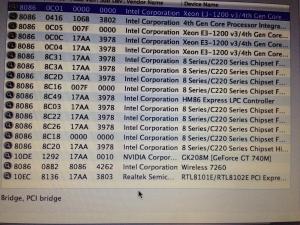

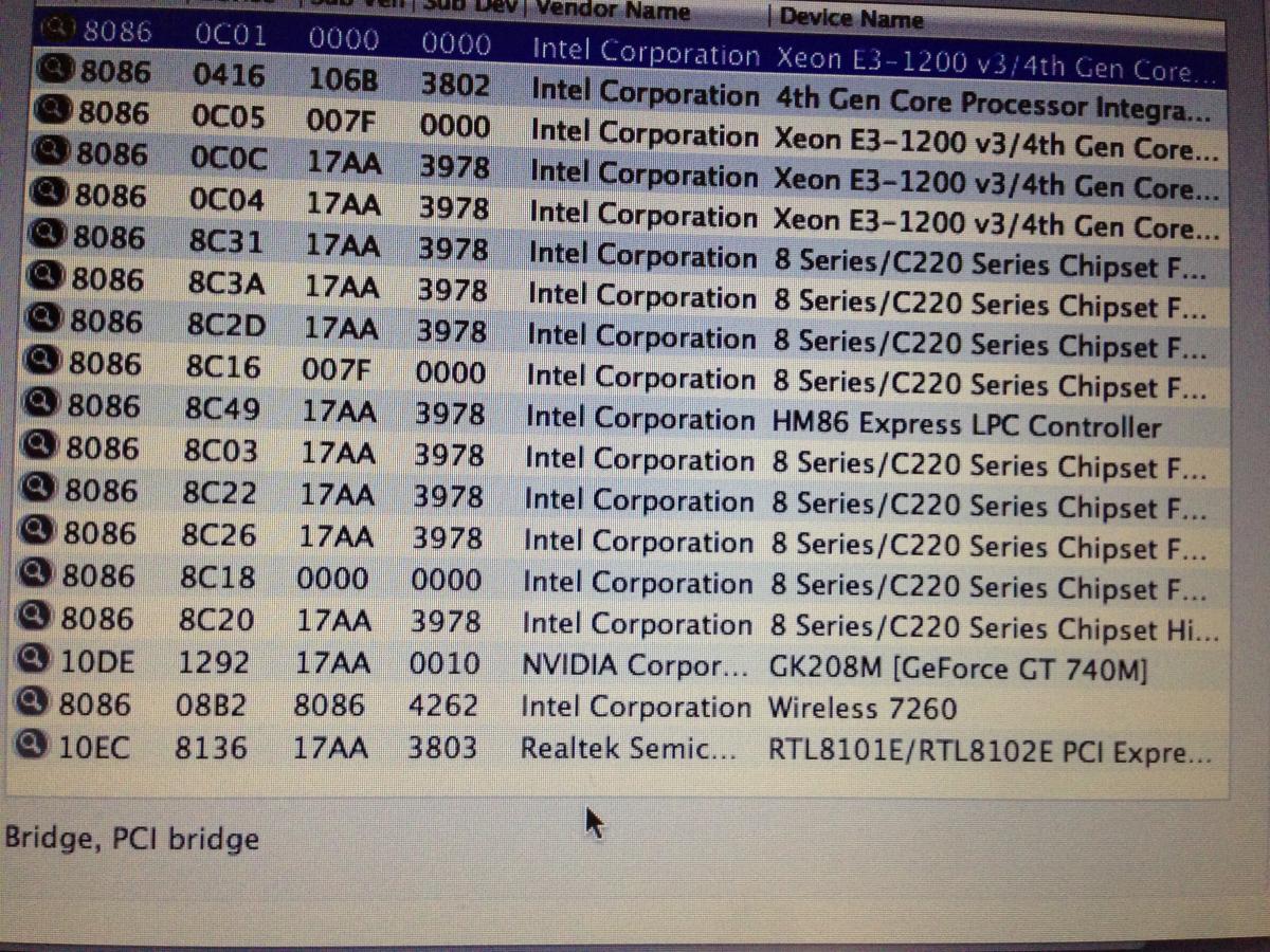

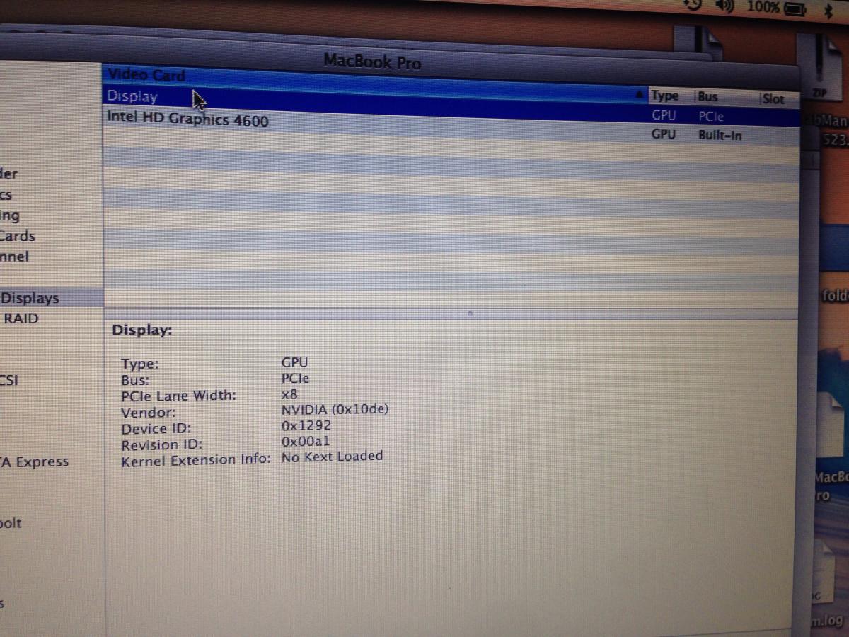

NVIDIA CHIP is still in system report :/
Post ioreg.

I used the alternate way
It looks like this instead of NVIDIA CHIP does it mean it is turned off now ?
