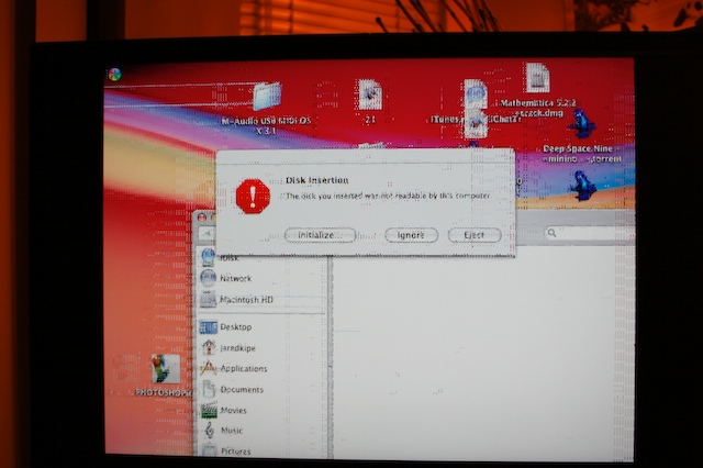

Jared Kipe Posted October 10, 2006 Share Posted October 10, 2006 So last night I built my second OSx86 box (to replace my dual G5) and I'm using the following hardware. Core 2 Duo 2.4GHz Asus P5W DH Deluxe Asus EAX1600XT Silent, with TV out OCZ 2x1GB DDR2-800 Before the install I got the following, Myz 10.4.6 install DVD, JaS 10.4.7 update, JaS 10.4.8 update, and the Boris script installer (the new one that says it has 10.4.8 drivers) So installation went without a hitch, I had it transfer my files off my G5. Then I did the updates/patches in the order I have them listed. Everything was fine till rebooting after the boris patch. Now every time I boot up I get this. Booted off install DVD and repaired permissions. (for some reason diskutil wasn't working upon single user boot off HDD) I have a suspicion I either didn't do the ordering right, or I need the JaS 10.4.6 DVD (downloading, but slow). Or I have one of the weird x1600 silents. I'll have some more questions later, I'm sure. But its 5AM, and I need some damn sleep. Thank you all. EDIT: Oh and that stupid popup isn't what I'm talking about, it is referring to some kind of "disk" diskutility sees, I believe it has to do with the mobo's RAID stuff, which I have off. My problem is the torn graphics and it locks up shortly after getting to the desktop. Link to comment Share on other sites More sharing options...

Jared Kipe Posted October 11, 2006 Author Share Posted October 11, 2006 Well actually, I'm not looking to remove it. I went back through and did the modification by hand and achieved the same result. I'll be reinstalling my mac os tonight and not updating all the way to 10.4.8 before I try the boris patch. But I need QE and CI as I do lots of aperture stuff and I like my games. I ordered a new card from newegg.com, and I'll have it to try by the end of the week if I cannot get this one up and running. Also, has anyone with this board noticed that when it shuts down (it never "restarts") I sometimes have to give it a few seconds before I turn it back on, otherwise it kinda comes on but the screen doesn't then it turns itself off again. So anyone with this motherboard want to share some BIOS tuning tips? Link to comment Share on other sites More sharing options...

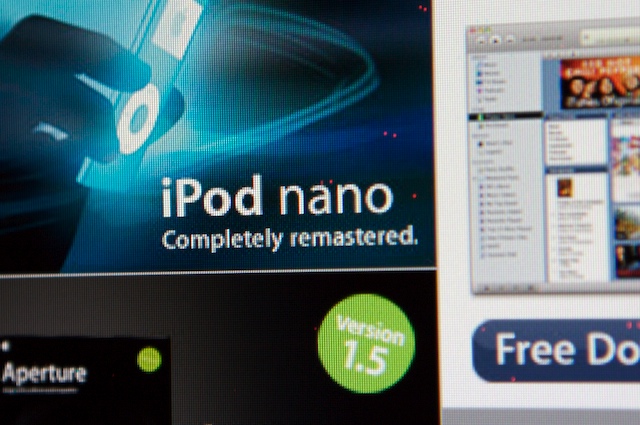

Jared Kipe Posted October 13, 2006 Author Share Posted October 13, 2006 DVI is working, but I see graphical errors in dark tones, or when I move windows around fast. If I cannot get this fixed, its back to newegg. If these errors are inheirent, as I'll try various meathods of applying the ati patches over the weekend. I'll have to tough it out with my G5. Link to comment Share on other sites More sharing options...

Jared Kipe Posted October 13, 2006 Author Share Posted October 13, 2006 Don't bother, applying the patch by hand "not using the script" fixed the problem. That and or using your dvd install (which technically gives me more problems than the Myzar, I get hung at "waiting for root device" quite a bit). But I'm happy for now. I'll start installing my important apps and see what happens. Oh and no more OpenGL crash in xbench. I get more than 33% than my dual 1.8ghz G5 with radeon 9800 pro. This is before overclock. I plan on overclocking a bit once my better CPU cooler arives. Now to get audio (I had it before reinstall) and sleep enabled. Link to comment Share on other sites More sharing options...
Jared Kipe Posted October 13, 2006 Author Share Posted October 13, 2006 Well I went back to myz 10.4.6 install DVD as the JaS one's boot loader doesn't work as well and has around 50% probability of hanging on "waiting for root device". And for some reason I couldn't get audio to work. That said, I've got my small graphical glitches back. Though I've gotta say I'm not 100% sure I ever got rid of them completely. I started to think they were only within safari, but I got aperture installed and saw them there too. Aperture is faster than on my G5, but it will only allow me to have 2 zoomed up, where my G5 allowed 4. Which is a problem for me in how I use Aperture. Link to comment Share on other sites More sharing options...
Jared Kipe Posted October 15, 2006 Author Share Posted October 15, 2006 It seems my problems were actually temperature based. Here is a link to my troubles. http://forum.insanelymac.com/index.php?showtopic=30299 So can anyone be so kind as to try fan cooling their EAX1600XT Silent, to see if there are graphical glitches, please help a guy out. I'm going out of my mind with so many OSX reinstalls. Link to comment Share on other sites More sharing options...
