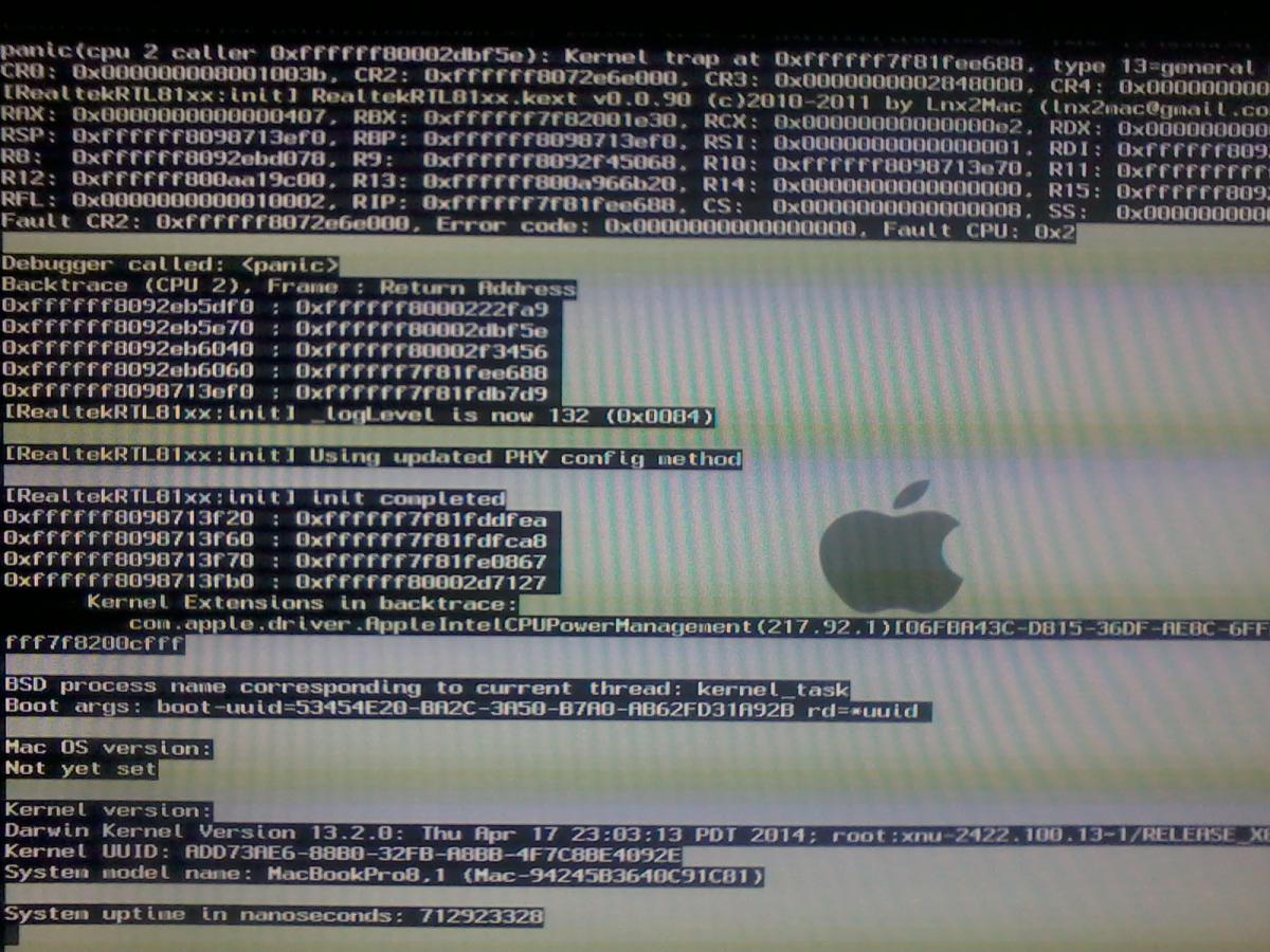

johnniewolker Posted May 16, 2014 Share Posted May 16, 2014 Hello guys. Today i update my hackintosh system from 10.9.2 to 10.9.3 and i've got kernel panic sad.png (AppleIntelCpuPowerManagement) My system is Asus x53s: i3 2310m gt520m/intel HD3000 4gb ram 1333mhz hdd 500gb 5400rpm Using HDMI Any idea how to fix this? Link to comment https://www.insanelymac.com/forum/topic/298073-kernel-panic-with-1093-update-appleintelcpupowermanagement/ Share on other sites More sharing options...
hooda Posted May 16, 2014 Share Posted May 16, 2014 when you experienced this error. its little bit hard, if you already dualboot with windows, try acces your osx drive partition. but install apps to read and write for HFS+ partition like Paragon HFS+ or MediaFour. and place NullCPUPowerManagement.kext inside /S/L/E. after that, try reboot and dont use kernelcache. so you must use -f option to ignore kernelcache when boot in to osx. When its all fine, you can find and download any AICPM kext patch or patcher, and remove NullCPUPowerManagement.kext after apply patch. 1 Link to comment https://www.insanelymac.com/forum/topic/298073-kernel-panic-with-1093-update-appleintelcpupowermanagement/#findComment-2019967 Share on other sites More sharing options...
johnniewolker Posted May 17, 2014 Author Share Posted May 17, 2014 Thank you so much eʍwe i fix the problem. Thanks again Link to comment https://www.insanelymac.com/forum/topic/298073-kernel-panic-with-1093-update-appleintelcpupowermanagement/#findComment-2020193 Share on other sites More sharing options...
