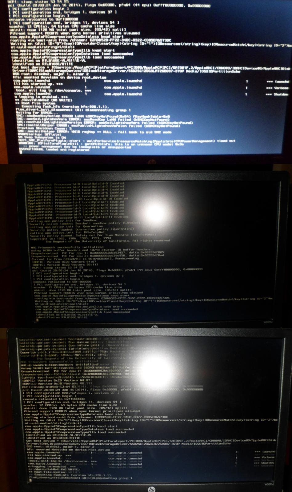

macattackjack Posted April 22, 2014 Share Posted April 22, 2014 Hi, I had the same problems as you did with my install. I used the install tutorial from the main forum page here. I ran across the same hang up, but once I added the same boot flags as you, it solved the os install problems. My setup MSX79MA-GD45 i7-4930k 16 GB ram evga 620 gpu 120 gb pny ssd (for now) Are you using the voodooTCSync.kext? Also, did you get the patched AppleIntelCPUPowerManagement from the iHack install or somewhere else? My first attempt I was getting stuck there as well. The second [iOBluetoothHCIController][protectedBluetoothHCIControllerTransportShowUp] flow divert kctl disconnect (0): disconnecting group 1”. The issue I'm getting now is that I'm getting unsyncronized TCS errors on startup. I'm not overclocking. In my bios, the cpu setting are showing different turboboost limits, and I'm wondering if there's some setting in the bios that's causing the problem. 10.8.4 on the exact same computer does not show this error. While my board is different, there may be some similar setting in the bios to yours. There's very little about this error on the forum or on the net in general. Also, where did you get the trim for ssd from? I found one here http://www.mactrast.com/2013/11/enable-trim-ssds-os-x-mavericks/ Any thoughts appreciated. My setup Link to comment https://www.insanelymac.com/forum/topic/297377-asus-sabertooth-x79-i7-4930k-64gb-1600mhz-memory-dual-boot-win7mavericks/#findComment-2014486 Share on other sites More sharing options...
insideTheFlux Posted April 22, 2014 Author Share Posted April 22, 2014 I do actually use the voodoo kext provided in the DMG pack. The appleintelcpumanagement is used from the myhack application.The trim application is installed from the pandora app.You might want to bring rampagedev into this either via this forum or his wordpress site @ rampagedev.wordpress.comA screenshot of the issue might be helpful too. Link to comment https://www.insanelymac.com/forum/topic/297377-asus-sabertooth-x79-i7-4930k-64gb-1600mhz-memory-dual-boot-win7mavericks/#findComment-2014519 Share on other sites More sharing options...

insideTheFlux Posted April 24, 2014 Author Share Posted April 24, 2014 Yes I actually edited my posts above to correct my error in saying that I did not use voodoo kext. It's like time traveling, sort of. Can you please post a screenshot for all to see the error? "cpus=1 npci=0x2000 UseKernelCache=No PCIRootUID=1?" "Use the boot flag "CPUS=1", that should help get you past the initial boot problems. You may still need to set other boot flags like PCIRootUID= 1 or 0 and npci=0x2000 or 0x3000." By the way, I have "Sync all Cores" option online in my bios. It is @42 for 4.2GHz OC. Perhaps unsynchronized TSC errors is the result of not having synced cores? Try this. -x -v cpus=1 npci=0x2000 Link to comment https://www.insanelymac.com/forum/topic/297377-asus-sabertooth-x79-i7-4930k-64gb-1600mhz-memory-dual-boot-win7mavericks/#findComment-2014827 Share on other sites More sharing options...
Pike R. Alpha Posted April 24, 2014 Share Posted April 24, 2014 About the TSC problem, it may be the kernel (unsupported CPU family) so what do you get when you run this terminal command: sysctl hw.cpufamily If it is any of the following than that is fine: CPUFAMILY_INTEL_NEHALEM 1801080018 CPUFAMILY_INTEL_WESTMERE 1463508716 CPUFAMILY_INTEL_SANDYBRIDGE 1418770316 CPUFAMILY_INTEL_IVYBRIDGE 526772277 CPUFAMILY_INTEL_HASWELL 280134364 Link to comment https://www.insanelymac.com/forum/topic/297377-asus-sabertooth-x79-i7-4930k-64gb-1600mhz-memory-dual-boot-win7mavericks/#findComment-2014836 Share on other sites More sharing options...
macattackjack Posted April 24, 2014 Share Posted April 24, 2014 By the way, I have "Sync all Cores" option online in my bios. It is @42 for 4.2GHz OC. Perhaps unsynchronized TSC errors is the result of not having synced cores Hi Flux My second install is a working install. I tried your install method on my third try to see if I got the same errors and I did. I will post a screen shot later. I was using the kernel flags you've suggested during install, but in the end need to get it to work without cpus=1. In the working system, I use graphicsenabler=no, usekernalcache=no, and npci=0x3000 IGPEnabler=yes. The MSI board does not as far as I can see have a sync all cores feature, but then I'm not overclocking it, so perhaps if I turn overclocking on, it will give me that option and that will solve the unsynchronized TCS errors. I am pretty sure at this point it's a bios issue. I have another MSI X79A-45 (the regular version not the mini atx) with two bios and a switch to go back and forth. That MB has a i7 3820, and when I put it on bios 7735 v1.6 (before the ivy bridge-e's came out) using the 3820 cpu, there are no unsynchronized TCS errors, and no unrecognized cpu error. With the newer version of the bios 7735v2.7, using the 3820 cpu there are errors unsynchronized TCS errors, but no unrecognized cpu error. The board will not even start up with the i7-4930 without 7735v2.3 or later bios Pike I ran the command and for the i7-4930k it returns 526772277 So in other words ( and here's the bottom line) If I can eliminate the unsynchronized TCS errors, even if I get the unrecognized cpu error, the install is okay then? Link to comment https://www.insanelymac.com/forum/topic/297377-asus-sabertooth-x79-i7-4930k-64gb-1600mhz-memory-dual-boot-win7mavericks/#findComment-2014989 Share on other sites More sharing options...
insideTheFlux Posted April 24, 2014 Author Share Posted April 24, 2014 Well you use cpus=1 until you can install the necessary .kexts, SSDT file, Extra folder. Then booting is just straight forward without any parameters to parse. Perhaps you should really check out rampagedev's site and ask questions there. I started this thread so it could assist with the bumps that one runs into while installing on X79 platform. Whenever you can get that screenshot would be good, maybe someone will be able to chime in on the issue. http://rampagedev.wordpress.com/dsdt-downloads/msi-x79/ Link to comment https://www.insanelymac.com/forum/topic/297377-asus-sabertooth-x79-i7-4930k-64gb-1600mhz-memory-dual-boot-win7mavericks/#findComment-2015003 Share on other sites More sharing options...
macattackjack Posted April 25, 2014 Share Posted April 25, 2014 Hi, I'm sorry I wasn't clear The install is complete except for sound (which I will be using a PCI-E card, so not an issue) I'm booting with all 12 threads running. I did another install on another drive using your method just to see if I got the same unsynchronized TCS errors, which I did. The reason for this was to eliminate the kexts as the issue, which I think I have. The fact that one bios, with the 3820 doesn't show them, while the more updated bios with the 4930k or the 3820 does show them leads me to look at the bios settings now. Link to comment https://www.insanelymac.com/forum/topic/297377-asus-sabertooth-x79-i7-4930k-64gb-1600mhz-memory-dual-boot-win7mavericks/#findComment-2015054 Share on other sites More sharing options...

macattackjack Posted April 25, 2014 Share Posted April 25, 2014 I almost think you should have gone with an/a asus/gigabyte mobo because they seem to be the most compatible I was thinking the same thing.... lol. I was using Asus, but then did a Mac OS install of 10.6.4 with a Rampage Gene III, and was getting weird cpu spikes with my main application, that made it useless. I forget when or why, but I found the MSI board and and it worked, so I started using them. Anyways, here are the screen shots of the boot. smc is giving weird errors as well as the others I've described. Thanks. Link to comment https://www.insanelymac.com/forum/topic/297377-asus-sabertooth-x79-i7-4930k-64gb-1600mhz-memory-dual-boot-win7mavericks/#findComment-2015219 Share on other sites More sharing options...
