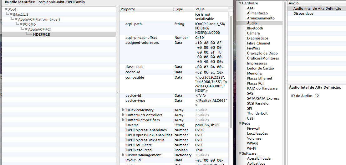

thiagomorales Posted March 12, 2014 Share Posted March 12, 2014 Hi fellows. First all, since from Mountain Lion i have been patching AppleHDA in this computer (that uses ALC662 Rev1 codec - 0x10EC0662) without problems. Until 10.9.1 i was injecting LayoutID = 12 in DSDT, then using my PathMaps (Platforms), my Layout12.xml and my corrected verbs (Info.plist), everything was fine. With 10.9.2 release, i have patched the new AppleHDA as "normal" way. But it unexpectedly not worked. I have double checked everything... I got an 'clean' AppleHDA and did all changes again, step by step.. Tried to change LayoutID to 1 (on both DSDT and files, of course).. Can't get it to work. Tried to rollback to 2.5.3 version (working in 10.9.1), and for my surprise... Didn't worked. I have only AppleACPIPlatform.kext (with vanilla i get stuck at boot) and AMDRadeonX3000.kext (for QE on ATI 5430 mobility) patched in my install. But these kexts have been patched since Mountain Lion.. So i guess that it's not causing this trouble. Well, i have no idea what Apple changed in this release, that broken my sound. Recently, i have updated to 10.9.3 to try with new kexts, but the version of AppleHDA is the same... Same results on tests. Anyone has an idea? Thanks in advance. Ps: I have bin patched with bcc9 script (patch-hda - last version) Ps2: In System Information and Sound settings i get NO DEVICES. Ps3: HDEF infos are injected as well. (DSDT) - See IOREG attached. Link to comment https://www.insanelymac.com/forum/topic/296768-applehda-260f1-broken-alc662-rev1/ Share on other sites More sharing options...

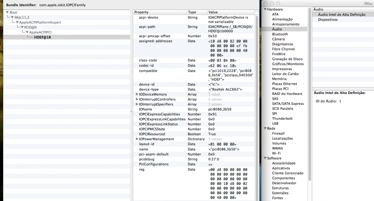

toleda Posted March 12, 2014 Share Posted March 12, 2014 IOREG attached. 10.9.2 AppleHDA binary changed, however, all edits are the same as 10.9 and 10.9.1. No IOReg/HDEF/pin configs; the kext was installed improperly or layout/CodecID and/or Info.plist/ConfigData are wrong. Link to comment https://www.insanelymac.com/forum/topic/296768-applehda-260f1-broken-alc662-rev1/#findComment-2003461 Share on other sites More sharing options...

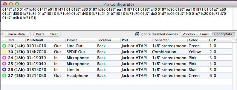

thiagomorales Posted March 12, 2014 Author Share Posted March 12, 2014 Thanks for reply @toleda. Well, i was using the same edits from 10.9.1 and it was worked in this version. (Pinconfigs in DSDT 'always' was 'zero'), In 10.9.1 (working version with AppleHDA 2.5.3) i was using layoutID = 12 and CodecID = 283.903.586 (0x10EC0662 hex), the verbs (ConfigData) was corrected using the svg from codecgraph and verbit, and 'checked' using 'PinConfigurator.app'. The ConfigData/LayoutID/PathMaps are the same that was used in 10.9.1 (working version). I guess that is a problem with binpatch. I saw that ALC662 have been patched using ALC885 address.. I will try to patch with another codec address manually in hex editor... Have any idea? Thanks. Regards. Link to comment https://www.insanelymac.com/forum/topic/296768-applehda-260f1-broken-alc662-rev1/#findComment-2003478 Share on other sites More sharing options...
toleda Posted March 13, 2014 Share Posted March 13, 2014 Well, i was using the same edits from 10.9.1 and it was worked in this version. (Pinconfigs in DSDT 'always' was 'zero'), In 10.9.1 (working version with AppleHDA 2.5.3) i was using layoutID = 12 and CodecID = 283.903.586 (0x10EC0662 hex), the verbs (ConfigData) was corrected using the svg from codecgraph and verbit, and 'checked' using 'PinConfigurator.app'. Looking in the wrong places. dsdt/pinconfigs aren't the problem. The IOReg shows layout-id 1. info.plist/,,/ConfigData must have layout 1 for the correct codec and layout1 must have the same codec. Correct pinconfigs show regardless of the bin patch. Incorrect pinconfigs and correct patch will fail. Verify pinconfigs first. Link to comment https://www.insanelymac.com/forum/topic/296768-applehda-260f1-broken-alc662-rev1/#findComment-2003546 Share on other sites More sharing options...

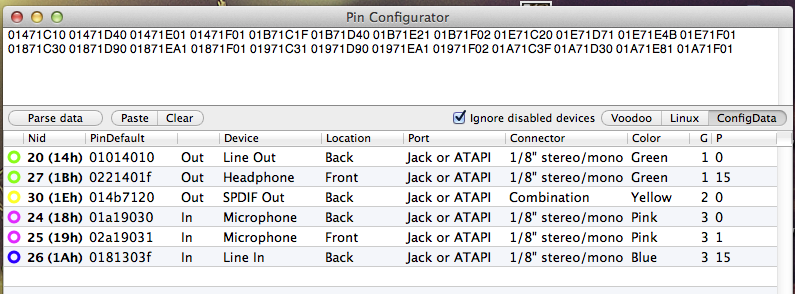

thiagomorales Posted March 13, 2014 Author Share Posted March 13, 2014 Something is very strange.. I have double checked my pinconfig. (Same used earlier 10.8.5-10.9.1, corrected by verbit) I already have tested with another codecdata (from AppleHDA 10.9.2 patched to ALC662 - from osx86.net).. Not works too, shows none in System Profiler. I reverted to layoutID 12 to test.. Same results. I'm attaching verbit. Another idea? Thanks. verbs.txt Link to comment https://www.insanelymac.com/forum/topic/296768-applehda-260f1-broken-alc662-rev1/#findComment-2003721 Share on other sites More sharing options...
toleda Posted March 14, 2014 Share Posted March 14, 2014 Another idea? I agree. No edits required to pin configs for 10.9.2. Have you installed the working 10.9.1 AppleHDA.kext in 10.9.2? Link to comment https://www.insanelymac.com/forum/topic/296768-applehda-260f1-broken-alc662-rev1/#findComment-2004093 Share on other sites More sharing options...
