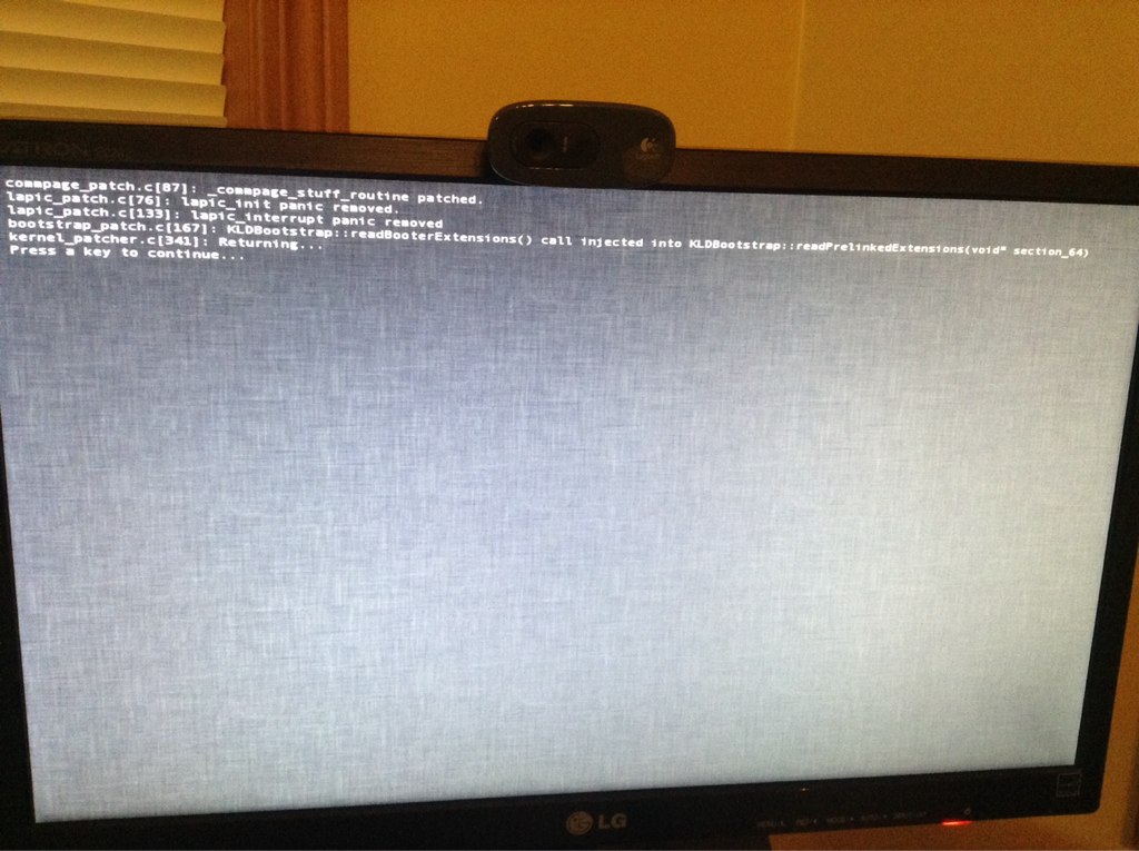

bsancken Posted February 28, 2014 Author Share Posted February 28, 2014 What is the Exact ASUS model ?? you can try this Extra folder to put on the usb drive just flag -v This is what I get when I try your extra folder... Forgotten o mention it sits there after a key is pressed for several seconds then it reboots.. Link to comment https://www.insanelymac.com/forum/topic/296372-mavericks-install-on-asus-z77-mb-help-w-troubleshooting/#findComment-1998247 Share on other sites More sharing options...

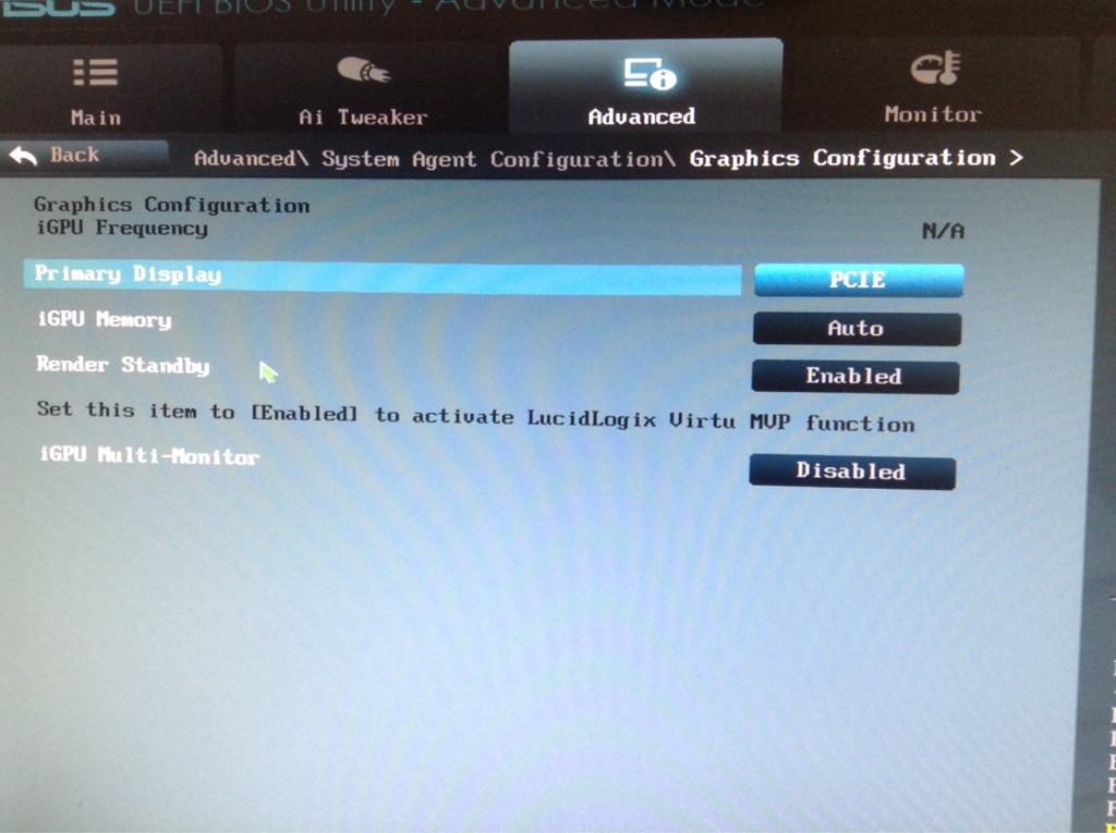

Gringo Vermelho Posted February 28, 2014 Share Posted February 28, 2014 Photo above: Remove the kernel patcher module from /Extra/Modules. BIOS Photo: Deactivate "render standby" in the BIOS as well....the other settings are correct. Asus Z77 boards have locked MSR 0xE2 register which causes AppleIntelCPUPowermanagement.kext to kernel panic on boot, to boot OS X you'll need to either unlock it, patch it or block CPU powermanagement entirely using one of these methods: - patching your BIOS with pmpatch (this is the best solution but flashing a patched BIOS can be difficult) - patching AppleIntelCPUPowermanagement.kext (second best solution) - using NullCPUPM.kext (blocks AppleIntelCPUPowermanagement.kext from loading at all, the easiest way but you lose OS controlled CPU powermanagement) Even though it says "UEFI" everywhere you read about this, it also applies if you're booting in non-UEFI mode. In order to load kernel extensions from /Extra/Extensions (such as NullCPUPM) you must set UseKernelCache=n in /Extra/org.chameleon.Boot.plist. /Extra/Extensions will be ignored if you don't. If I were you I'd remove the ATI video card until you're able to boot and everything is working. This will make it a lot easier to troubleshoot/isolate issues specific to the ATI card later. Link to comment https://www.insanelymac.com/forum/topic/296372-mavericks-install-on-asus-z77-mb-help-w-troubleshooting/#findComment-1998253 Share on other sites More sharing options...

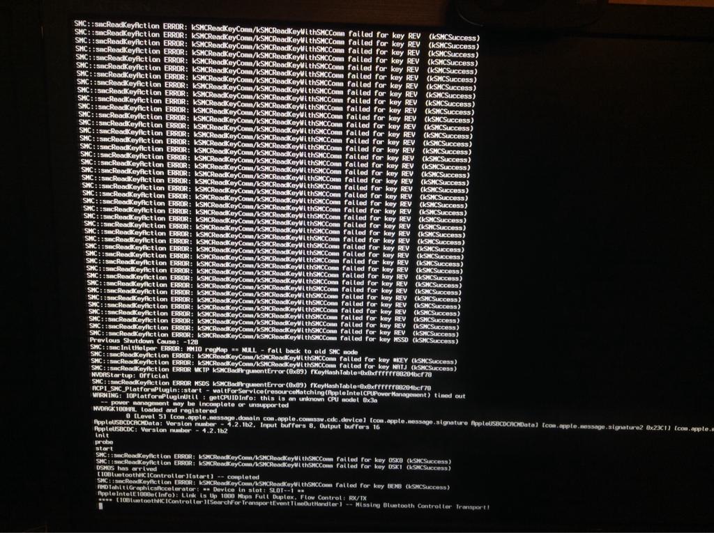

bsancken Posted March 1, 2014 Author Share Posted March 1, 2014 Ok I patched the AICPM kept and now when I boot it sits at a whit screen and then goes here and waits.. Link to comment https://www.insanelymac.com/forum/topic/296372-mavericks-install-on-asus-z77-mb-help-w-troubleshooting/#findComment-1998684 Share on other sites More sharing options...
Gringo Vermelho Posted March 1, 2014 Share Posted March 1, 2014 This is right before you should be seeing the desktop. It's done booting. I wonder what's causing all those SMC errors, obviously you have FakeSMC.kext loaded because it says "DSMOS has arrived" at the bottom. Two people have independently suggested that you remove one of the video cards until you can get it to boot. Yet both of them are clearly still plugged in. Link to comment https://www.insanelymac.com/forum/topic/296372-mavericks-install-on-asus-z77-mb-help-w-troubleshooting/#findComment-1998695 Share on other sites More sharing options...
