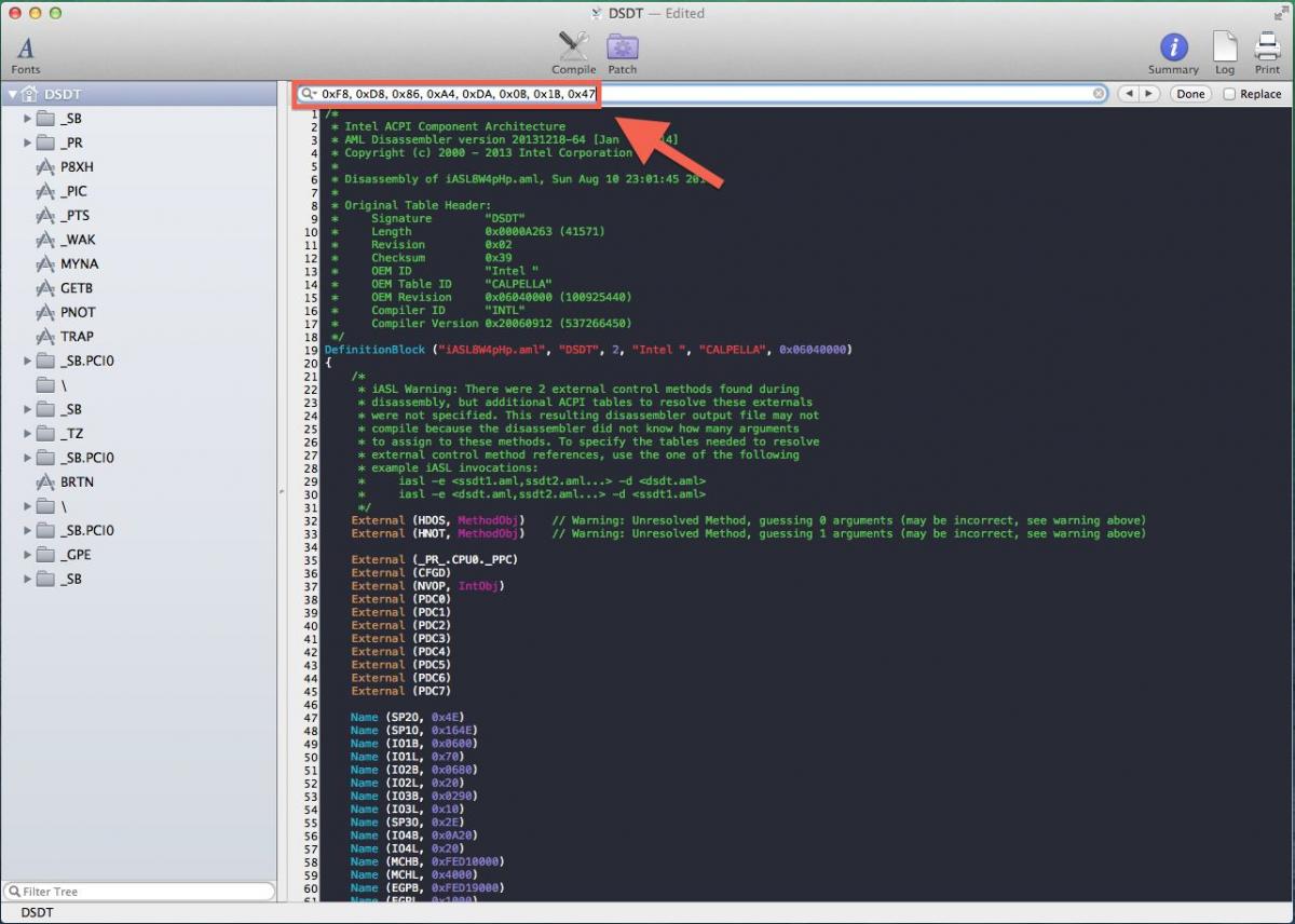

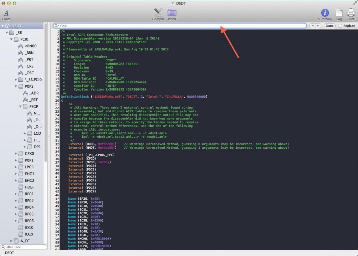

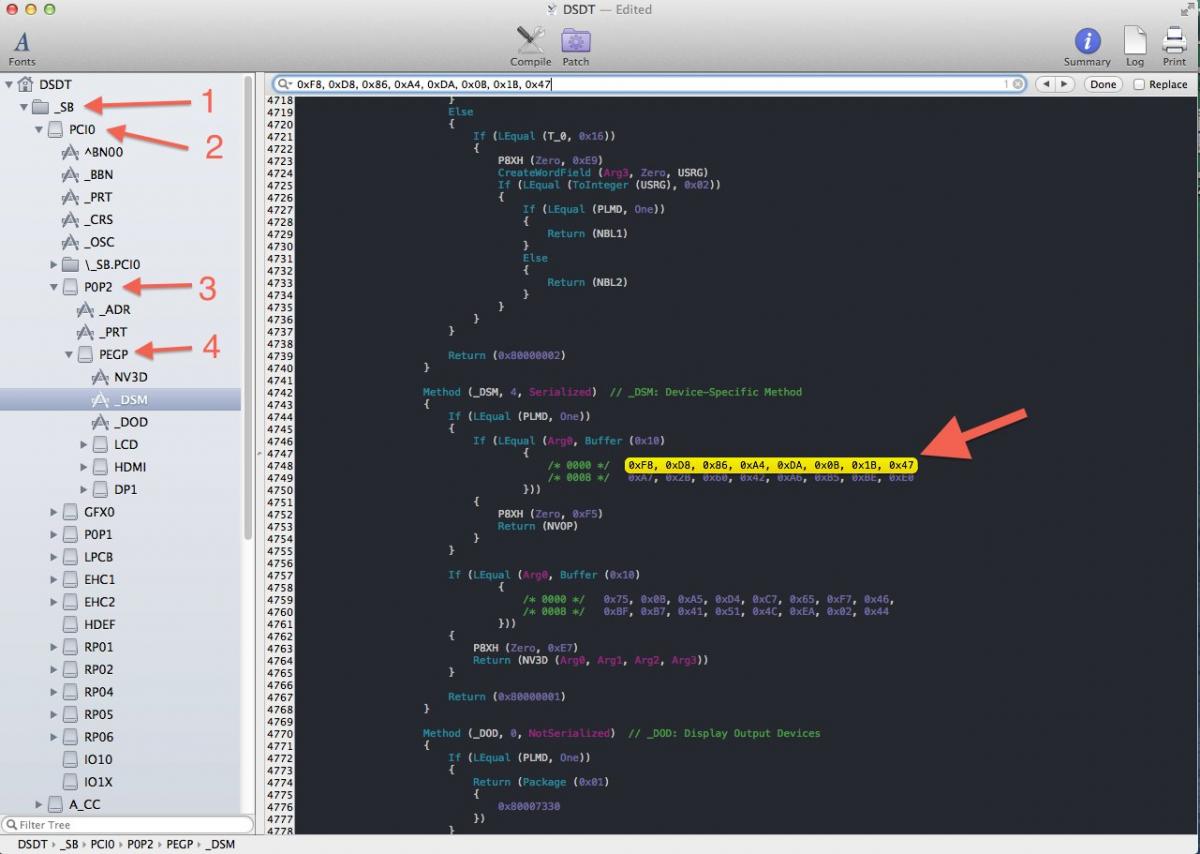

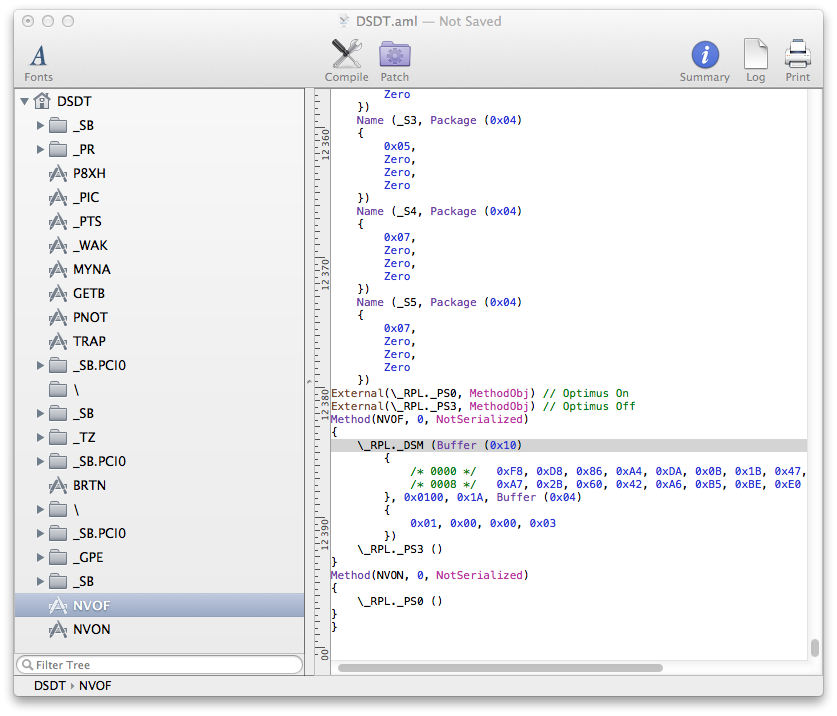

tuxuser Posted August 13, 2014 Share Posted August 13, 2014 You can find RPL in the patch tho... You have to replace RPL with your devicestring either before patching or after that. you can find the correct devicestring by searching for 0xF8, 0xD8, 0x86, 0xA4, 0xDA, 0x0B, 0x1B, 0x47 in your DSDT and SSDTs Here some pictures to clarify: In this case the devicestring is: SB.PCI0.PEGP.P0P2 So you replace "External(\_RPL._PS0, MethodObj)" --> "External(\_SB.PCI0.PEGP.P0P2._PS0, MethodObj)" You have to do that for all the entries in the patch, that contain RPL Hope that clears it up a little! BTW: I use Clover, no special patching needed.. except PatchVBios for the Intel card. Link to comment https://www.insanelymac.com/forum/topic/295584-disabling-nvidia-optimus-card-on-all-laptops/page/9/#findComment-2051265 Share on other sites More sharing options...
