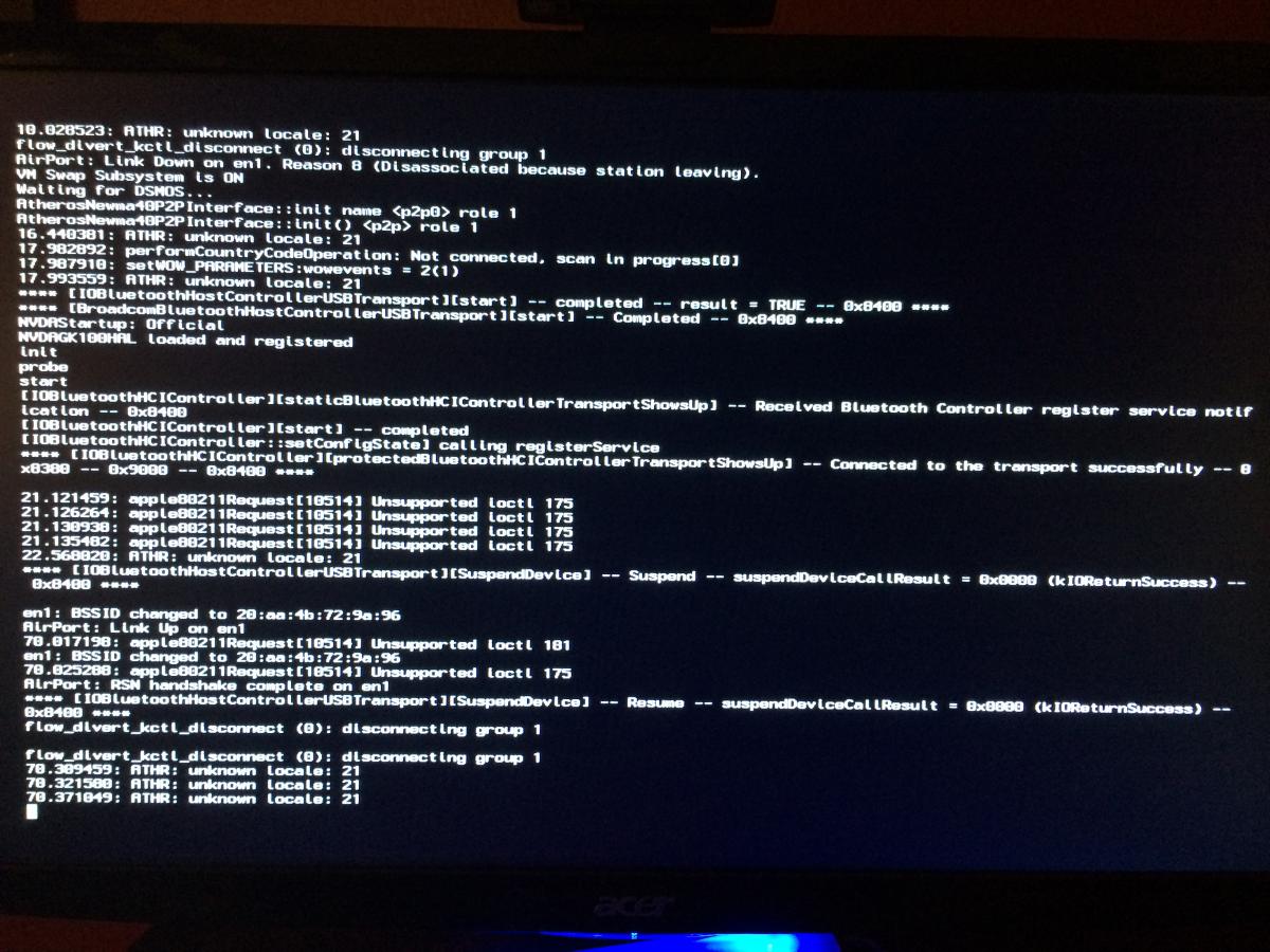

dam718 Posted January 21, 2014 Share Posted January 21, 2014 Howdy guys, having issues booting into my system with Chameleon loaded on my HDD It stalls every time... Works great with no flags booting from USB loader... Photo where stalled attached System Specs: Asrock Fatal1ty Z77 Professional Intel Core i7-3770K EVGA GTX-680 Signature Here is my org.chameleon.Boot.plist contents: <?xml version="1.0" encoding="UTF-8"?> <!DOCTYPE plist PUBLIC "-//Apple//DTD PLIST 1.0//EN" "http://www.apple.com/DTDs/PropertyList-1.0.dtd"> <plist version="1.0"> <dict> <key>EthernetBuiltIn</key> <string>Yes</string> <key>GraphicsEnabler</key> <string>Yes</string> <key>Kernel</key> <string>mach_kernel</string> <key>Kernel Flags</key> <string>PCIRootUID=1</string> <key>Timeout</key> <string>5</string> <key>device-properties</key> <string>5700000001000000010000004b0000000100000002010c00d041030a0000000001010600071c0101060000000101060000080101060000007fff0400160000006200750069006c0074002d0069006e0000000500000001</string> </dict> </plist> Link to comment Share on other sites More sharing options...
artur_pt Posted January 21, 2014 Share Posted January 21, 2014 hello only see u must boot with GraphicsEnabler=No and is for what the dev properties ? u have that in usb stick ? good hack Link to comment Share on other sites More sharing options...
dam718 Posted January 21, 2014 Author Share Posted January 21, 2014 The dev properties was needed for en0 to show up as "BuiltIn=True" for App Store / FaceTime / iCloud services. It's for Ethernet The Boot.plist is in my /Extra folder on HDD Link to comment Share on other sites More sharing options...
