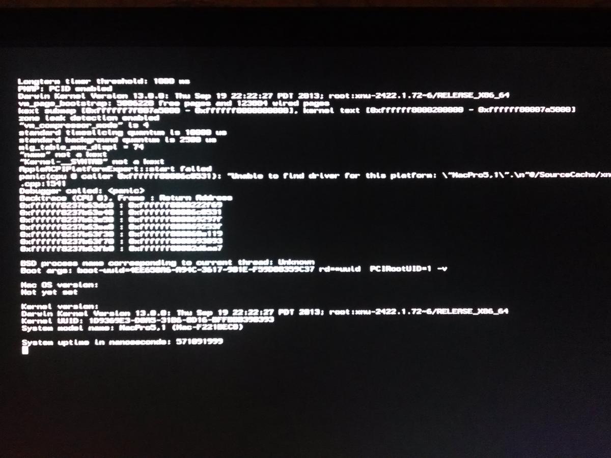

morgrujo Posted January 11, 2014 Share Posted January 11, 2014 Hello, Ok so everybody check out this Kernel panic I am getting>>> I have made a custom boot USB installer for 10.9 which ive already ironed out a few issues on, I am converting my Dual Xeon Evga SR2 to mac finally and am having a system definition problem (panic). any ideas? appleacpiplatformexpert start failed :: "Apple platform expert startup failed, unable to find driver for this platform, system MacPro 5,1 ..."Ive tried changing the smbios.plist file ? and to remove it entirely, then... it just crashes under a mac mini definition 1,1 similarly... Maybe a specific edit? see the picture for details:In the bios its set to one processor etc , no hyper-threading etc etc etc etc , any ideas ? (But it has the EXACT same error if all processors and HT are turned on anyway)I had to make a custom thumbdrive to get it to work, then added some kexts and bootflags on there, maybe i introduced something i shouldnt have? its going to be a rad server when this works! Any thoughts much appreciated ! Chimera 2.2.1 + MAC os 10.9 install DMG added flags for graphics, & other stuff which seemed to work, but now im stuck on this one.-Morg. SEE PIC. (sorry a little blurry) BEST> Link to comment https://www.insanelymac.com/forum/topic/295223-kernel-panic-system-definitions-109-evga-sr2-xeon/ Share on other sites More sharing options...
morgrujo Posted January 11, 2014 Author Share Posted January 11, 2014 For anyone interested: ONTO the next step , Removed : genericUSBHCI , applytymcedriver, applegraphicspowermanagement, appleintelcpupowermanagment Added: 10.8.1 rollback, nullpowermanagement, realtek alc 889, apple rtc cmos patch, 3rd party sata, evoreboot, elliotforcelegacyrtc, kernel cache y, pci root 1, -v, graphics enabler n, 1080p display mode ... more soon! Link to comment https://www.insanelymac.com/forum/topic/295223-kernel-panic-system-definitions-109-evga-sr2-xeon/#findComment-1984142 Share on other sites More sharing options...
divotion Posted January 26, 2014 Share Posted January 26, 2014 Same Problem here. Kernel Panic with sr2 and dual xeon x5650... With one xeon is go. but lower Modell. acpi error CPU KP... I will try your step above. But i have same Problem with 10.8 install stick created by [url="http://www.insanelymac.com/forum/topic/279450-why-insanelymac-does-not-support-tonymacx86/"]#####[/url]... Link to comment https://www.insanelymac.com/forum/topic/295223-kernel-panic-system-definitions-109-evga-sr2-xeon/#findComment-1988885 Share on other sites More sharing options...
