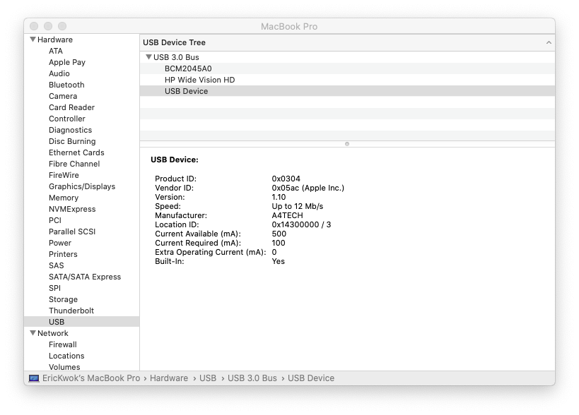

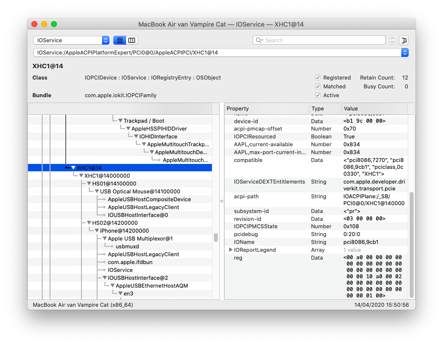

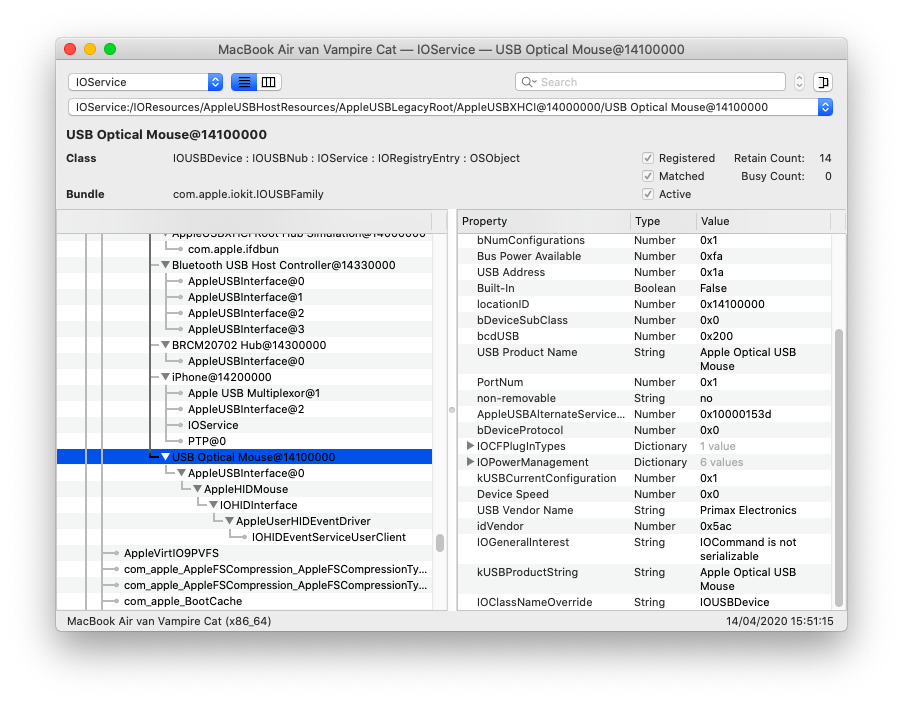

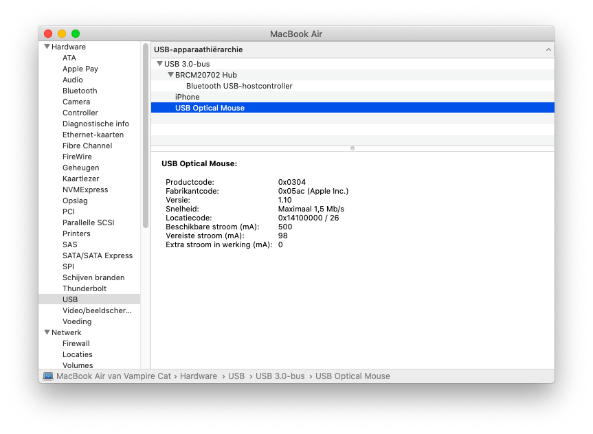

I've updated AnyAppleUSBMouse for Catalina.
It requires 4 changes to the idProduct (Product ID) and idVendor (Vendor ID) to work.
Enjoy :D :cards:

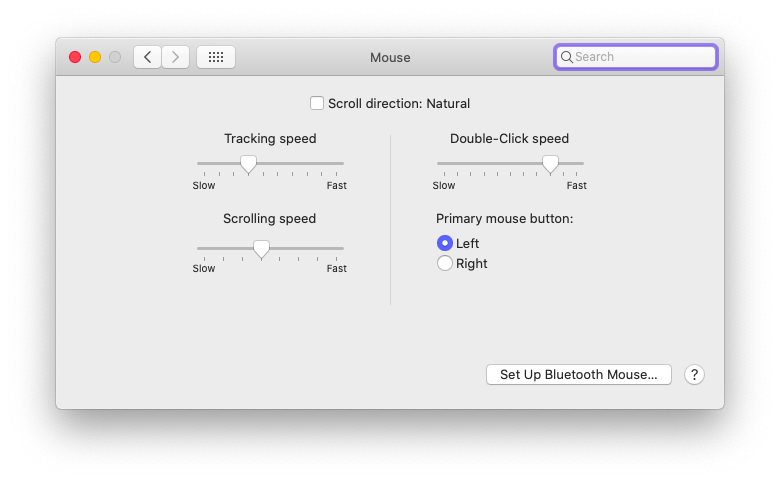

Seems that it doesn't work for me. Am I place my Product ID and Vendor ID in the right place?
My Product ID is 1359 in decimal and my Vendor ID is 2522. So I place them into
IOKitPersonalities
├── Fake_Apple_Mouse_Device
│   ├── idProduct
│   └── idVendor
├── Fake_Apple_Mouse_Interface
│   ├── idProduct
│   └── idVendor
├── WiredMouse-any
│   ├── idProduct
│   └── idVendor
└── WiredMouseAccel-any
    ├── idProduct
    └── idVendor
Now in System Report I got Apple Inc. but not in system preference.
Info.plist
