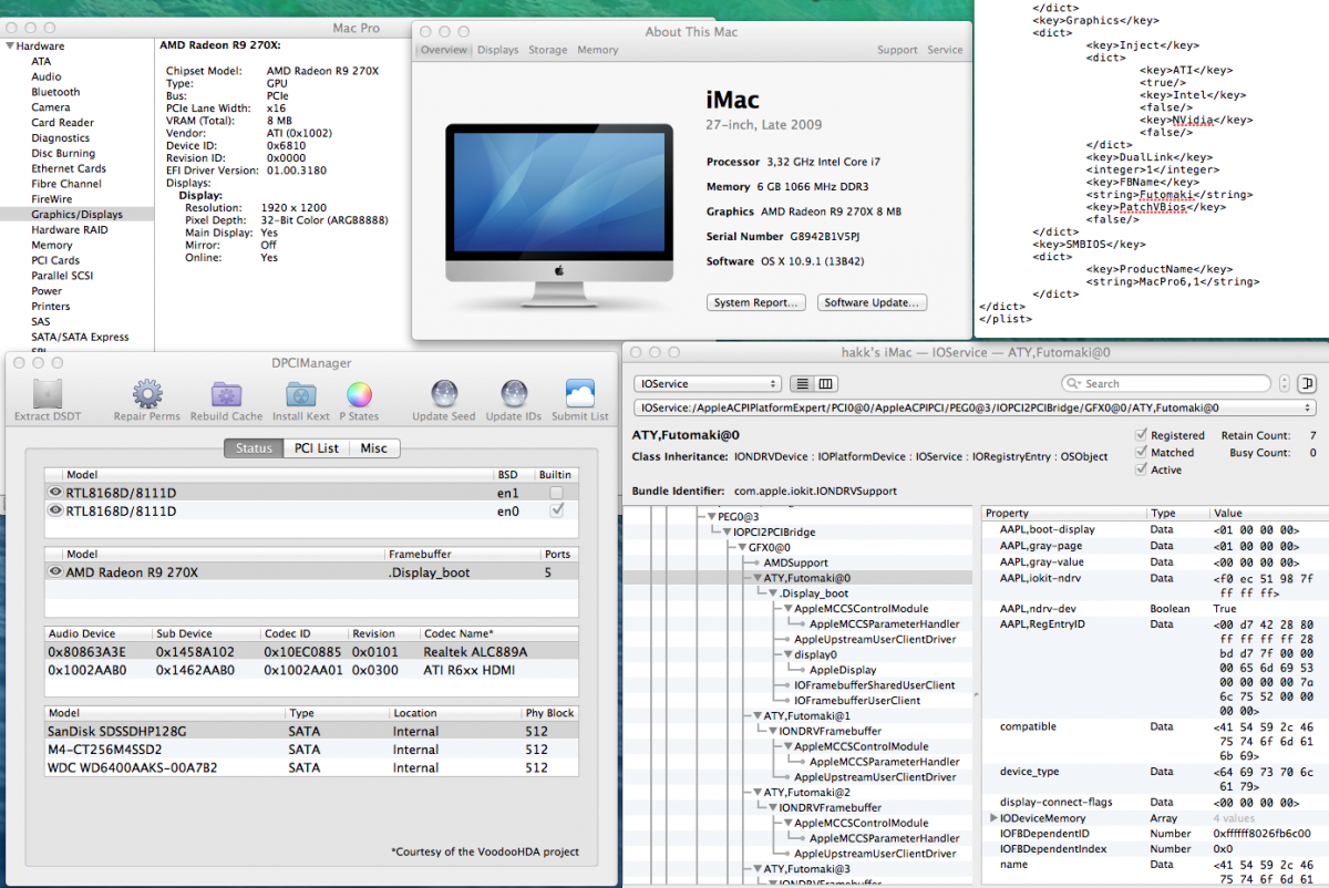

I have tried your method for my MSI 270X. But my problem is now, that only 8MB of my video RAM is recognized! (see attached screenshot)
Do you have any idea what could be the mistake? Thank you!

here's my complete clover config file: (using the newest clover 2636): http://pastebin.com/BapNtnGt
in the boot log it says:
12:361  0:000  ATI card POSTed,
12:361  0:000  Set VRAM for Cedar=2048Mb
12:361  0:000  ATI: get_vram_size returned 0x80000000
12:361  0:000  ATI Radeon EVERGREEN family
12:361  0:000  Users config name Futomaki
12:361  0:000  (AtiPorts) Nr of ports set to: 5
12:361  0:000  ATI Tahiti AMD Radeon R9 270X 2048MB (Futomaki) [1002:6810] (subsys [1462:3030]):: PcieRoot(0x0)\Pci(0x3,0x0)\Pci(0x0,0x0)

I tried following the method here to inject into clover my GIGABYTE R9 270 OC .
But I just get a Graphics card with a total of 8mb of Vram and QE/CI doesn't seem to be active.
Pic
What I did, I inserted my deviced ID into both AMD7000Controller.kext and AMDX4000.kext which is 0x68111002 right under "IOPCIMatch". Then used kext utility to-reinsert the two edited .kext files.
