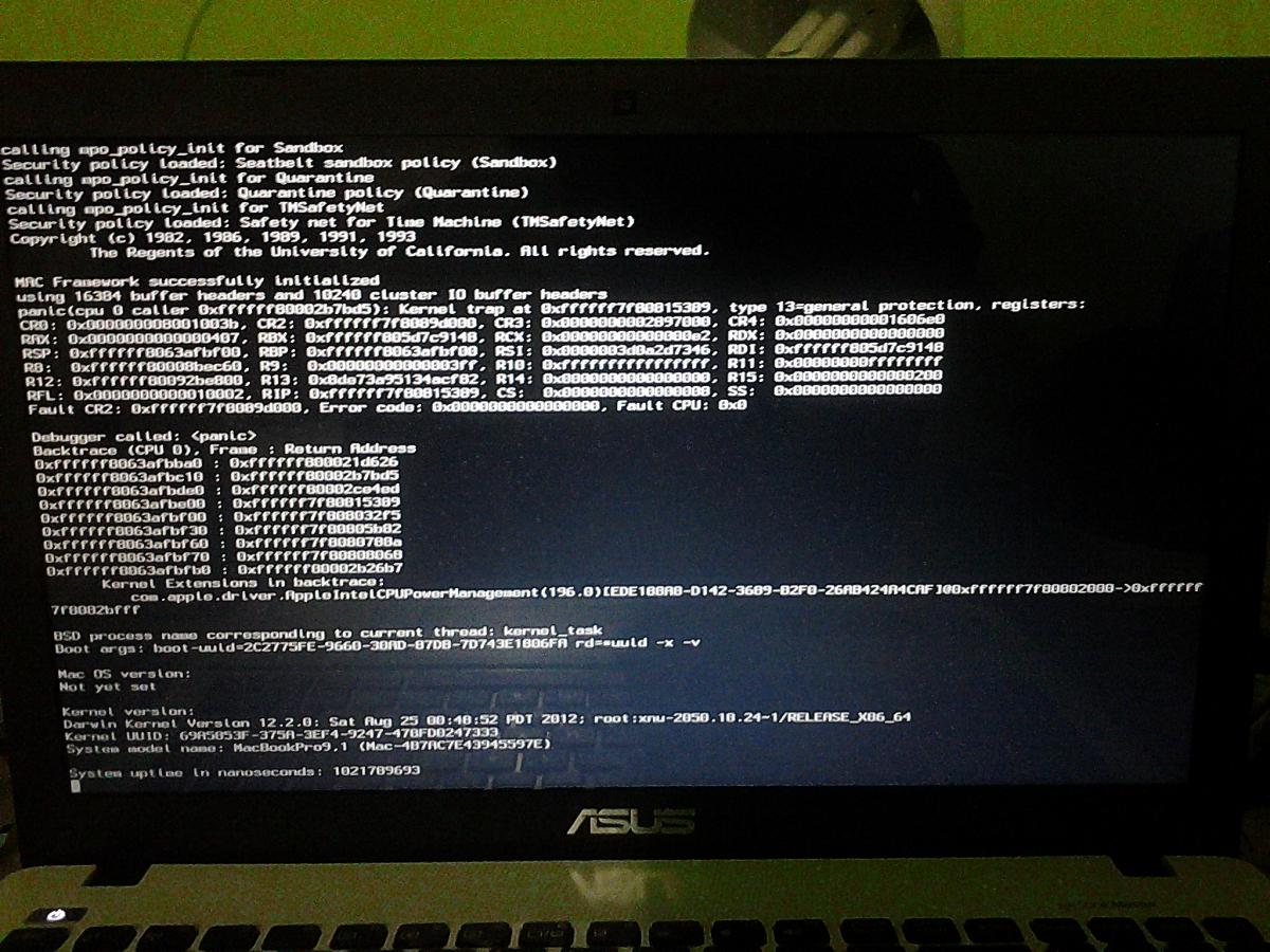

aldhistinct Posted November 13, 2013 Share Posted November 13, 2013 I'm trying to install iAtkos ML2 on my ASUS A550CC or also called X550CC, here's the specs: Intel® Core i5 3337U@1.8Ghz Intel HM76 Express Chipset 4096MB RAM Toshiba MQ01ABD075 750GB hdd Intel HD 4000 NVIDIA GT720M 2GB DDR3 Realtek ALC270 I've got the iAtkos ML2 installed succesfully, i've tried with some of the boot flags like -x -v cpus=1 and such, but it seems like my notebooks is freezing, I'm choosing the ML2 because the ML3U is not an option to me as i don't want to reinstall my windows 8 install with lots of data in it. So i've got the picture, but i can't make sure what's the problem as I new to hackintoshing but it seems like my CPUs aren't detected correctly with problems in power management stuffs and some problems with my NVIDIA card because there's a glimpse of line that iAtkos can't find the type of my NVIDIA card,i've tried with my NVIDIA card enabled but no luck with that,and i've tried to disable it but also no luck with that too, so the screenshot is in the attachment Link to comment https://www.insanelymac.com/forum/topic/293860-asus-a550ccx550cc-iatkos-ml2/ Share on other sites More sharing options...
dcai777 Posted November 13, 2013 Share Posted November 13, 2013 remove appleintelcpupowermanagement.kext. You will have to update to 10.8.5 or 10.9 to get your nvidia graphics working. Link to comment https://www.insanelymac.com/forum/topic/293860-asus-a550ccx550cc-iatkos-ml2/#findComment-1967562 Share on other sites More sharing options...
aldhistinct Posted November 14, 2013 Author Share Posted November 14, 2013 so i had to use usb drive to install? cause i'm currently using the dvd-dl install and just remove and no replace? Link to comment https://www.insanelymac.com/forum/topic/293860-asus-a550ccx550cc-iatkos-ml2/#findComment-1967616 Share on other sites More sharing options...
