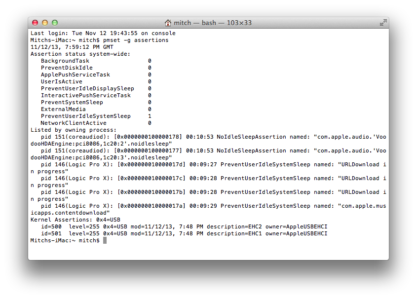

theconnactic Posted November 12, 2013 Share Posted November 12, 2013 Hello, folks! After struggling a lot to get the main things up and running with a Sony Vaio that a borrowed for this month while my 1201n is being fixed, I get at the point almost everything is running like it should. Since it's a 2nd-gen I3 lappie with integrated HD3000, Atheros 9285 and Realtek 8168, I was lucky enough to get everything working without dongles or part replacements (which I couldn't do since the device is not mine). Now I came to the fine-tuning phase, where things like power management matter. I found a patched AICPUPM that let me boot without NCPUPM without a kernel panic, and I generated a SSDT with Pike's script. I didn't measure it, but since the performance is being great since then, I assume speedstep is working fine. However, it won't sleep, and if I put it to sleep manually, the HDD less will keep showing normal activity, as well as the fans, but I won't be able to "wake" the laptop, needing a hard reboot. I just ran the pmset -g assertions command and got this output: Since I'm working with Logic at the moment, I'll ask you to disregard any Logic/Coreaudio related stuff, as they are absolutely normal and have no relation with my system sleep issues. Earlier, when i ran the same command (unfortunately I wasn't sharp-minded enough to remember taking a screenshot at the moment) I got all the assertion status showing as zero (0) but also got the same kernel assertion at the bottom, and I'm pretty sure I got a problem with EHCI. So that's my question: which of the EHCI patches should I apply to my DSDT? EHCI sleep or EHCI ownership (or both)? I'll attach also and IOREG and my current DSDT, just in case anyone want to take a look and see if there's something else harming system sleep that I should have noticed. All the best! Archive.zip Link to comment https://www.insanelymac.com/forum/topic/293835-advice-about-sleep-edits-for-my-laptop/ Share on other sites More sharing options...
iFIRE Posted November 12, 2013 Share Posted November 12, 2013 URL downloading and vodoohda, the EHCI , I have this too, all we have in 10.9, but for me this is my usb bluetooth , keyboard and trackpad Apple, only is bug, not prevent idleslepp Link to comment https://www.insanelymac.com/forum/topic/293835-advice-about-sleep-edits-for-my-laptop/#findComment-1967159 Share on other sites More sharing options...

iFIRE Posted November 13, 2013 Share Posted November 13, 2013 like you can see in this two examples, i kill the : pid 18(powerd): [0x000000110000047c] 00:02:53 InternalPreventDisplaySleep named: "com.apple.powermanagement.delayDisplayOff" and I not have more any process that prevent idllesleep LocalHost:~ iFire$ pmset -g assertions 13/11/13 12:36:59 GMT+1 Assertion status system-wide: BackgroundTask 0 PreventDiskIdle 0 ApplePushServiceTask 0 UserIsActive 1 PreventUserIdleDisplaySleep 0 InteractivePushServiceTask 0 PreventSystemSleep 0 ExternalMedia 0 InternalPreventDisplaySleep 1 PreventUserIdleSystemSleep 0 NetworkClientActive 0 Listed by owning process: pid 18(powerd): [0x000000110000047c] 00:02:53 InternalPreventDisplaySleep named: "com.apple.powermanagement.delayDisplayOff" Timeout will fire in 126 secs Action=TimeoutActionTurnOff pid 50(hidd): [0x0000000a0000028a] 14:26:09 UserIsActive named: "com.apple.iohideventsystem.queue.tickle" Timeout will fire in 580 secs Action=TimeoutActionRelease Kernel Assertions: 0xc=USB,BT-HID id=500 level=255 0x4=USB mod=12/11/13 18:25 description=EHC2 owner=AppleUSBEHCI id=501 level=255 0x4=USB mod=13/11/13 11:11 description=EHC1 owner=AppleUSBEHCI id=513 level=255 0x8=BT-HID mod=01/01/70 01:00 description=com.apple.driver.IOBluetoothHIDDriver owner=AppleBluetoothHIDKeyboard id=514 level=255 0x8=BT-HID mod=01/01/70 01:00 description=com.apple.driver.IOBluetoothHIDDriver owner=BNBTrackpadDevice LocalHost:~ iFire$ pmset -g assertions 13/11/13 12:39:21 GMT+1 Assertion status system-wide: BackgroundTask 0 PreventDiskIdle 0 ApplePushServiceTask 0 UserIsActive 0 PreventUserIdleDisplaySleep 0 InteractivePushServiceTask 0 PreventSystemSleep 0 ExternalMedia 0 PreventUserIdleSystemSleep 0 NetworkClientActive 0 Kernel Assertions: 0xc=USB,BT-HID id=500 level=255 0x4=USB mod=12/11/13 18:25 description=EHC2 owner=AppleUSBEHCI id=501 level=255 0x4=USB mod=13/11/13 11:11 description=EHC1 owner=AppleUSBEHCI id=513 level=255 0x8=BT-HID mod=01/01/70 01:00 description=com.apple.driver.IOBluetoothHIDDriver owner=AppleBluetoothHIDKeyboard id=514 level=255 0x8=BT-HID mod=01/01/70 01:00 description=com.apple.driver.IOBluetoothHIDDriver owner=BNBTrackpadDevice Link to comment https://www.insanelymac.com/forum/topic/293835-advice-about-sleep-edits-for-my-laptop/#findComment-1967290 Share on other sites More sharing options...
