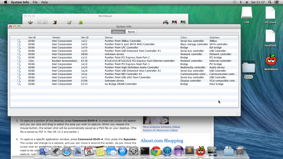

This is system info dump
ven id         Vendor       DevID   Device                       Class   Subclass
8086           Intel        1e59    HM76 Express LPC controller   Bridge    ISA
               Intel        1e3a    7 serires c210 MEI controller #1 Communication b
               Intel        1e31                    USBxHCIcontroller
               Intel        1e2d                    USB Enhanced Host 1
               Intel        1e26                    USBxEnhanced Host 2
               Intel        1e22                    SMBus Controller
               Intel        1e20                    HD audio
               Intel        1e12                    PCI Express Root 2
               Intel        1e10                    PCI Express Root 1
               Intel        1e03                    Sata bridge
               Intel        0888     Cntrino Wireless -N 2230
               Intel        0166     3rd Gen Graph Controler
               Intel        0154     3rd Gen DRAM Controler
10ec           Realtek      8136     RTL8101E/RTL812E PCI Express Ethernet

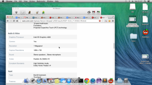

However, I suspect whether my audio card is really Intel as I googled around a for while.
I searched online and found the CNET.com have the spec, it says ALC269Q
I have attached the evidence in pictures.
