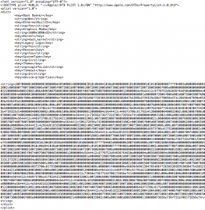

3square Posted October 25, 2013 Share Posted October 25, 2013 hello all, I have a 8800 GT and a 8500 GT. They both ran great, pumping out my quad monitors setup in lion and ML. This was done via injection code method in the boot plist. I bit the bullet and upgraded to Mavericks, and what do you know... all mess up now =\ install went fine, boot back in everything else work (wifi, sounds, bluetooth, HD etc.) except for the graphic cards. Only one monitor, no QE/CI, choppy as hell. I also got the warning about nvidia web driver doesn't support Mavericks blah blah blah. 100 million dollar question... any one know how to get my cards to work? please? tried using nvenabler, no go, try loading the old nvidia kext from ML, nada. any suggestion would greatly appreciated. dell XPS 420 newest chameleon 2266 graphic enabler: on smbios: macpro 3,1 both cards recognized and identified in system report custom DSDT, i found one that was made for my xps 420. work fine before all this. retail Mavericks, installed over ML (i know... messy way) Link to comment https://www.insanelymac.com/forum/topic/293077-solved-8800-gt-on-mavericks-help-please/ Share on other sites More sharing options...

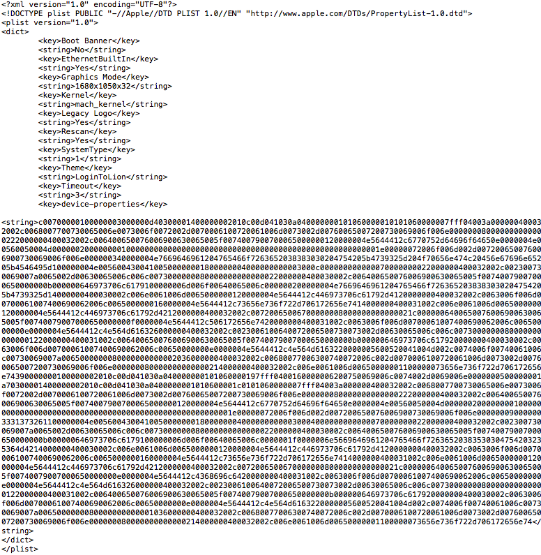

3square Posted October 28, 2013 Author Share Posted October 28, 2013 Yes try deleting all the nvda kext with tesla in the name. Reference the post I link. My setup is a dell xps 420, with dsdt... Not sure what else it'll take for your to work. Good luck I did not need to boot with any flag, and graphic enabler is set to yes. I do have injection for the cards in the boot plist Link to comment https://www.insanelymac.com/forum/topic/293077-solved-8800-gt-on-mavericks-help-please/#findComment-1959565 Share on other sites More sharing options...

3square Posted October 29, 2013 Author Share Posted October 29, 2013 3square, thanks for all your help so far. Yes, I also tried ML kext at 1st. Injection, I am still reading up a learning about… bit fuzzy to understand for me atm, but I think my dsdt.aml. I don't recall where I originally got it but it could have been from an old topic here on InsanelyMac for the Asus P5E (maybe 3-4 years old now). my chameleon.boot.plist <key>Boot Banner</key> <string>No</string> <key>EthernetBuiltIn</key> <string>Yes</string> <key>Graphics Mode</key> <string>1680x1050x32</string> <key>Kernel</key> <string>mach_kernel</string> <key>Legacy Logo</key> <string>Yes</string> <key>Rescan</key> <string>Yes</string> <key>SystemType</key> <string>1</string> <key>Theme</key> <string>LoginToLion</string> <key>Timeout</key> <string>3</string> i include my S/L/E portion of the NVDA* kext that i'm using. same one from DP8. Use this to generate a EFI injection for your card. from the drop down menu, it'll give you a list of cards. select your card, and it should add the efi string into your chameleon.boot.plist. http://www.insanelymac.com/forum/topic/124911-osx86tools-final-release-is-here/ you can see my complete chameleon.boot.plist which the included efi string. i'm using the string to include both my cards. as you can see from my graphic card description "Rom Revision"... it said EFI. I'm including a zip of all the NVDA's related kext...include two that has TESLA. i guess i didn't have to delete all of the TESLA's kext. Worth a shot dropping it in. Sorry i can't be anymore specific. I've manage to "fumble" along and figure out how to get it to work on mine. It been working since Lion till now, so that's all i know. hope any of this will help you. NVDA_DP8.zip Link to comment https://www.insanelymac.com/forum/topic/293077-solved-8800-gt-on-mavericks-help-please/#findComment-1960226 Share on other sites More sharing options...
JBX Posted October 29, 2013 Share Posted October 29, 2013 Thanks 3square, I will try it out this afternoon and report back….. 1 question though, did you remove any of your Geforce kext from S/L/E? To get this far I had to remove (GeForceTesla.kext, GeForceTeslaGLDriver.bundle, GeForceTeslaVADriver.bundle). Anyway, I will experiment and see where I get. Link to comment https://www.insanelymac.com/forum/topic/293077-solved-8800-gt-on-mavericks-help-please/#findComment-1960481 Share on other sites More sharing options...
JBX Posted October 29, 2013 Share Posted October 29, 2013 3square, I tried replacing all my NVD kext with yours and adding device string to my boot plist. However there was no change for me. Also it did not seem to matter that these included the tesla kext, however (at least for me) the Geforce tesla kext I listed above are a problem. If those are in my S/L/E folder, I get a gray screen at boot. Anyway, I have to look deeper into my dsdt and see how that is set up. Thanks for your time. Link to comment https://www.insanelymac.com/forum/topic/293077-solved-8800-gt-on-mavericks-help-please/#findComment-1960555 Share on other sites More sharing options...

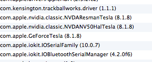

macintoshlover Posted November 1, 2013 Share Posted November 1, 2013 @jackbutler Did you have any luck with this? @3square Which Nvidia kexts do you see loaded in System Information > Software > Extensions? And BTW, what model identifier are you using for your system? Link to comment https://www.insanelymac.com/forum/topic/293077-solved-8800-gt-on-mavericks-help-please/#findComment-1962174 Share on other sites More sharing options...

3square Posted November 5, 2013 Author Share Posted November 5, 2013 @jackbutler Did you have any luck with this? @3square Which Nvidia kexts do you see loaded in System Information > Software > Extensions? And BTW, what model identifier are you using for your system? kext wizard showing those NVDA and geforce kext loaded. Link to comment https://www.insanelymac.com/forum/topic/293077-solved-8800-gt-on-mavericks-help-please/#findComment-1963782 Share on other sites More sharing options...

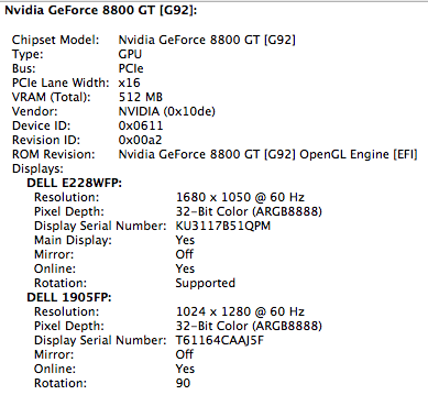

JBX Posted May 17, 2014 Share Posted May 17, 2014 Have not really spent time on this till today... try with fresh 10.9 + 10.9.3 Combo updater on external test HD. Inject via org.chamelion.boot.plist. Also must remove GeForce Tesla kext (otherwise will not boot). So I now have MSI 8800GT showing up and correct screen resolution for my main monitor, however no acceleration. <dict> <key>GraphicsEnabler</key> <string>Yes</string> <key>Kernel</key> <string>mach_kernel</string> <key>Kernel Flags</key> <string>-f -v nvda_drv=1</string> <key>Timeout</key> <string>5</string> <key>Graphics Mode</key> <string>2048x1152x32</ string> <key>device-properties</key> <string>6c0200000100000001000000600200000d00000002010c00d041030a000000000101060000010101060000007fff04001e00000072006f006d002d007200650076006900730069006f006e0000002e0000006e5669646961204765466f7263652038383030204754204f70656e474c20456e67696e65205b4546495d22000000400030002c006400650076006900630065005f00740079007000650000000b000000646973706c6179100000004e00560043004100500000001800000004000000000003000c00000000000007000000000e0000006e0061006d00650000000b000000646973706c617914000000400030002c006e0061006d0065000000120000004e5644412c446973706c61792d41100000006d006f00640065006c0000001a0000006e5669646961204765466f72636520383830302047540e0000004e00560050004d000000200000000100000000000000000000000000000000000000000000000000000014000000400031002c006e0061006d0065000000120000004e5644412c446973706c61792d4220000000400031002c0063006f006d00700061007400690062006c00650000000e0000004e5644412c4e564d6163220000005600520041004d002c0074006f00740061006c00730069007a0065000000080000000000002020000000400030002c0063006f006d00700061007400690062006c00650000000e0000004e5644412c4e564d616322000000400031002c006400650076006900630065005f00740079007000650000000b000000646973706c61791c0000006400650076006900630065005f00740079007000650000000f0000004e5644412c506172656e74</string> </dict> Link to comment https://www.insanelymac.com/forum/topic/293077-solved-8800-gt-on-mavericks-help-please/#findComment-2020123 Share on other sites More sharing options...
