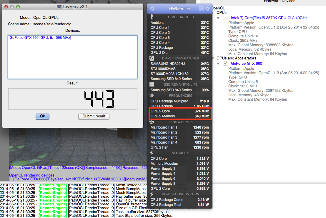

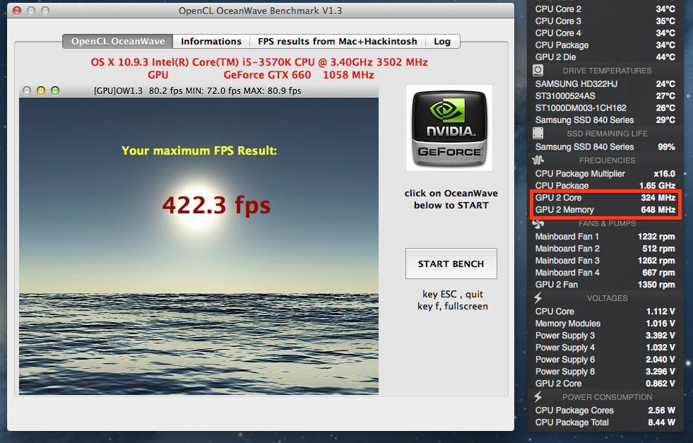

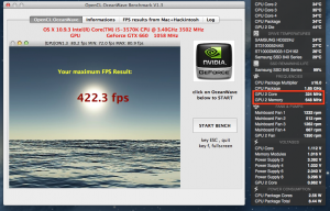

Gringo Vermelho Posted May 17, 2014 Share Posted May 17, 2014 Confirmed! Great news. Lower clocks = less heat, less fan noise and longer component life. Here's some photo evidence - screenshots taken after running Oceanwave, Luxmark: Link to comment https://www.insanelymac.com/forum/topic/292929-gtx660-opencl-and-mavericks/#findComment-2020120 Share on other sites More sharing options...
