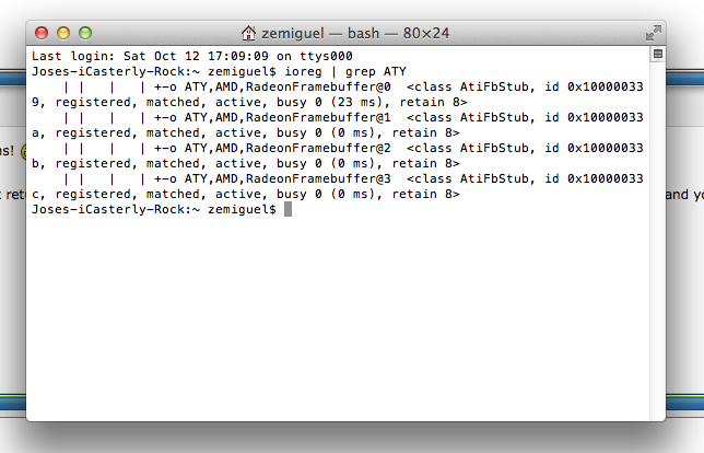

poispois Posted October 12, 2013 Author Share Posted October 12, 2013 Does everything seems ok? (My workaround to watching movies/TV shows is using VLC, although I prefer MplayerX on the MacBook.) Link to comment https://www.insanelymac.com/forum/topic/292647-no-video-playback-on-hd7770/#findComment-1953886 Share on other sites More sharing options...
joe75 Posted October 12, 2013 Share Posted October 12, 2013 that is the one you don't want. with clover you need to add an FBName entry in the Graphics section of your config, try first with Hamachi http://clover-wiki.zetam.org/Configuration/Graphics#FBName 1 Link to comment https://www.insanelymac.com/forum/topic/292647-no-video-playback-on-hd7770/#findComment-1953957 Share on other sites More sharing options...
