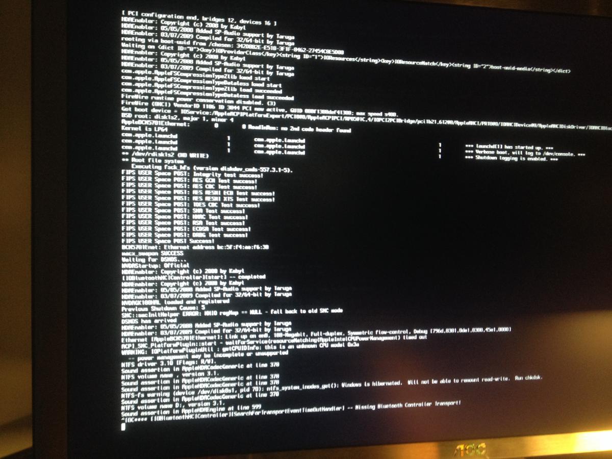

ballzdeepftw Posted October 12, 2013 Author Share Posted October 12, 2013 AsRock Z77 Extreme 6 Hey, I've tried vinilla, and it has the same stopping point which is at that Bluetooth error. I have nothing that is Bluetooth, including the motherboard. I think that if we can figure this out, it will boot. Quote Link to comment https://www.insanelymac.com/forum/topic/292612-help-installing-gtx-650-ti-boost-2gb-1085/#findComment-1953758 Share on other sites More sharing options...
joe75 Posted October 12, 2013 Share Posted October 12, 2013 you stop at bluetooth because its usually last thing to load before windowserver starts, which is not starting because of the graphics problem. did you insert the iMac smbios that gringo linked? are you using a dsdt file with this board? Quote Link to comment https://www.insanelymac.com/forum/topic/292612-help-installing-gtx-650-ti-boost-2gb-1085/#findComment-1953760 Share on other sites More sharing options...
