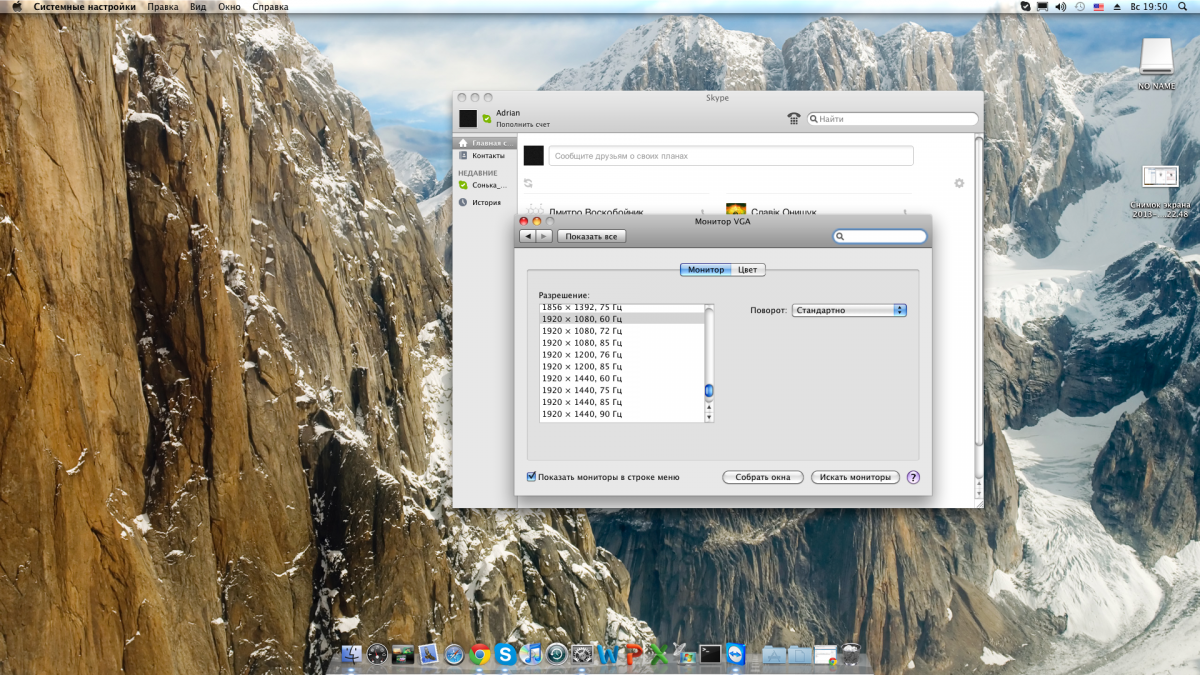

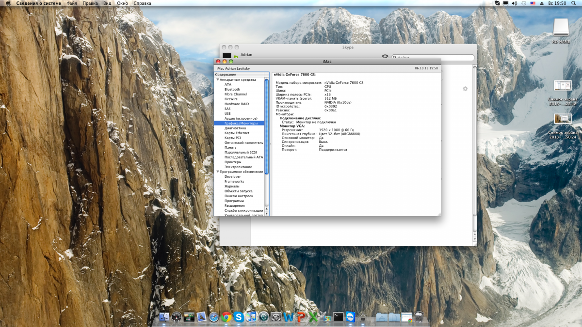

xadikx123 Posted October 6, 2013 Share Posted October 6, 2013 Hi ! Then i am working, or surfing the net, on one second all of my app's are closing. and appears a blue screen for second (like then i am booting OSX), some one know why? and how to fix it ? (and my video cant recognize my monitor (screen)) iAtkos 10.6.3 Dell 5150 Pentium D 2.8 gf 7600 gs 512 mb 4 GB ddr2 hdd 500 + hdd 80 (sata) Ide DVD rom monitor LG Link to comment https://www.insanelymac.com/forum/topic/292467-blue-screen/ Share on other sites More sharing options...

Gringo Vermelho Posted October 6, 2013 Share Posted October 6, 2013 Yes, as of 10.6.3 there is no 64-bit driver for Geforce 7xxx series cards. Must boot with arch=i386 xadix: (again) try using the monitor output closest to the motherboard. Use an adapter if you have to. Also, instead of posting new topics all the time it would be better if you could stick to one thread when discussing the same hardware, to keep the information in one place. Link to comment https://www.insanelymac.com/forum/topic/292467-blue-screen/#findComment-1951524 Share on other sites More sharing options...
xadikx123 Posted October 6, 2013 Author Share Posted October 6, 2013 Gringo Vermelho Ok i will. "Make sure you are booting in 32 bit mode. " Then i run in x32 its the same. "xadix: (again) try using the monitor output closest to the motherboard. Use an adapter if you have to." If i use VGA modul to connect monitor it show's me only blue screen in starup and i used DVI with adapter and its run good. But i still have this lag... Sry for stupid questions, but I'm using hackintosh not a long time ) Link to comment https://www.insanelymac.com/forum/topic/292467-blue-screen/#findComment-1951546 Share on other sites More sharing options...
