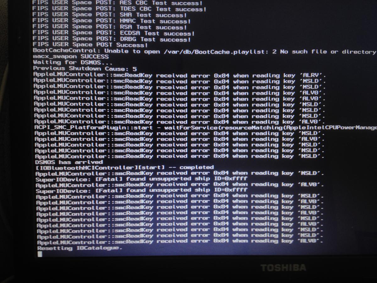

Mikebyrne000 Posted September 21, 2013 Share Posted September 21, 2013 I'm currently trying to install ML2 on my C660-21Z and it hangs on the apple logo. When I boot with -v I get the following screen: Then after about 4 minutes the intro music plays but I can't see a video My Specs are: Intel® Core™ i3 CPU M 370 @ 2.40GHz, 2394 MHz8Gb Ram320Gb Hard driveIntel® HD GraphicsRealtek RTL8188CE Wireless LAN 802.11n PCI-E NICHigh Definition Audio Controller Link to comment https://www.insanelymac.com/forum/topic/292035-intro-music-no-video/ Share on other sites More sharing options...

artur_pt Posted September 23, 2013 Share Posted September 23, 2013 hello remove all appleintelhd*.* from system/library/extensions about u problem http://www.insanelymac.com/forum/topic/286092-guide-1st-generation-intel-hd-graphics-qeci/ good hack 1 Link to comment https://www.insanelymac.com/forum/topic/292035-intro-music-no-video/#findComment-1947974 Share on other sites More sharing options...
Mikebyrne000 Posted September 23, 2013 Author Share Posted September 23, 2013 Transmac wont let me delete files for some reason and I can't load the OS in safe mode Link to comment https://www.insanelymac.com/forum/topic/292035-intro-music-no-video/#findComment-1947980 Share on other sites More sharing options...
artur_pt Posted September 23, 2013 Share Posted September 23, 2013 hello boot -s fsck -fy mount -uw / mkdir /intelhd_backup cd /System/Library/Extensions mv AppleIntelHD* AppleIntelSNB* /intelhd_backup reboot good hack 1 Link to comment https://www.insanelymac.com/forum/topic/292035-intro-music-no-video/#findComment-1947984 Share on other sites More sharing options...
Mikebyrne000 Posted September 23, 2013 Author Share Posted September 23, 2013 THANKS!!!!! The laptop is booting up fine now. The wifi seems to be in issue now, but I'll see what I can do Link to comment https://www.insanelymac.com/forum/topic/292035-intro-music-no-video/#findComment-1947987 Share on other sites More sharing options...
