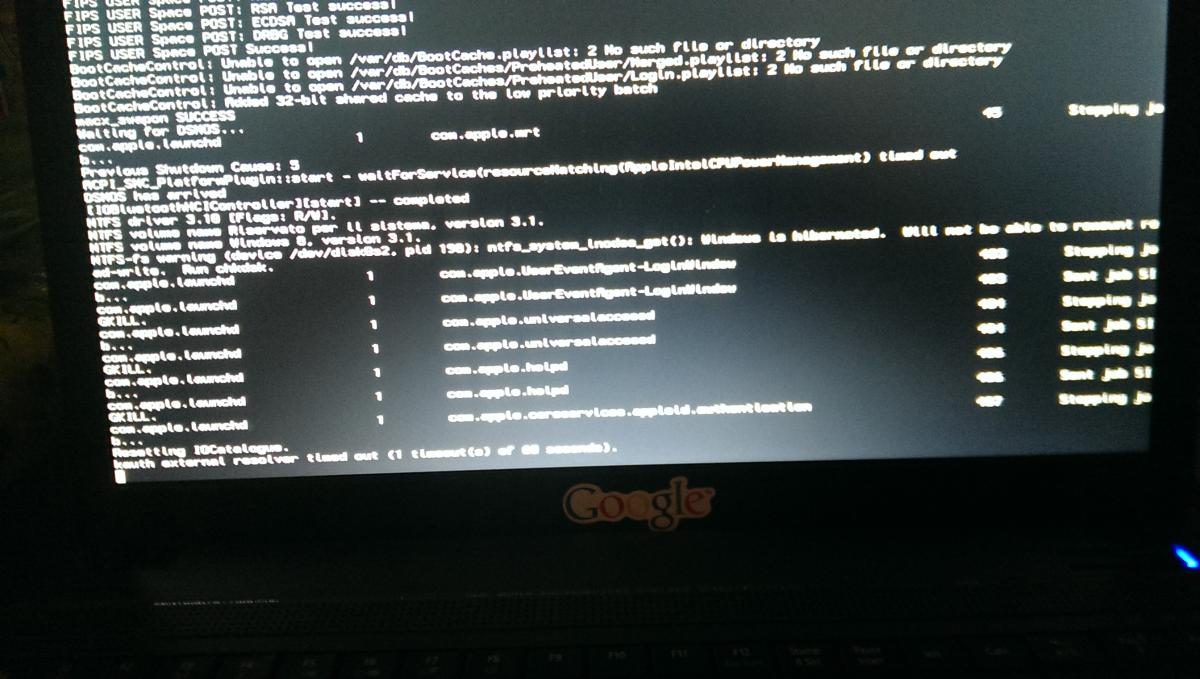

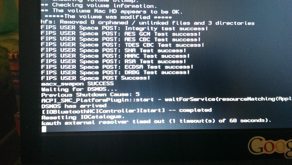

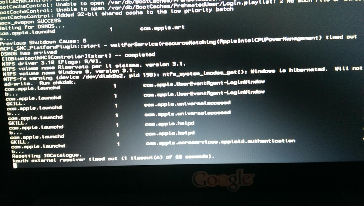

AlbertoSONIC Posted September 1, 2013 Share Posted September 1, 2013 I'm trying to get Mac Os X to work on my Laptop... Here's my specs: BRAND: Acer MODEL: Travelmate 5742z CPU: Pentium P6200 (Dualcore, 2.13 ghz, 64BIT) RAM: 3GB WIFI: Broadcom GRAPHICS: Intel HD Graphics (3000 i think, not sure)(1366x768) HDD: 500GB PARTITIONS: 1) 290GB - Windows 8 2) 140GB - Ubuntu 12.04 LTS 3) 66GB - Mac Os X 4) SWAP I tried some hackintosh versions, but none works: 1)Hazard (Snow Leopard), reboots before installation 2)Ideneb / Ideneb 1.3 (Snow Leopard), Grub2 was not able to boot it, not tried again when grub 2 was fixed 3)Niresh Os X (Mountain Lion), the last i tried, won't boot... I get an error (see attached screens) What do i need to do? Do you suggest me another Hackintosh Distribution? EDIT: Tried with -v -x also, won't boot... (see screens) Link to comment https://www.insanelymac.com/forum/topic/291590-acer-travelmate-5742z-mac-os-x/ Share on other sites More sharing options...
artur_pt Posted September 1, 2013 Share Posted September 1, 2013 hello u problem is graphics u graphics is not supported in mac os x to install remove from system/library/extensions all appleintelhd*.* boot -f -v GraphicsEnabler=No must use usb install good hack 1 Link to comment https://www.insanelymac.com/forum/topic/291590-acer-travelmate-5742z-mac-os-x/#findComment-1942731 Share on other sites More sharing options...
AlbertoSONIC Posted September 2, 2013 Author Share Posted September 2, 2013 hello u problem is graphics u graphics is not supported in mac os x to install remove from system/library/extensions all appleintelhd*.* boot -f -v GraphicsEnabler=No must use usb install good hack Thank you for you answer! Sorry, but without graphics how can it work? I think i need to do something after installation... I'm right? EDIT: I discovered that i have simply Intel HD Graphics, not 3000 one... Link to comment https://www.insanelymac.com/forum/topic/291590-acer-travelmate-5742z-mac-os-x/#findComment-1942793 Share on other sites More sharing options...
