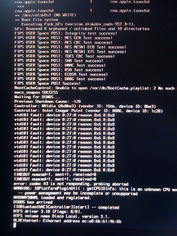

artur_pt Posted July 26, 2013 Share Posted July 26, 2013 olá tira foto do boot -f -v GraphicsEnabler=No e posta bom hack Link to comment https://www.insanelymac.com/forum/topic/290801-helpecs-h61h2-m2-somente-inicializa%C3%A7%C3%A3o-segura/#findComment-1934785 Share on other sites More sharing options...
L.P. Posted July 26, 2013 Author Share Posted July 26, 2013 Segue a imagem! Link to comment https://www.insanelymac.com/forum/topic/290801-helpecs-h61h2-m2-somente-inicializa%C3%A7%C3%A3o-segura/#findComment-1934793 Share on other sites More sharing options...
artur_pt Posted July 26, 2013 Share Posted July 26, 2013 olá tenta desabilitar na bios Virtualization Tech e o VT-d bom hack Link to comment https://www.insanelymac.com/forum/topic/290801-helpecs-h61h2-m2-somente-inicializa%C3%A7%C3%A3o-segura/#findComment-1934797 Share on other sites More sharing options...

Pimentel Posted July 26, 2013 Share Posted July 26, 2013 Olá camaradaPela imagem tu já tem: Áudio,Internet e Vídeo carregado. Somente deve faltar alguma coisa.Tens FakeSMC instalada? Tens NullCPUPowermanagement instalada?DSDT é mais para gerenciamento de energia e a NullCPUPM já resolve o gerenciamento se for instalada.Que sistema usa? ML 10.8.0,10.8.1,10.8.2 ou 10.8.3? Link to comment https://www.insanelymac.com/forum/topic/290801-helpecs-h61h2-m2-somente-inicializa%C3%A7%C3%A3o-segura/#findComment-1934831 Share on other sites More sharing options...

artur_pt Posted July 26, 2013 Share Posted July 26, 2013 olá tem qualquer coisa no config da bios k n está bem... pela imagem é o vt-d Configurações do BIOS e se estás a usar dsdt de outro, tira dsdt é como cueca, tu usa cueca de outro homem ? bom hack Link to comment https://www.insanelymac.com/forum/topic/290801-helpecs-h61h2-m2-somente-inicializa%C3%A7%C3%A3o-segura/#findComment-1934852 Share on other sites More sharing options...
