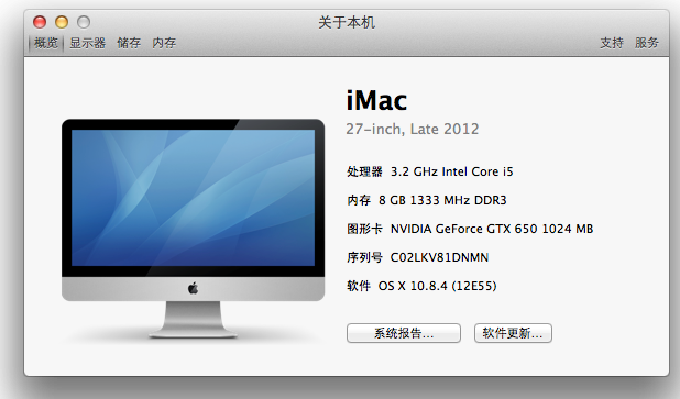

halechan Posted July 22, 2013 Share Posted July 22, 2013 Hardware: CPU: Haswell i5 4570 Motherboard: MSI H87M-G43 Graphic card: GTX 650 1G RAM: Kingston DDR3 1600 4G X2 WLAN card:BCM4322 Hard disk: Seagate Barracuda 1T Guide: 1. make ML 10.8.4 12E55 U installer 2. get mach_kernel from 10.8.5 update package and put it to the U installer 3. boot from U installer and install ml, after installed the system, copy the mach_kernel to the partition of your ml. 4. boot to ml, install bootloader, drivers 5. install AHCI, USB, PCI drivers from 10.8.5 update package Working features 1. gtx650 2. realtek 8111g by using rtl8111.kext 3. ALC 892 by using VoodooHDA 2.8.4 4. bcm4322 Edit1: 1. Intel HD4600 working now, use Chimera here:http://www.insanelymac.com/forum/topic/290940-chimera-for-intel-hd4600/ Edit2: 1. Patched AppleHDA, ALC892 worked now! 2. Clover boot is worked! Link to comment https://www.insanelymac.com/forum/topic/290716-successinstall-ml1084-on-haswell-h87-gtx650-platform/ Share on other sites More sharing options...
