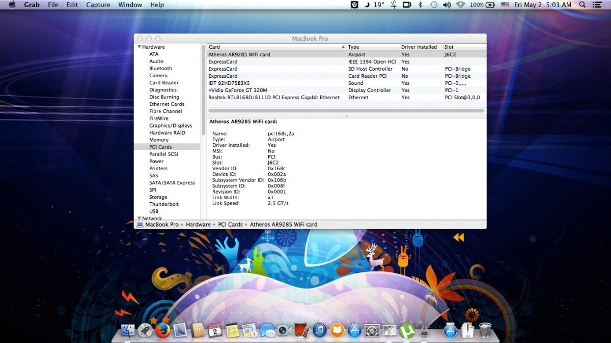

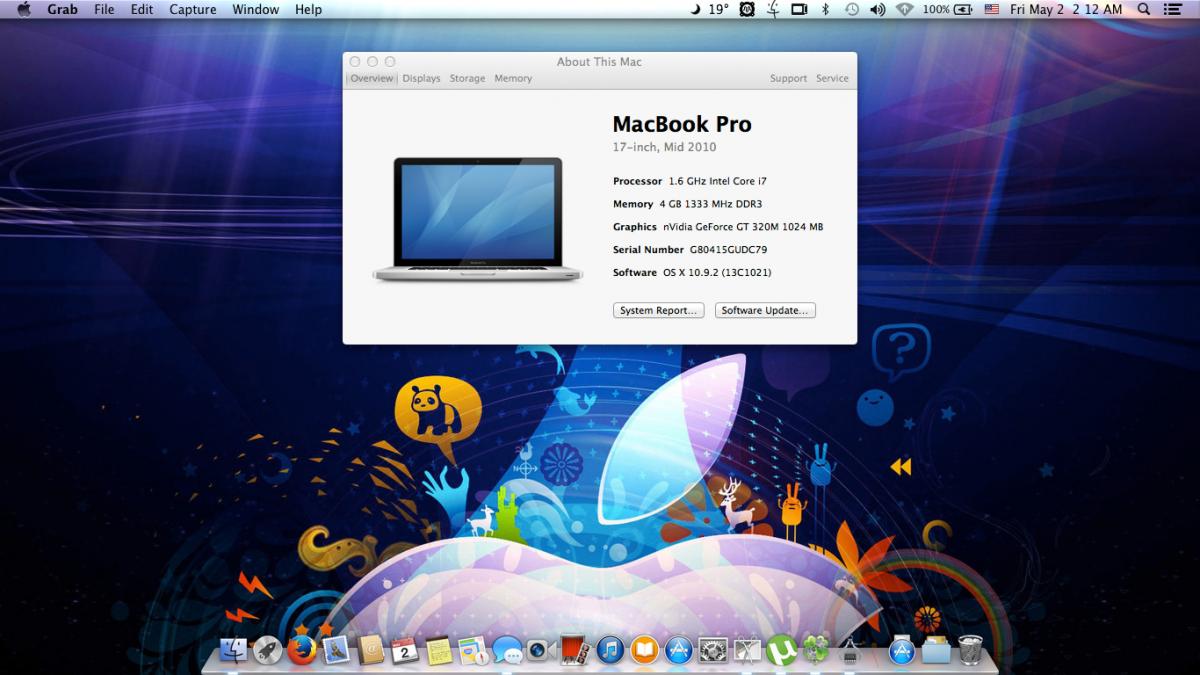

Egyptiano Posted June 29, 2013 Share Posted June 29, 2013 (edited) Hello everyone and peace for all spec Machine : HP dv6t-2300 cto Processor : Intel® Core™ i7-720QM Processor (6M Cache, 1.60 GHz) Memory : 4 GB 1333 MHz DDR3 Hard Disk : Seagate 1TB SSHD (Internal) + Hitachi 320 GB (External) Graphic Adapter : GeForce GT 320M 1024 MB ( WORKING ) WI-FI : Atheros AR9285 WiFi ( WORKING ) + Bluetooth ar3011 Combo ( WORKING ) replaced with : Intel Advanced-n 6200 ( NOT WORKING ) LAN : Realtek ( WORKING ) Sound : IDT 92HD75B3X5 ( WORKING ) HP Camera : ( WORKING ) Bootloader : both Chameleon and Clover bootloaders working fine. --------------------------------------------------------------------- ---Steps--- - restore Mavericks 10.9.2 via myhack to usb or partition on external hard disk - replace OSInstall(MBR) + OSInstall.mpkg - start installing with ( cpus=1 -v ) boot flags - after finishing install start Mavericks 10.9.2 with ( cpus=1 -v ) boot flags - use Lapic Kernel Patcher V0.7 1.0 to boot without cpus=1 - download DSDT.aml - download AppleHDA.kext - download VoodooBattery.kext - download RealtekRTL8111.kext - install all kexts via kext utility ---Optional--- - download org.chameleon.Boot.plist Chameleon Bootloader configuration file - download config.plist Clover Bootloader configuration file - download IO80211Family.kext for Atheros AR9285 WiFi - download BTFirmwareUploader.kext for Bluetooth ar3011 Edited May 3, 2014 by Egyptiano Link to comment https://www.insanelymac.com/forum/topic/290247-success-updated-hp-dv6t-2300-cto-mavericks-1092/ Share on other sites More sharing options...
