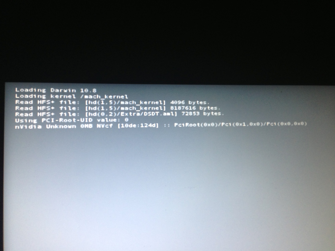

qwertyparam Posted June 23, 2013 Share Posted June 23, 2013 Hi people, so this my 3rd topic in 2 days. I was trying to iatkos ml2 on my Alienware for the past 2 days, but just gave it up and instead decided to go the Retail way. So i have installed it successfully using -v -f ncpi=0x3000 bootflag on first boot. The installation went well. But now I can not boot into it. I am getting some error.Screen shot below. Does anyone have a clue on how to resolve it? help would be appreciated Specs : CPU: Intel® Core™ i7-2670QM CPU @ 2.20GHz, 2192 MHz GPU: Intel® HD Graphics 3000 and NVIDIA GeForce GT 555M 1 Link to comment https://www.insanelymac.com/forum/topic/290109-mountain-lionretail-on-alienware-m14x/ Share on other sites More sharing options...
artur_pt Posted June 23, 2013 Share Posted June 23, 2013 hello delete all nv*.* geforce.* the nvidia don't work only the intel hd 3000 is well know issue good hack Link to comment https://www.insanelymac.com/forum/topic/290109-mountain-lionretail-on-alienware-m14x/#findComment-1927192 Share on other sites More sharing options...
qwertyparam Posted June 23, 2013 Author Share Posted June 23, 2013 hello delete all nv*.* geforce.* the nvidia don't work only the intel hd 3000 is well know issue good hack I deleted all of them but I still get the same error..any idea what else can be the problem?? EDIT: Can this be because of a DSDT.aml that i have in my flashdrive from which i boot? Link to comment https://www.insanelymac.com/forum/topic/290109-mountain-lionretail-on-alienware-m14x/#findComment-1927202 Share on other sites More sharing options...
artur_pt Posted June 23, 2013 Share Posted June 23, 2013 hello u have a dsdt before the install .. is from yours pc ? if not don't use it.. if it is from another machine dsdt is like underwear .. i don't use the slips from another man... have u boot -f -v to ignore the caches good hack Link to comment https://www.insanelymac.com/forum/topic/290109-mountain-lionretail-on-alienware-m14x/#findComment-1927215 Share on other sites More sharing options...
qwertyparam Posted June 24, 2013 Author Share Posted June 24, 2013 hello u have a dsdt before the install .. is from yours pc ? if not don't use it.. if it is from another machine dsdt is like underwear .. i don't use the slips from another man... have u boot -f -v to ignore the caches good hack The dsdt was not mine. So now i deleted it, and booted with -f -v flag but still i get the same error.. Can you think of any other possible cause for this type of error? Link to comment https://www.insanelymac.com/forum/topic/290109-mountain-lionretail-on-alienware-m14x/#findComment-1927234 Share on other sites More sharing options...
Onixs Posted June 24, 2013 Share Posted June 24, 2013 Your issue is during the early stage of the bootloader. this has nothing to do with kext yet. GraphicsEnabler is set to "Yes" if not specified, so i suggest you to disable it by typing: GraphicsEnabler=No -f -v if not, then ask again Link to comment https://www.insanelymac.com/forum/topic/290109-mountain-lionretail-on-alienware-m14x/#findComment-1927238 Share on other sites More sharing options...

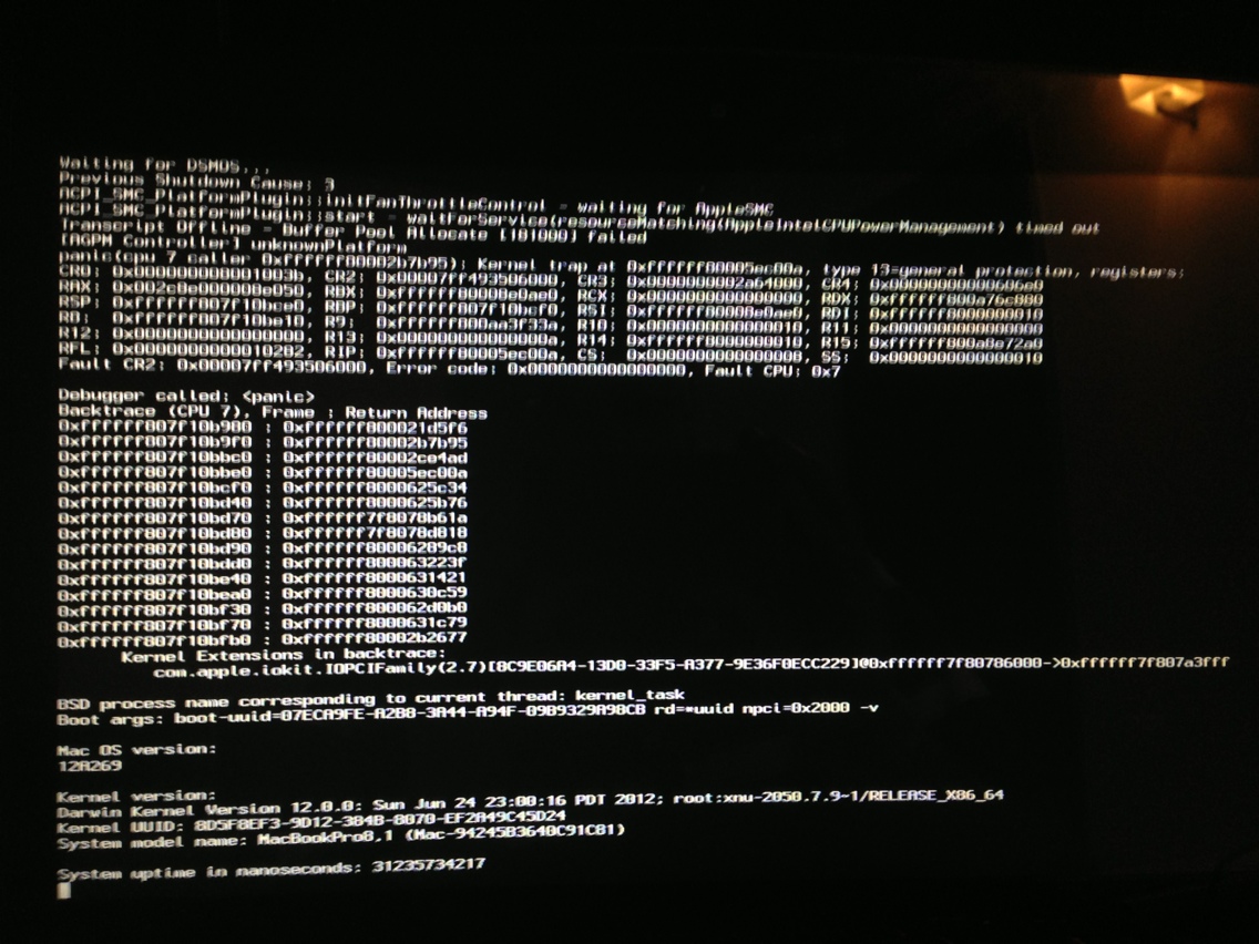

qwertyparam Posted June 24, 2013 Author Share Posted June 24, 2013 Your issue is during the early stage of the bootloader. this has nothing to do with kext yet. GraphicsEnabler is set to "Yes" if not specified, so i suggest you to disable it by typing: GraphicsEnabler=No -f -v if not, then ask again hi, so i simply disabled my Nvidia GT 555M through my Bios and got forward than that error, but now I am getting a Kernel panic (screen shot below), do u know how can I fix this? Link to comment https://www.insanelymac.com/forum/topic/290109-mountain-lionretail-on-alienware-m14x/#findComment-1927242 Share on other sites More sharing options...
Onixs Posted June 24, 2013 Share Posted June 24, 2013 Which tool did you used to make the usb installer, and what flags are you using? It looks like just a random KP, boot again with just -f -v Link to comment https://www.insanelymac.com/forum/topic/290109-mountain-lionretail-on-alienware-m14x/#findComment-1927243 Share on other sites More sharing options...

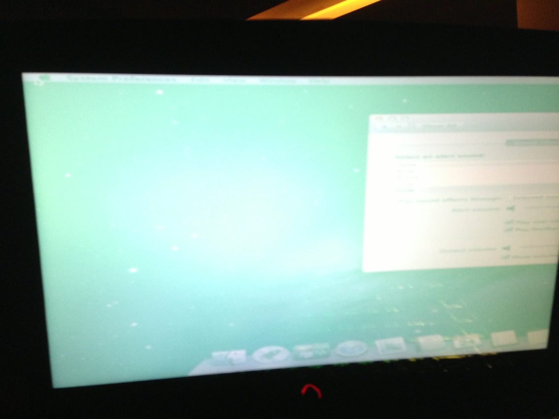

qwertyparam Posted June 24, 2013 Author Share Posted June 24, 2013 Which tool did you used to make the usb installer, and what flags are you using? It looks like just a random KP, boot again with just -f -v I used my iMac (Mountain LIOn) to create the usb. so i got through the kernel panic, but now the problem is my trackpad is not working and the graphics are really weird and have greenish tinge.. see screenshot.. any kext(s) that could solve my problem? EDIT : So I did manage to get through this error too, and now the trckpad aslo works but i have a weird problem that i can use the trackpad to navigate but when i click anything, there is no response, same with the keyboard also. And not to forget, i am not getting hd resolution and acceleration from Intel HD 3000..how can i get that..? Link to comment https://www.insanelymac.com/forum/topic/290109-mountain-lionretail-on-alienware-m14x/#findComment-1927424 Share on other sites More sharing options...
Aju Deeju Posted June 25, 2013 Share Posted June 25, 2013 Remove appleps2controller kext and install voodoops2 using a USB keyboard and mouse ofcourse.... For your hd3000: Try this http://olarila.com/forum/viewtopic.php?f=28&t=2193 Link to comment https://www.insanelymac.com/forum/topic/290109-mountain-lionretail-on-alienware-m14x/#findComment-1927649 Share on other sites More sharing options...

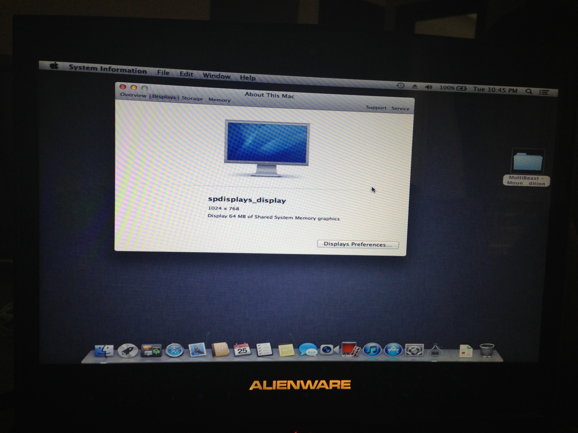

qwertyparam Posted June 25, 2013 Author Share Posted June 25, 2013 Remove appleps2controller kext and install voodoops2 using a USB keyboard and mouse ofcourse.... For your hd3000: Try this http://olarila.com/forum/viewtopic.php?f=28&t=2193 Yeah, the trackpad and keyboard work now I also followed artur's guide for enabling full resolution but that didnt work for me i have 1024x768(screenshot below) at the moment.any idea how can i gain full acceleration with it? Link to comment https://www.insanelymac.com/forum/topic/290109-mountain-lionretail-on-alienware-m14x/#findComment-1927675 Share on other sites More sharing options...
artur_pt Posted June 25, 2013 Share Posted June 25, 2013 hello what is u native resolution ? if bigger then 1366x768 must use dual link and smbios macbookpro8,1 good hack Link to comment https://www.insanelymac.com/forum/topic/290109-mountain-lionretail-on-alienware-m14x/#findComment-1927697 Share on other sites More sharing options...
qwertyparam Posted June 25, 2013 Author Share Posted June 25, 2013 No, my native resolution is not bigger than 1366x768. But anyway I have MacBook 8,1 SMbios. But is there any way I can get better resolution than 1024x768? Link to comment https://www.insanelymac.com/forum/topic/290109-mountain-lionretail-on-alienware-m14x/#findComment-1927704 Share on other sites More sharing options...
artur_pt Posted June 25, 2013 Share Posted June 25, 2013 hello u should have u native resolution... what kext are loaded ? must be loaded 2 the 3000 and the fb probably now u don't have qe/ci are u booting with GraphicsEnabler=Yes good hack Link to comment https://www.insanelymac.com/forum/topic/290109-mountain-lionretail-on-alienware-m14x/#findComment-1927714 Share on other sites More sharing options...

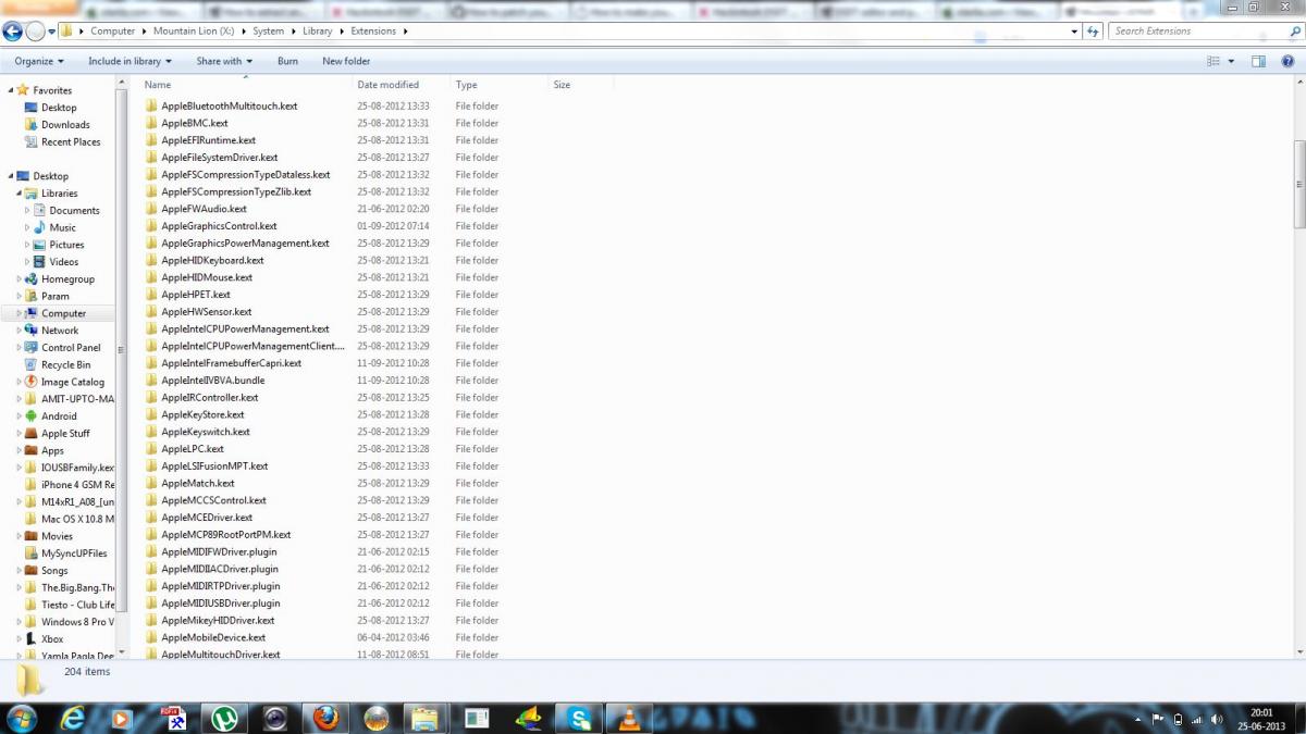

qwertyparam Posted June 25, 2013 Author Share Posted June 25, 2013 hello u should have u native resolution... what kext are loaded ? must be loaded 2 the 3000 and the fb probably now u don't have qe/ci are u booting with GraphicsEnabler=Yes good hack No, i have only 2 kexts loaded for Intel. (see screen shot) EDIT : I am sorry. I just figured out that my native resolution is 1600x900. Link to comment https://www.insanelymac.com/forum/topic/290109-mountain-lionretail-on-alienware-m14x/#findComment-1927717 Share on other sites More sharing options...
artur_pt Posted June 25, 2013 Share Posted June 25, 2013 hello what is this u installer ? or the system installed in u hd ? if this is what u have in the hd.. never work.. u don't have the kext for the graphics... appleintelhd3000 appleintel*snb must be in the folder backup must install it again good hack Link to comment https://www.insanelymac.com/forum/topic/290109-mountain-lionretail-on-alienware-m14x/#findComment-1927725 Share on other sites More sharing options...
qwertyparam Posted June 25, 2013 Author Share Posted June 25, 2013 I had windows 7 installed first and on the second partition I installed Mountain lion. So in windows I have hfs+ drivers therefore I can easily browse through mac hd and manage kexts. Ok so now I will reinstall those 2 Kexts and let you know.. Link to comment https://www.insanelymac.com/forum/topic/290109-mountain-lionretail-on-alienware-m14x/#findComment-1927729 Share on other sites More sharing options...
