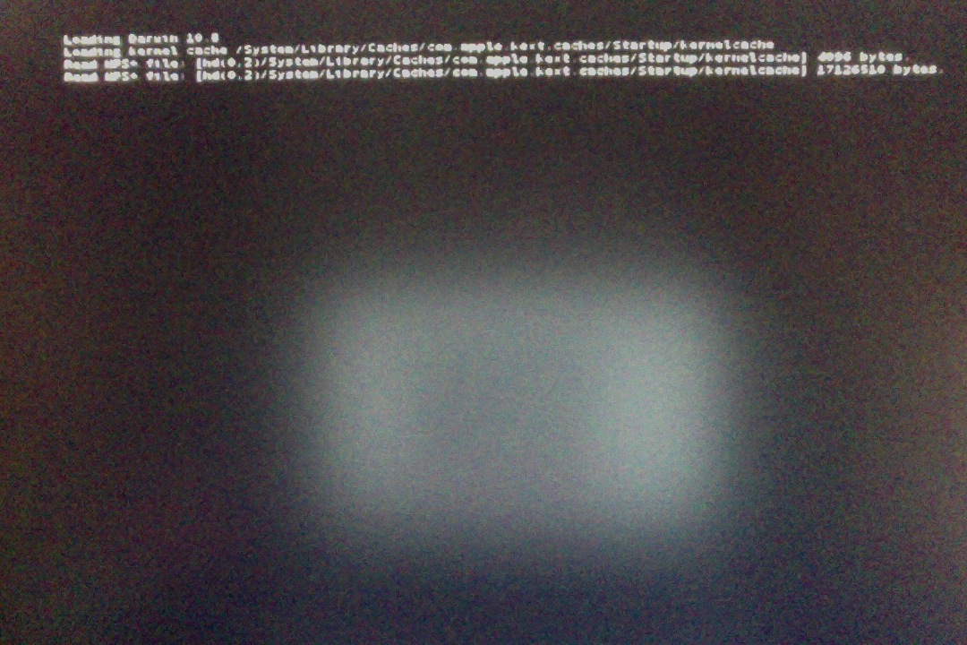

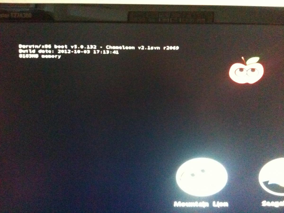

macimbu Posted June 22, 2013 Share Posted June 22, 2013 Hello guys, thank you so much for all the tips shared on the forum.I'm newin the hackintosh world, and looking here and there I managed to install mountain lion without problems on my pc.I've got Sabertooth x58 - i7 950 3.07Ghz - geforce GTX 560 (NO TI).This is my first hackintosh and everything worked just fine until it came to my mind to install Chameleon.On the first reboot after installation Mountain Lion just does not start, after boot it gives me only a black screen.I tried different boot options (-v -x PCIRootUID=0 GraphicsEnabler=No, and more) but nothing... does anyone know how to help me? As you can see in the first picture at boot it indicates the presence of Chameleon, can it be turned off at startup?The second image is the result of the verbose ...Please help me!!! Ps: Do you think that physically remove the hard drive with mountain lion and manually remove Chameleon might work? How do I recognize the files that were installed... I hope to find other solutions, this one seems quite tricky Quote Link to comment https://www.insanelymac.com/forum/topic/290074-chameleon-killed-my-machine-help-me/ Share on other sites More sharing options...
TheEnthusiast Posted June 22, 2013 Share Posted June 22, 2013 I can tell that you used uni******* from that other site to install OS X. Do you still have your bootable USB? If so, try booting with that. The two bootloaders you've used are not very different at all so I'm not sure what the issue could be. 1 Quote Link to comment https://www.insanelymac.com/forum/topic/290074-chameleon-killed-my-machine-help-me/#findComment-1926774 Share on other sites More sharing options...
redneck Posted June 22, 2013 Share Posted June 22, 2013 agree use a usb boot , always have one on hand. if it boots then util> repair disk and permissions Try UseKernelCache=no -F -f -v -x > notice caps U,K,C 1 Quote Link to comment https://www.insanelymac.com/forum/topic/290074-chameleon-killed-my-machine-help-me/#findComment-1926776 Share on other sites More sharing options...
Graebags Posted June 22, 2013 Share Posted June 22, 2013 @ macimbu I've just PM'ed you with my boot and smbios plists. They work for me with Mt Lion and Maverick DP. The trick to getting beyond the black screen was the boot flags I included, though it may have been -F not -f, and from memory UseKernelCache=yes. Grae 1 Quote Link to comment https://www.insanelymac.com/forum/topic/290074-chameleon-killed-my-machine-help-me/#findComment-1926799 Share on other sites More sharing options...
macimbu Posted June 22, 2013 Author Share Posted June 22, 2013 Thank you all guys... just solved booting from USB and changin bootloader... the new one will erase the old one 1 Quote Link to comment https://www.insanelymac.com/forum/topic/290074-chameleon-killed-my-machine-help-me/#findComment-1926808 Share on other sites More sharing options...
