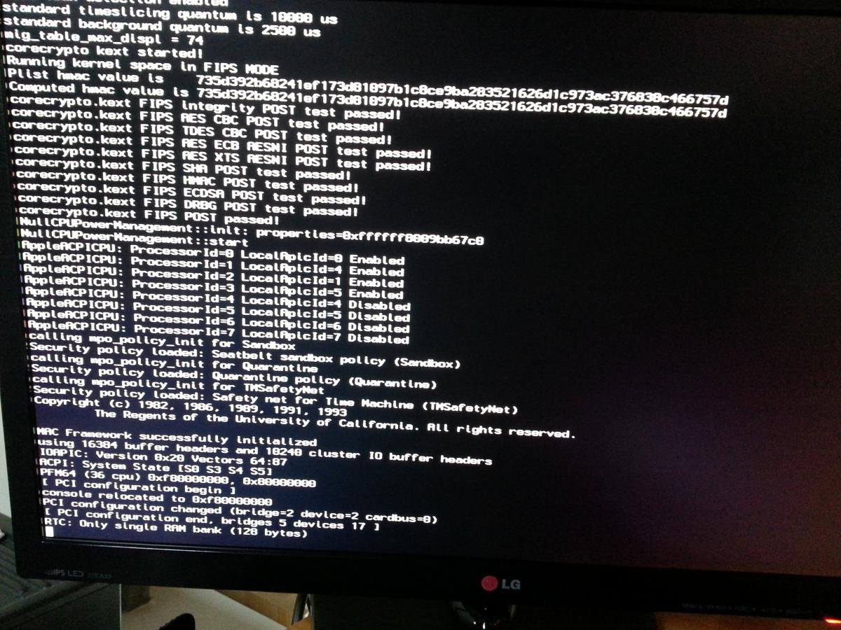

fabio8v Posted June 20, 2013 Share Posted June 20, 2013 ciao sto provando ad installare M/L ma si ferma qui..qualche idea? Link to comment https://www.insanelymac.com/forum/topic/290016-ga-h55n-usb3-i5-4-gb/ Share on other sites More sharing options...
carbo178 Posted June 20, 2013 Share Posted June 20, 2013 -v -x; stacca il disco con windows Link to comment https://www.insanelymac.com/forum/topic/290016-ga-h55n-usb3-i5-4-gb/#findComment-1926051 Share on other sites More sharing options...
fabio8v Posted June 20, 2013 Author Share Posted June 20, 2013 il disco di windows è quello dove voglio installare M/L.. Link to comment https://www.insanelymac.com/forum/topic/290016-ga-h55n-usb3-i5-4-gb/#findComment-1926052 Share on other sites More sharing options...
carbo178 Posted June 20, 2013 Share Posted June 20, 2013 In dual boot o lo vuoi piallare ed usare solo con OS X? Link to comment https://www.insanelymac.com/forum/topic/290016-ga-h55n-usb3-i5-4-gb/#findComment-1926056 Share on other sites More sharing options...
fabio8v Posted June 20, 2013 Author Share Posted June 20, 2013 solo os x Link to comment https://www.insanelymac.com/forum/topic/290016-ga-h55n-usb3-i5-4-gb/#findComment-1926057 Share on other sites More sharing options...
carbo178 Posted June 20, 2013 Share Posted June 20, 2013 OK, allora -v -x GraphicsEnabler=No Link to comment https://www.insanelymac.com/forum/topic/290016-ga-h55n-usb3-i5-4-gb/#findComment-1926060 Share on other sites More sharing options...
fabio8v Posted June 20, 2013 Author Share Posted June 20, 2013 niente..si ferma sempre lì... Link to comment https://www.insanelymac.com/forum/topic/290016-ga-h55n-usb3-i5-4-gb/#findComment-1926062 Share on other sites More sharing options...
carbo178 Posted June 20, 2013 Share Posted June 20, 2013 Che metodo stai usando per l'installazione? Link to comment https://www.insanelymac.com/forum/topic/290016-ga-h55n-usb3-i5-4-gb/#findComment-1926074 Share on other sites More sharing options...
fabio8v Posted June 20, 2013 Author Share Posted June 20, 2013 pennetta my hack Link to comment https://www.insanelymac.com/forum/topic/290016-ga-h55n-usb3-i5-4-gb/#findComment-1926076 Share on other sites More sharing options...
carbo178 Posted June 20, 2013 Share Posted June 20, 2013 Non la conosco, non so che flags dirti di usare; prova PCIRootUID=0 sia con GE=Yes che con No Link to comment https://www.insanelymac.com/forum/topic/290016-ga-h55n-usb3-i5-4-gb/#findComment-1926079 Share on other sites More sharing options...
fabio8v Posted June 20, 2013 Author Share Posted June 20, 2013 con PCIRootUID=0 si blocca prima ecco l'immagine Link to comment https://www.insanelymac.com/forum/topic/290016-ga-h55n-usb3-i5-4-gb/#findComment-1926085 Share on other sites More sharing options...

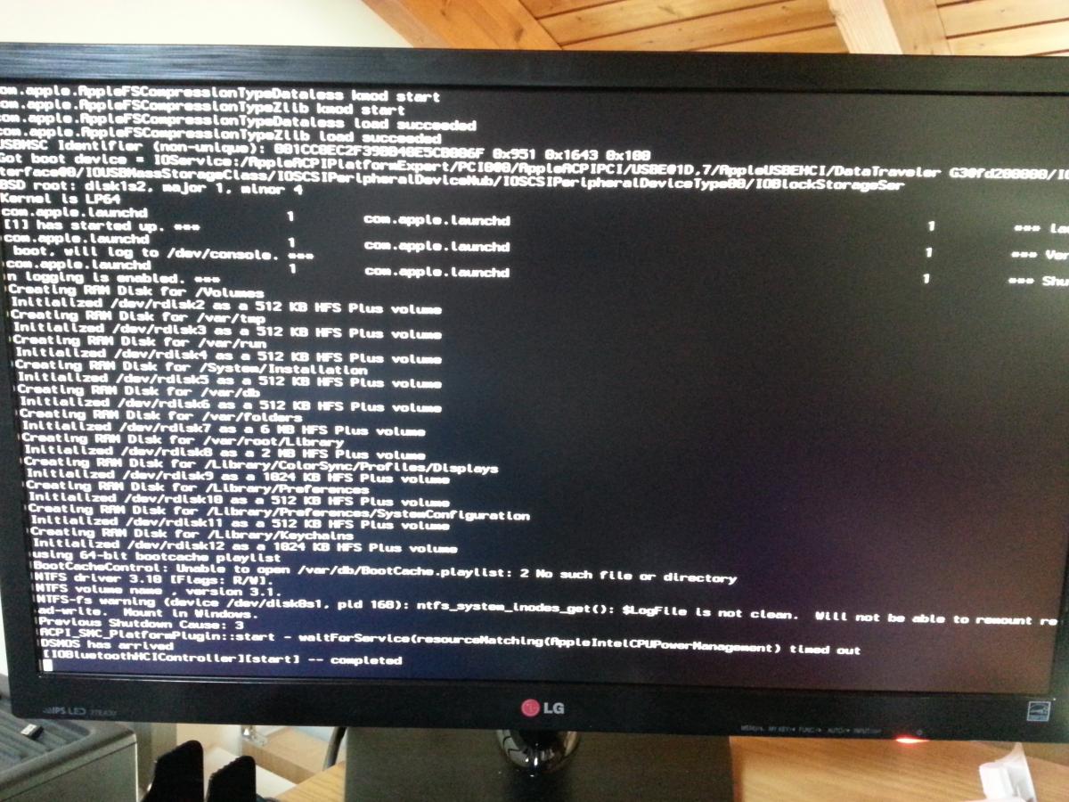

fabio8v Posted June 20, 2013 Author Share Posted June 20, 2013 sono riuscito a partire...ho installato una Nvidia 210, parte solo con: PciRoot=1 GraphicsEnabler=Yes ma il mouse e la tastiera, entrambi usb, non vanno più. Ho provato ad aggiungere altri switches..tipo: npci=0x2000 o npci=0x3000 cpus=1 ma senza risultato...suggerimenti? Link to comment https://www.insanelymac.com/forum/topic/290016-ga-h55n-usb3-i5-4-gb/#findComment-1926121 Share on other sites More sharing options...
fabio8v Posted July 18, 2013 Author Share Posted July 18, 2013 aggiornamento...tolto Nvidia, sono riuscito ad arrivare alla prima schermata, cancellando i kexts video della intel, dove si deve selezionare la lingua ma sia il mouse che la tastiera non funzionano (entrambi usb), cosa posso fare? Link to comment https://www.insanelymac.com/forum/topic/290016-ga-h55n-usb3-i5-4-gb/#findComment-1932969 Share on other sites More sharing options...
fabio8v Posted July 18, 2013 Author Share Posted July 18, 2013 nessuno mi aiuta? Link to comment https://www.insanelymac.com/forum/topic/290016-ga-h55n-usb3-i5-4-gb/#findComment-1932976 Share on other sites More sharing options...
carbo178 Posted July 18, 2013 Share Posted July 18, 2013 Non è che mouse e tastiera siano connessi alle USB3? Perchè in USB2 dovrebbero funzionare regolarmente; al limite guarda nel bios se c'è qualche impostazione per il supporto di tastiera e mouse USB o altri tipi di impostazione per le USB2 Link to comment https://www.insanelymac.com/forum/topic/290016-ga-h55n-usb3-i5-4-gb/#findComment-1932977 Share on other sites More sharing options...
fabio8v Posted July 18, 2013 Author Share Posted July 18, 2013 no..purtroppo sono connessi alla USB2..nessuna porta funziona..ho provato a disabilitare legacy mode...niente...pensavo se potevo cambiare kext.... e meno male che è una Gigabyte...a saperlo prima prendevo una Asus Link to comment https://www.insanelymac.com/forum/topic/290016-ga-h55n-usb3-i5-4-gb/#findComment-1932978 Share on other sites More sharing options...
carbo178 Posted July 18, 2013 Share Posted July 18, 2013 Secondo me è MyHack il problema... hai già un sistema installato su un altro PC? Se si crea una chiavetta con Pandora, se no scarica iAtkosML2 Nel bios imposta HPET a 64bit e i dischi in AHCI Link to comment https://www.insanelymac.com/forum/topic/290016-ga-h55n-usb3-i5-4-gb/#findComment-1932983 Share on other sites More sharing options...
fabio8v Posted July 18, 2013 Author Share Posted July 18, 2013 uso solo myhack..l'ho installato su una decina di computer...portatili e non...nel bios non c'è HPET...e ovviamente i dischi sono in AHCI..altrimenti non caricava nulla Link to comment https://www.insanelymac.com/forum/topic/290016-ga-h55n-usb3-i5-4-gb/#findComment-1933006 Share on other sites More sharing options...

fabio8v Posted July 19, 2013 Author Share Posted July 19, 2013 aggiornamento... se faccio partire il pc con la pennetta e poi scelgo l'hd dove è installato M/L nessun problema...invece se avvio direttamente da hd porte usb non funzionanti... qualche suggerimento? Link to comment https://www.insanelymac.com/forum/topic/290016-ga-h55n-usb3-i5-4-gb/#findComment-1933225 Share on other sites More sharing options...
