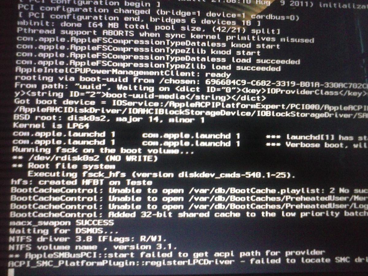

julianolucas Posted July 26, 2013 Author Share Posted July 26, 2013 A grafica tenho quase certeza q tb é compatível estou obtendo sucesso durante a instalaçao ,mas quando eu reinicio em modo verbose ele trava na seguinte mensagem AppleSMBusPCI::start failed to get acpi path for provider Link to comment https://www.insanelymac.com/forum/topic/289788-megaware-black-purple/#findComment-1934762 Share on other sites More sharing options...

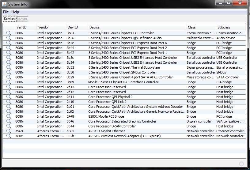

artur_pt Posted July 26, 2013 Share Posted July 26, 2013 olá posta uma foto do system info e do boot -f -v GraphicsEnabler=No bom hack Link to comment https://www.insanelymac.com/forum/topic/289788-megaware-black-purple/#findComment-1934788 Share on other sites More sharing options...

julianolucas Posted July 26, 2013 Author Share Posted July 26, 2013 Agora consegui desculpe ai segue o system info e a foto do boot!!! Link to comment https://www.insanelymac.com/forum/topic/289788-megaware-black-purple/#findComment-1934810 Share on other sites More sharing options...
artur_pt Posted July 26, 2013 Share Posted July 26, 2013 olá teus gráficos vai ser 1 problema mas para já n está a encontrar a fakesmc.. bom hack Link to comment https://www.insanelymac.com/forum/topic/289788-megaware-black-purple/#findComment-1934813 Share on other sites More sharing options...
julianolucas Posted July 26, 2013 Author Share Posted July 26, 2013 EU ESTOU A INSTALAR IATKOS L2 PARA FAZER OS TESTES ATE CONCLUIR O LION RETAIL MAS COMO FAREI PARA INSTALAR A FAKE SMC SE ELE NAO INICIA ?ELE INSTALA COM SUCESSO E DEPOIS PARA NESTA FOTO AÍ ,QUERO LEMBRAR Q EU INSTALEI DUAS VEZES A PRIMEIRA DEIXEI MARCADO A OPÇAO FAKE SMC E NA SEGUNDA INSTALAÇAO NAO DEIXEI MARCADO !!!! Link to comment https://www.insanelymac.com/forum/topic/289788-megaware-black-purple/#findComment-1934816 Share on other sites More sharing options...
artur_pt Posted July 26, 2013 Share Posted July 26, 2013 olá cara tu não lê o k escreve ? maiúsculas para k ? eu vejo bem... fakesmc é indispensável para 1 pc correr mac os x e a nullcpupowermanagement até teres gerenciamento de energia nativo... Pós Instalação bom hack Link to comment https://www.insanelymac.com/forum/topic/289788-megaware-black-purple/#findComment-1934817 Share on other sites More sharing options...
