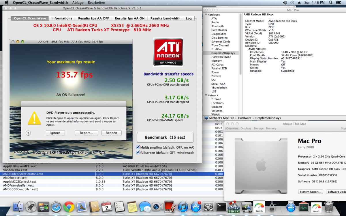

Tinkergnome Posted June 2, 2013 Author Share Posted June 2, 2013 Ok tried that and read a bunch i guess what i am not relaying properly is that the card does work but and does well but things like dvdplayer do not work attached is a screen shot Link to comment https://www.insanelymac.com/forum/topic/288782-mountain-lion-asus-eah6670dis1gd5/#findComment-1919426 Share on other sites More sharing options...
