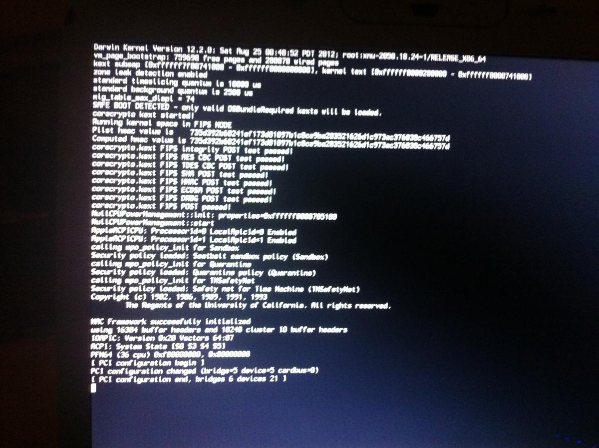

cuccox360 Posted May 2, 2013 Share Posted May 2, 2013 Hi, i'm getting some problems with this laptop .. i just can't get installation : I create a USB drive with ##### and my original copy of Mountain Lion but the screen freeze and the installation stop at PCI Configuration end. This is a photo of the screen i've got .. can anyone help me please? PS: In BIOS i can only change the way of HD , now set in AHCI. Andrea Acer Aspire 5929G : Intel Core 2 Duo T5450 1.66 GHz Memory: 2*2GB RAM Graphics Card: Nvidia GeForce 8600 Forgot to say that i tried also with ###### and last ####### but same results .. is a problem of loader and relative extras/kext missing ? Link to comment https://www.insanelymac.com/forum/topic/288284-ml-1082-on-acer-aspire-5920g/ Share on other sites More sharing options...
iFIRE Posted May 2, 2013 Share Posted May 2, 2013 boot with this flag: -f -v -x GraphicsEnabler=No npci=0x2000 Link to comment https://www.insanelymac.com/forum/topic/288284-ml-1082-on-acer-aspire-5920g/#findComment-1912083 Share on other sites More sharing options...
cuccox360 Posted May 2, 2013 Author Share Posted May 2, 2013 Just tried this flag .. Same results, other way to force only the installation ? Link to comment https://www.insanelymac.com/forum/topic/288284-ml-1082-on-acer-aspire-5920g/#findComment-1912130 Share on other sites More sharing options...
artur_pt Posted May 2, 2013 Share Posted May 2, 2013 hello try to remove all nv*.* from the installer anyway 2 gb of ram for ml.. is little and i don't know if u graphics gonna work ... have u try another mac os x version ? good hack Link to comment https://www.insanelymac.com/forum/topic/288284-ml-1082-on-acer-aspire-5920g/#findComment-1912162 Share on other sites More sharing options...
cuccox360 Posted May 2, 2013 Author Share Posted May 2, 2013 hi artur, the ram is 4 GB, 2*2gb, so the nvidia geforce 8600 i don't know if i will get fully work ... i tried only with ML 10.8.2, now i'm testing other version what do you means with "try to remove all nv*.* from the installer" ? thank you Link to comment https://www.insanelymac.com/forum/topic/288284-ml-1082-on-acer-aspire-5920g/#findComment-1912204 Share on other sites More sharing options...
iFIRE Posted May 2, 2013 Share Posted May 2, 2013 DELETE all NVDA kexts From USBInstaller Nvidia - GeForce.kext - GeForceGA.plugin - GeForceGLDriver.bundle - GeForceVADriver.bundle - NVDAGF100Hal.kext - NVDAGK100Hal.kext - NVDANV50Hal.kext - NVDAResman.kext - NVSMU.kext Link to comment https://www.insanelymac.com/forum/topic/288284-ml-1082-on-acer-aspire-5920g/#findComment-1912206 Share on other sites More sharing options...
gils83 Posted May 2, 2013 Share Posted May 2, 2013 hi artur, the ram is 4 GB, 2*2gb, so the nvidia geforce 8600 i don't know if i will get fully work ... i tried only with ML 10.8.2, now i'm testing other version what do you means with "try to remove all nv*.* from the installer" ? thank you flag : chameleon : npci=0x2000 GraphicsEnabler=Yes flag : Clover : npci=0x2000 GraphicsInjector=Yes Link to comment https://www.insanelymac.com/forum/topic/288284-ml-1082-on-acer-aspire-5920g/#findComment-1912223 Share on other sites More sharing options...
