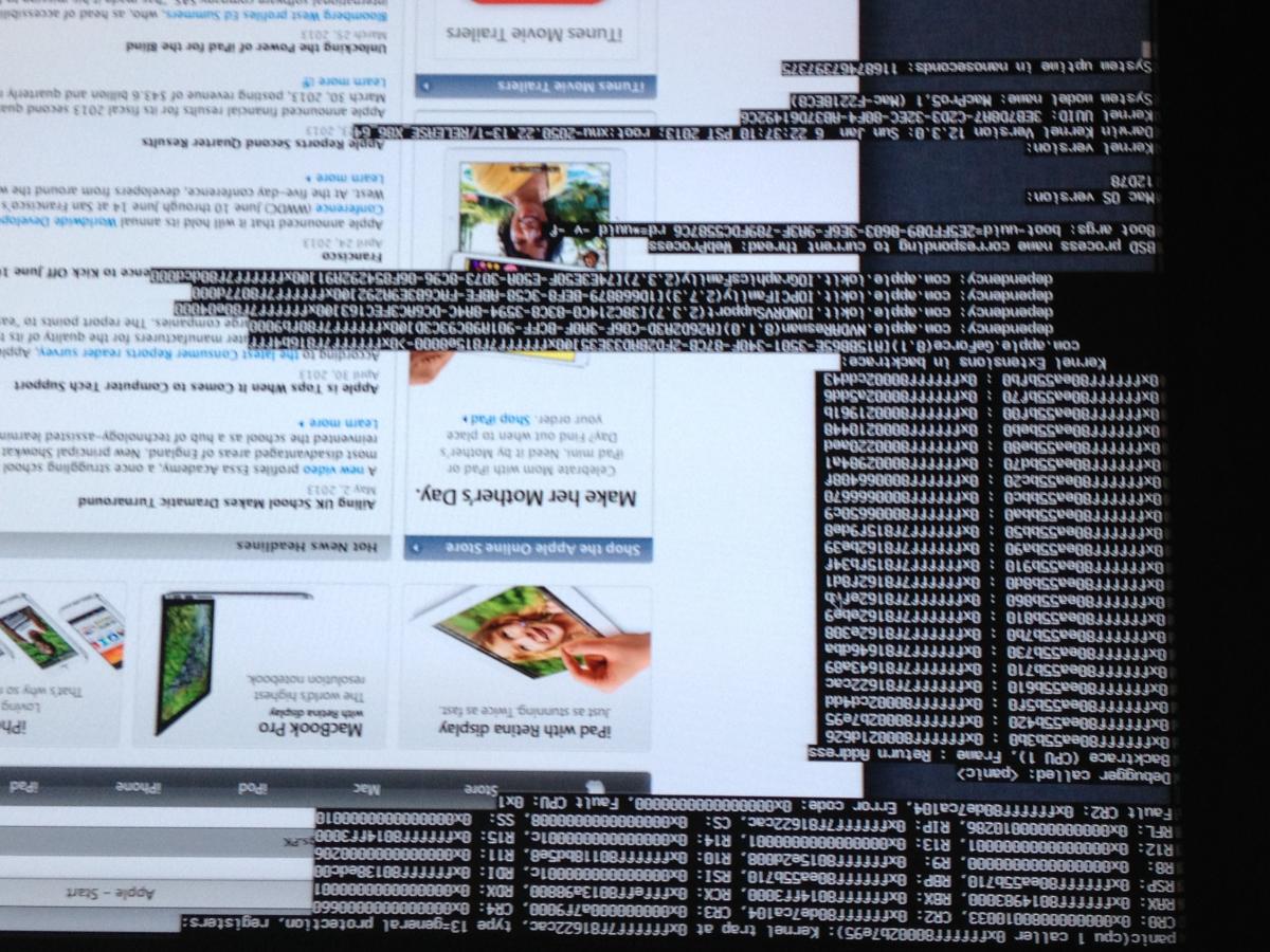

vamose Posted May 5, 2013 Author Share Posted May 5, 2013 K3nny, please refer to the attached KP that I am constantly being greeted with, since I have started using the SSDT file. The DSDT and SSDT files being currently used are also attached. KP Screen shot.zip DSDT.dsl.zip SSDT.aml.zip Link to comment https://www.insanelymac.com/forum/topic/287914-dsdt-intel%C2%AE-desktop-board-dh55hc/page/3/#findComment-1912938 Share on other sites More sharing options...
k3nny Posted May 5, 2013 Share Posted May 5, 2013 As you can read at "Kernel extensions at backtrace", the KP is related to the Nvidia. If you are sure it only happens with the custom SSDT, you should switch back to Chameleon's state generator. As long as you got a low frequency and the highest one your CPU supports, plus a low voltage when the CPU is idling, everything should be fine. The adapter problem most probably cannot be solved with a DSDT. Link to comment https://www.insanelymac.com/forum/topic/287914-dsdt-intel%C2%AE-desktop-board-dh55hc/page/3/#findComment-1912972 Share on other sites More sharing options...

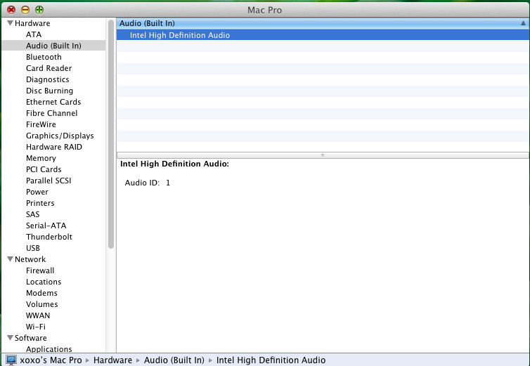

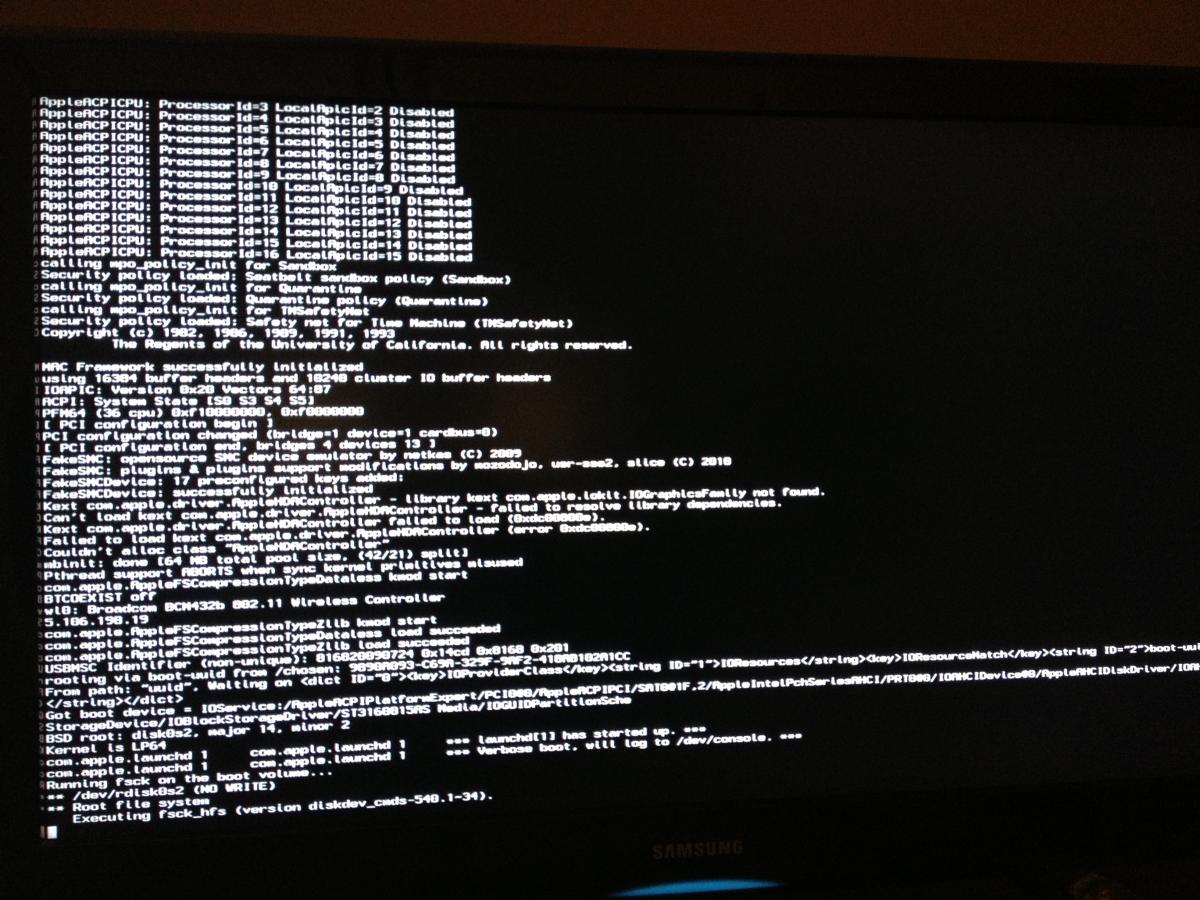

vamose Posted May 7, 2013 Author Share Posted May 7, 2013 K3nny, need your help. Please refer to the error message stating - issue with com.apple.driver.ApplheHDAController Can't load kext com.apple.driver.AppleHDAController - failed to resolve library dependencies. Kext com.apple.driver.AppleHDAController failed to load (0xdc00800e). NO SOUND? system profile shows single Intel HD audio - 1. Please refer to the attached error message Link to comment https://www.insanelymac.com/forum/topic/287914-dsdt-intel%C2%AE-desktop-board-dh55hc/page/3/#findComment-1913444 Share on other sites More sharing options...
