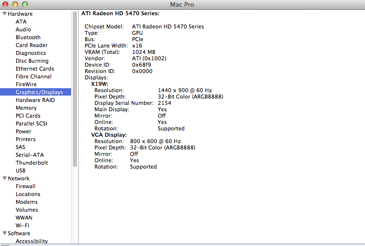

chipper36 Posted April 11, 2013 Share Posted April 11, 2013 Hi totally new to mac and i'm really struggling trying to install Graphics card correctly. I cannot seem to show the card as a ATI Radeon HD 5450 The closest i have come to is a 5400 series. I've tried custom kexts, editing my own kexts and tried injecting code into the DSDT.aml Also i have tried on another PC with a HD 6770 with similar problems. I have tried various frame buffer settings Eulemur Hoolock etc.. but failing each time on both PCS! I'm using iAtkos ML2 (could this be hampering me?) Asrock G31-M S R2.0 E8400 CPU Please help if you can, my main goal is to eventually dual boot Win7/Mac on my Media Centre PC with working HDMI Audio. Regards 575] ATI Radeon HD 5000: 575] Chipset Model: ATI Radeon HD 5000 575] Type: GPU 575] Bus: PCIe 575] PCIe Lane Width: x16 575] VRAM (Total): 1024 MB 575] Vendor: ATI (0x1002) 575] Device ID: 0x68f9 575] Revision ID: 0x0000 575] Displays: 9] X19W: 9] Resolution: 1440 x 900 @ 60 Hz 9] Pixel Depth: 32-Bit Color (ARGB8888) 9] Display Serial Number: 2154 9] Main Display: Yes 9] Mirror: Off 9] Online: Yes 9] Rotation: Supported Quote Link to comment https://www.insanelymac.com/forum/topic/287822-ati-radeon-hd-5450-1002-68f9-advise-please/ Share on other sites More sharing options...
theconnactic Posted April 12, 2013 Share Posted April 12, 2013 You need to insert the device ID to the plists of ATI5000Controller.kext and AMDRadeonAccelerator.kext (under Cedar). The correct format you're going to insert is 0x68F91002. Good luck! Quote Link to comment https://www.insanelymac.com/forum/topic/287822-ati-radeon-hd-5450-1002-68f9-advise-please/#findComment-1906061 Share on other sites More sharing options...

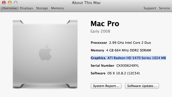

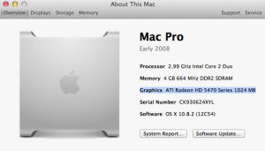

chipper36 Posted April 12, 2013 Author Share Posted April 12, 2013 (edited) Hi theconnactic, thx for the reply. I,ve done that, could you check over it please. Regards https://www.dropbox..../5450_kexts.zip Getting nearer i think as its now showing: Graphics ATI Radeon HD 5470 Series 1024 MB 5450_kexts.zip Edited April 12, 2013 by chipper36 Quote Link to comment https://www.insanelymac.com/forum/topic/287822-ati-radeon-hd-5450-1002-68f9-advise-please/#findComment-1906084 Share on other sites More sharing options...
theconnactic Posted April 12, 2013 Share Posted April 12, 2013 Yes, it's right. Then boot with GraphicsEnabler=No (it won't give you QE/CI, but will enable you to do the next fix) and open DiskUtility and repair permissions. Then reboot and boot with GraphicsEnabler=Yes PCIRootUID=0 DSDT=No Quote Link to comment https://www.insanelymac.com/forum/topic/287822-ati-radeon-hd-5450-1002-68f9-advise-please/#findComment-1906086 Share on other sites More sharing options...
chipper36 Posted April 12, 2013 Author Share Posted April 12, 2013 Thx again, i'll do that now A little bit closer 1 Quote Link to comment https://www.insanelymac.com/forum/topic/287822-ati-radeon-hd-5450-1002-68f9-advise-please/#findComment-1906087 Share on other sites More sharing options...

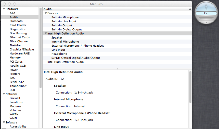

chipper36 Posted April 12, 2013 Author Share Posted April 12, 2013 1) Can you watch movies (Youtube, Quicktime) without or with negligible lag? YES 2) When you click on Launchpad, does it open fast and runs smoothly? YES 3) The menubar on the top, is it translucent? YES i think lol 4) can you play any games? Dunno i don't play games lol (inbuilt Chess works) So tomorrow i will stick it on main TV and see if theres any sound from amp. Thanks again for all your help so far, i was starting to think Mac wasn't worth the effort but i must admit i am really starting to like it :-) Screenshot of my sound but i'm not getting any via monitor. Quote Link to comment https://www.insanelymac.com/forum/topic/287822-ati-radeon-hd-5450-1002-68f9-advise-please/#findComment-1906093 Share on other sites More sharing options...
