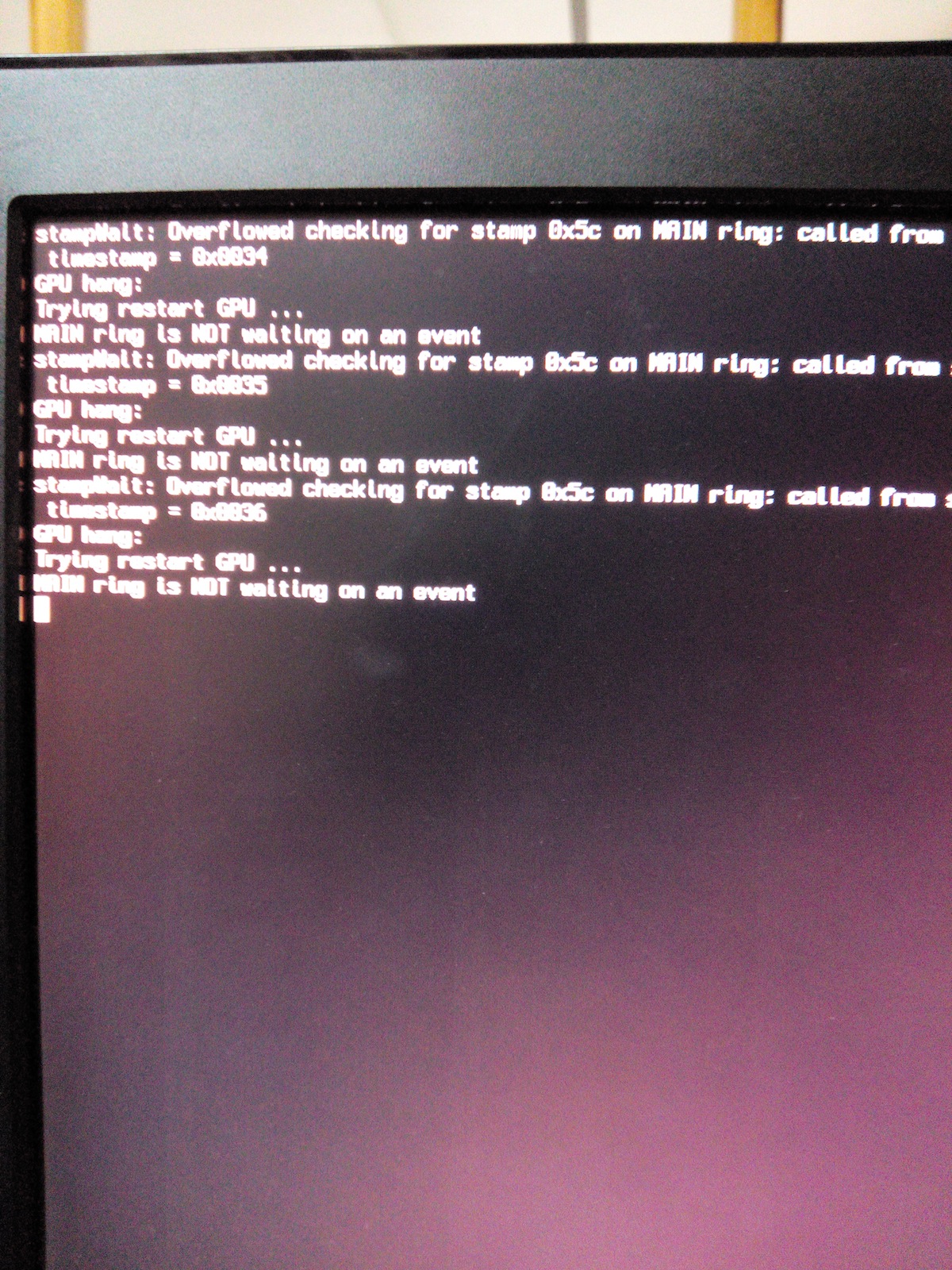

Dr. Hurt Posted August 11, 2013 Author Share Posted August 11, 2013 Hi, I'm pretty frustrated. Since 3 days I already try to get my Hackintosh up and running. I've got a Gigabyte GA-H77N-WIFI Motherboard with an Intel Core i3-3220T (with an Intel HD 2500). When I boot up Mac OS X 10.8.4 with the parameter "-x" then I can see the desktop. But as soon as I start without the "-x" parameter, my Hackintosh stops at "macx_swapon". Can someone help me in getting rid of this error? I already tried the things you mentioned here. I also read that I have to set the graphic memory to 32M!? Well, unfortunately it doesn't work for everyone. I have yet to find out why. Could you please upload your DSDT and I'll try patching it for you. Link to comment https://www.insanelymac.com/forum/topic/287668-guide-intel-hd2500-full-resolution-and-qeci-1083/page/2/#findComment-1938282 Share on other sites More sharing options...

Dr. Hurt Posted August 11, 2013 Author Share Posted August 11, 2013 Here's your DSDT fully patched for your mobo, not just graphics. I also included an SSDT for your CPU. Use Chameleon Wizard to disable Graphics Enabler and dropSSDT. Set memory to 32MB in BIOS/UEFI. Try with SMBIOS set to Macmini6,2 and iMac13,2 Try the DSDT.aml. If it doesn't work, try the other ones by renaming them to DSDT. Please, if possible, upload an ioreg with every DSDT you try. TEST.zip 1 Link to comment https://www.insanelymac.com/forum/topic/287668-guide-intel-hd2500-full-resolution-and-qeci-1083/page/2/#findComment-1938335 Share on other sites More sharing options...

Dr. Hurt Posted August 12, 2013 Author Share Posted August 12, 2013 @Lacedaemon, I added a new platform-id in bennyn's DSDT. Lets see how how that works. Link to comment https://www.insanelymac.com/forum/topic/287668-guide-intel-hd2500-full-resolution-and-qeci-1083/page/2/#findComment-1938429 Share on other sites More sharing options...
bennyn Posted August 12, 2013 Share Posted August 12, 2013 Thank you for the new DSDT file. I will try it now... To install it I will place the DSDT.aml file on my desktop and then select "UserDSDT or DSDT-Free Installation" in MutiBeast. Is that right? To save the IOReg information I need to install the "Apple Developer Tools" which come with Xcode, right? Link to comment https://www.insanelymac.com/forum/topic/287668-guide-intel-hd2500-full-resolution-and-qeci-1083/page/2/#findComment-1938552 Share on other sites More sharing options...
Dr. Hurt Posted August 12, 2013 Author Share Posted August 12, 2013 No. Just place the DSDT and SSDT in the /Extra folder on your OS X partition. Download Chameleon wizard (google it), and use it to set SMBIOS (imac or macmini) and dropSSDT. Forget about the ioreg for now. Link to comment https://www.insanelymac.com/forum/topic/287668-guide-intel-hd2500-full-resolution-and-qeci-1083/page/2/#findComment-1938556 Share on other sites More sharing options...

bennyn Posted August 13, 2013 Share Posted August 13, 2013 Thanks for the help again! I set SMBIOS to "Mac mini6,2" and I used the following Boot.plist: <?xml version="1.0" encoding="UTF-8"?><!DOCTYPE plist PUBLIC "-//Apple//DTD PLIST 1.0//EN" "http://www.apple.com/DTDs/PropertyList-1.0.dtd"><plist version="1.0"><dict> <key>DropSSDT</key> <string>Yes</string> <key>EthernetBuiltIn</key> <string>Yes</string> <key>GenerateCStates</key> <string>Yes</string> <key>GeneratePStates</key> <string>Yes</string> <key>GraphicsEnabler</key> <string>No</string> <key>Graphics Mode</key> <string>1920x1080x32</string> <key>Kernel</key> <string>mach_kernel</string> <key>Kernel Flags</key> <string>darkwake=0</string> <key>Legacy Logo</key> <string>Yes</string> <key>Timeout</key> <string>2</string> <key>UseKernelCache</key> <string>Yes</string></dict></plist> After that I tried to boot with the three different DSDT.aml files but none of them worked.Results:DSDT.amlDSDT2.amlDSDT3.aml Are there any other options? Or should I buy an Intel Core i3-3225 (with Intel HD 4000)? Link to comment https://www.insanelymac.com/forum/topic/287668-guide-intel-hd2500-full-resolution-and-qeci-1083/page/2/#findComment-1938635 Share on other sites More sharing options...
Dr. Hurt Posted August 13, 2013 Author Share Posted August 13, 2013 Thanks for the help again! I set SMBIOS to "Mac mini6,2" and I used the following Boot.plist: After that I tried to boot with the three different DSDT.aml files but none of them worked. Results: DSDT.aml DSDT2.aml DSDT3.aml Are there any other options? Or should I buy an Intel Core i3-3225 (with Intel HD 4000)? Unfortunately, I don't think it'll work. Before giving up, try deleting all AppleIntelHD3000* and AppleIntelSNB* kexts from /System/Library/Extensions/ and boot with -f. Only try with the first DSDT this time. If you have the option to get a CPU with an HD4000, do so. It works very well with OS X. EDIT: I think I found out why the frambuffer was failing to load. There was a missing id. Give this last DSDT a try. DSDT.zip 1 Link to comment https://www.insanelymac.com/forum/topic/287668-guide-intel-hd2500-full-resolution-and-qeci-1083/page/2/#findComment-1938641 Share on other sites More sharing options...

bennyn Posted August 13, 2013 Share Posted August 13, 2013 EDIT:I think I found out why the frambuffer was failing to load. There was a missing id. Give this last DSDT a try. Okay. I'll try it once I'm home! I've been thinking about buying a new graphics card because it is cheaper than a new CPU. Or could I have then still problems with my CPU? The Geforce GT 610 & GT 620 series is quite cheap. I just have to find out if the Asus GT610-SL-1GD3-L or Asus GT620-DCSL-2GD3 is compatible... 1 Link to comment https://www.insanelymac.com/forum/topic/287668-guide-intel-hd2500-full-resolution-and-qeci-1083/page/2/#findComment-1938738 Share on other sites More sharing options...
Dr. Hurt Posted August 13, 2013 Author Share Posted August 13, 2013 Okay. I'll try it once I'm home! I've been thinking about buying a new graphics card because it is cheaper than a new CPU. Or could I have then still problems with my CPU? The Geforce GT 610 & GT 620 series is quite cheap. I just have to find out if the Asus GT610-SL-1GD3-L or Asus GT620-DCSL-2GD3 is compatible... You won't have problems with the CPU. AFAIK, both cards should work. Have a look here to see exactly what works and how. http://wiki.osx86project.org/wiki/index.php/Main_Page 1 Link to comment https://www.insanelymac.com/forum/topic/287668-guide-intel-hd2500-full-resolution-and-qeci-1083/page/2/#findComment-1938739 Share on other sites More sharing options...

bennyn Posted August 16, 2013 Share Posted August 16, 2013 Hey! I just want to inform you that I bought a Sapphire Radeon HD 6670 Ultimate (1GB GDDR5) and it works great! I have not changed my installation and simply plugged in the graphics card. It was immediately recognized and has worked out of the box. I can recommend my graphics card to all the HD2500 injured. The Sapphire Radeon HD 6670 Ultimate is worth its price, passively cooled and even has a display port!! However, thank you Dr. Hurt for your help!! This has greatly encouraged and built up. Link to comment https://www.insanelymac.com/forum/topic/287668-guide-intel-hd2500-full-resolution-and-qeci-1083/page/2/#findComment-1939104 Share on other sites More sharing options...
