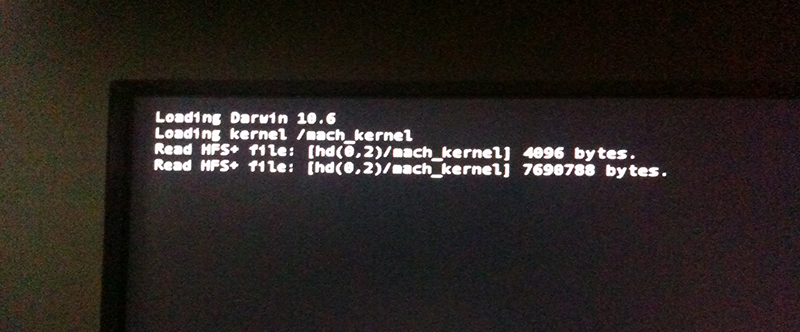

xj0hnx Posted March 23, 2013 Author Share Posted March 23, 2013 Ok, so when I boot off the hdd I get to the chameleon boot loader, I select OSX "boot verbose", and then it hangs here ... Link to comment https://www.insanelymac.com/forum/topic/287111-want-to-clean-up-system-and-switch-to-chameleon/#findComment-1900151 Share on other sites More sharing options...
3.14r2 Posted March 23, 2013 Share Posted March 23, 2013 Make sure there is an /Extra (with all the appropriate content inside) folder on the same partition where Cahmeleon is installed. Link to comment https://www.insanelymac.com/forum/topic/287111-want-to-clean-up-system-and-switch-to-chameleon/#findComment-1900215 Share on other sites More sharing options...

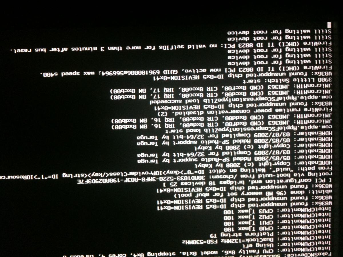

xj0hnx Posted March 24, 2013 Author Share Posted March 24, 2013 Ok, turns out I wasn't installing it on the right partition, it was going on disc1,1 and should have been on 1,2. So now it's on the right partition, but it keeps stopping at FireWire (OHCI) PCI now active GUID xxxxxxxx max speed s400 But then stalls and says Still waiting for root device It does that three times and then does the FireWire line again and then just loops Here's a picture Link to comment https://www.insanelymac.com/forum/topic/287111-want-to-clean-up-system-and-switch-to-chameleon/#findComment-1900276 Share on other sites More sharing options...
3.14r2 Posted March 24, 2013 Share Posted March 24, 2013 The screenshot is turned upside down "Still waiting..." Indicates that there is no driver for the disk controller your MB has, present in OS X, so it is unable to see the disks. Link to comment https://www.insanelymac.com/forum/topic/287111-want-to-clean-up-system-and-switch-to-chameleon/#findComment-1900401 Share on other sites More sharing options...
xj0hnx Posted March 24, 2013 Author Share Posted March 24, 2013 The screenshot is turned upside down "Still waiting..." Indicates that there is no driver for the disk controller your MB has, present in OS X, so it is unable to see the disks. But it boots with the disc, is it something I can install? Haha yea, I was posting from my phone, I didn't want to hook everything back up while troubleshooting just to post. Link to comment https://www.insanelymac.com/forum/topic/287111-want-to-clean-up-system-and-switch-to-chameleon/#findComment-1900503 Share on other sites More sharing options...

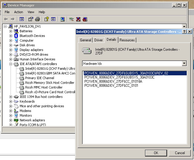

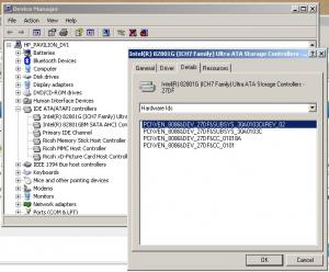

3.14r2 Posted March 24, 2013 Share Posted March 24, 2013 You need to install to install LegacyAppleIntelPIIXATA.kext (make sure that drvice/vendor IDs of the controller are present in the Info.plist file of the above kext) if you have an Intel chipset, or other kext if you have nvidia or any other chipset. You can get the IDs via Windows (Device manager > device properties > hardware ID) or via Linux using lspci tool in terminal like: sudo lspci -vnn > ~/Desktop/lspci.txt this should create lspci txt file on the desktop. Link to comment https://www.insanelymac.com/forum/topic/287111-want-to-clean-up-system-and-switch-to-chameleon/#findComment-1900549 Share on other sites More sharing options...
xj0hnx Posted March 24, 2013 Author Share Posted March 24, 2013 Where can I read how to ad the ID's to the kext? And I am guessing I need to install the ID's from Device Manager > IDE ATA/ATAPI controllers > Intel® ICH10 Family 6 Port SATA AHCI Controller - 3A22? Or Standard ACH1.0 Serial ATA Controller Link to comment https://www.insanelymac.com/forum/topic/287111-want-to-clean-up-system-and-switch-to-chameleon/#findComment-1900582 Share on other sites More sharing options...
3.14r2 Posted March 25, 2013 Share Posted March 25, 2013 ICH10 IS supported in OS X.OOB (used in Mac Pro). Check SATA mode in BIOS. It should be set to AHCI (not compatible/legacy) otherwise native support won't work. The LegacyAppleIntelPIIXATA.kext is mostly used for older systems (ICH5/ICH6) so not needed here (unless you want the controller to work in compatible/legacy mode). Some motherboards have two SATA/IDE controllers. One for instance may be ICH7 (Intel), the other one for instance could be ASMedia/JMicron. If, for instance, your OS X disk is connected to ASMedia controller, you would need driver for ASMedia controller. So check what controllers your motherboard has and which controller OS X disk is connected to. Link to comment https://www.insanelymac.com/forum/topic/287111-want-to-clean-up-system-and-switch-to-chameleon/#findComment-1900608 Share on other sites More sharing options...
