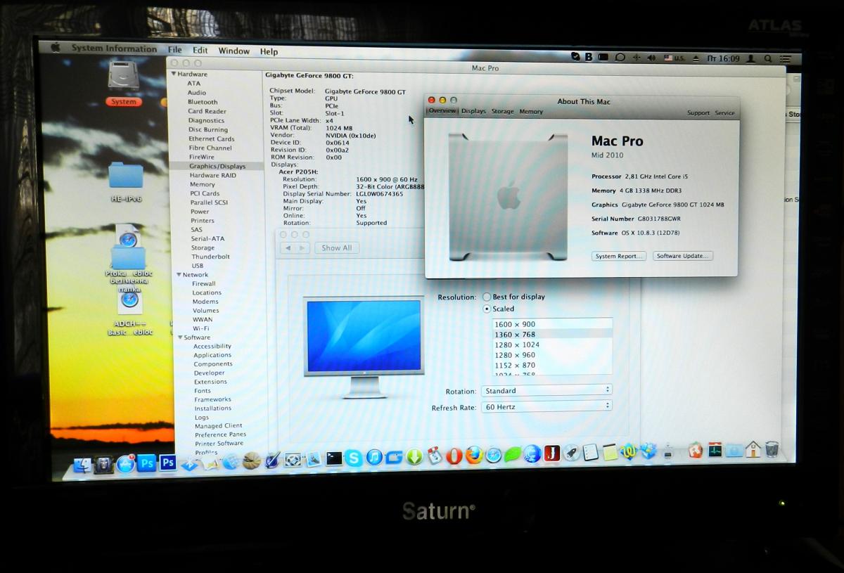

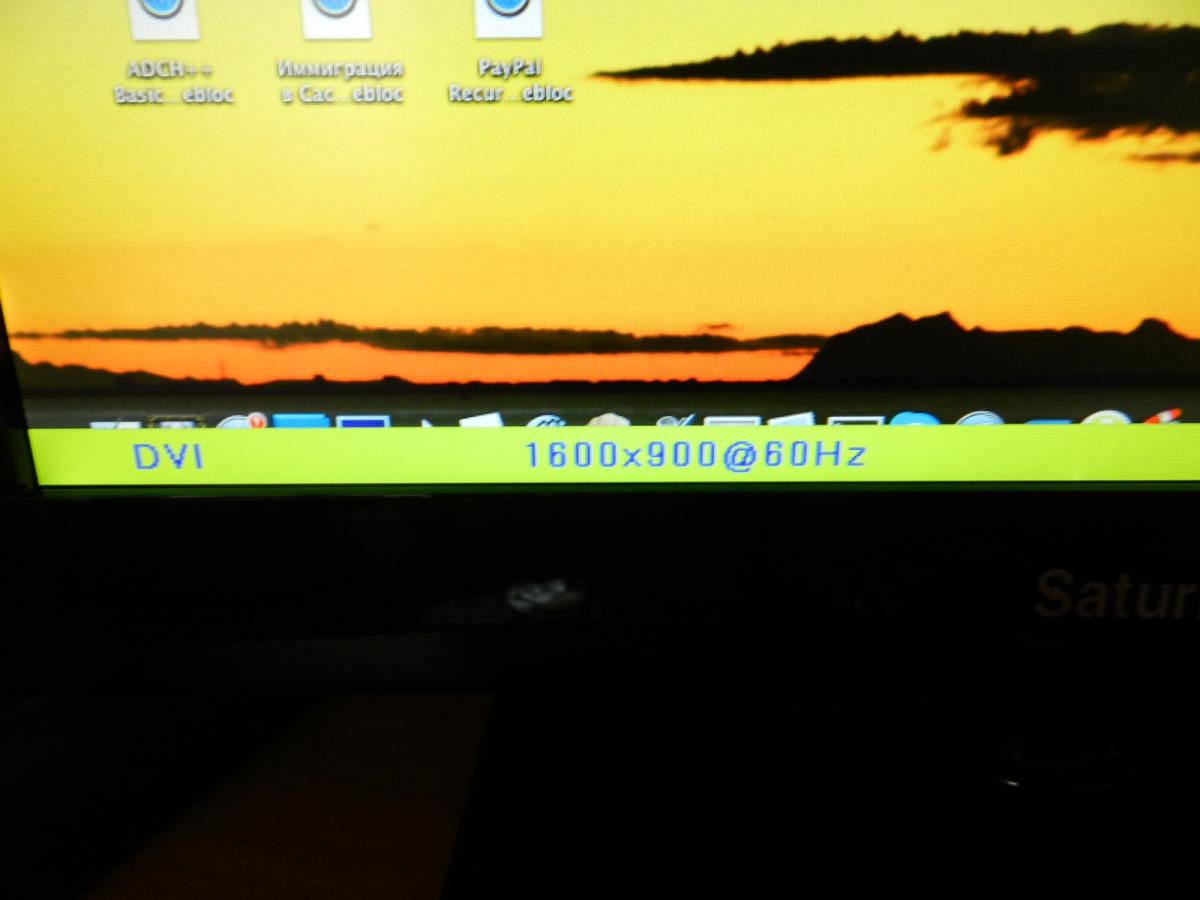

Neolo Posted March 16, 2013 Author Share Posted March 16, 2013 I just got HDMI working for my TV... accidentally on 9800GT Not fully but at least something. What I did: !!!! Upgraded to 10.8.3->Got headache with NVenabler->went in -s and removed it ->booted with GraphicsEnabler (My PC monitor was connected with DVI cable to HDMI port via HDMI to DVI converter, because I broke DVI port on graphics card) -> I decided to plug out PC monitor and connect TV into HDMI port with HDMI-HDMI cable (without converters). And voila, TV detected signal as DVI (1600x900 @ 60) and I can see desktop there. Major problems: - No sound, certainly (pointing on S-Pdif or HDMI in sound settings does nothing). - TV remains detected as my PC monitor, but I able to set proper resolution for it in system settings. - After reboot cable replugging with PC monitor+converter required, TV can't be detected itself. I think it's EDID issue, or TV doesn't send anything to OSX to be detected. Big step forward, but I need help to make it usable. Here is some photos attached. Any help will be appreciated. 1 Link to comment https://www.insanelymac.com/forum/topic/286988-gigabyte-9800gt-silent-cell-hdmi-1082/#findComment-1897412 Share on other sites More sharing options...
