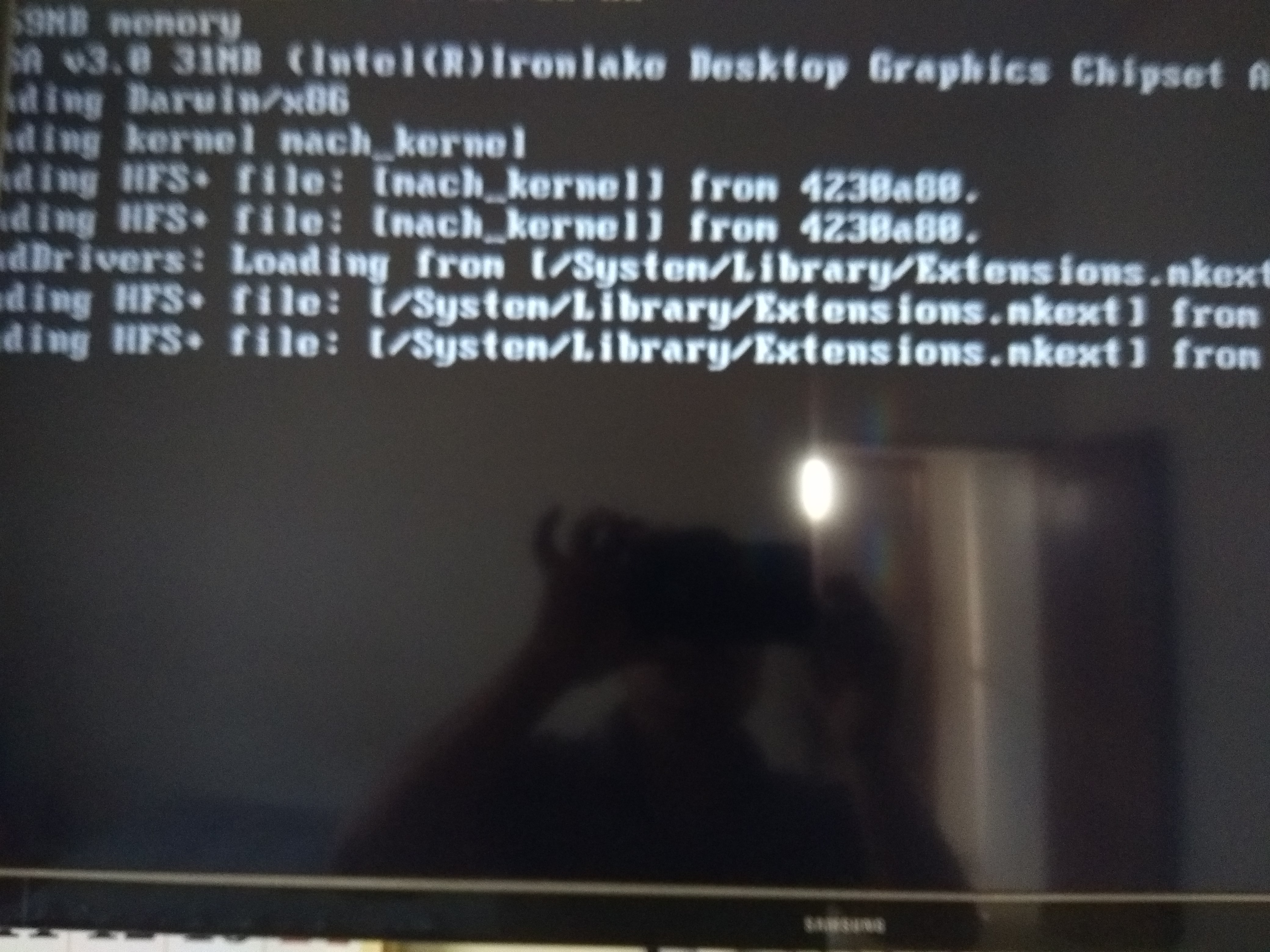

and this image is the result of boot with
-f -x -v UseKernelCache=No

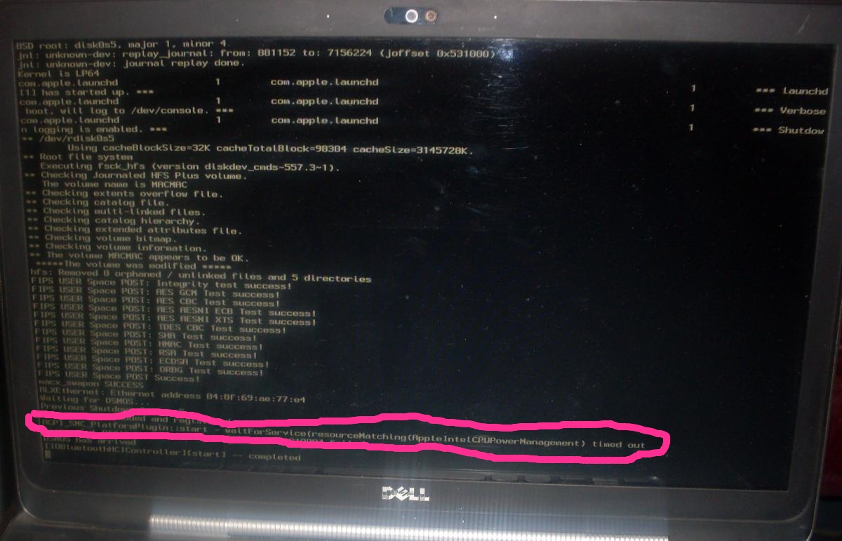

I don't think you can use your Nvidia GPU with this setup, or at least without much more config and DSDT. You'll see Nvidia kext loading is the 5th from the bottom in all those pictures. Remove it and it's Nvidia friends. reboot with -x -f -v and hope for screen image but poor resolution. Then work on making Intel iGPU work (you'll need to replace any intel kexts removed) There are some who know laptop GPU's very well like artur-pt who would know for sure which gpu can work and which cannot.

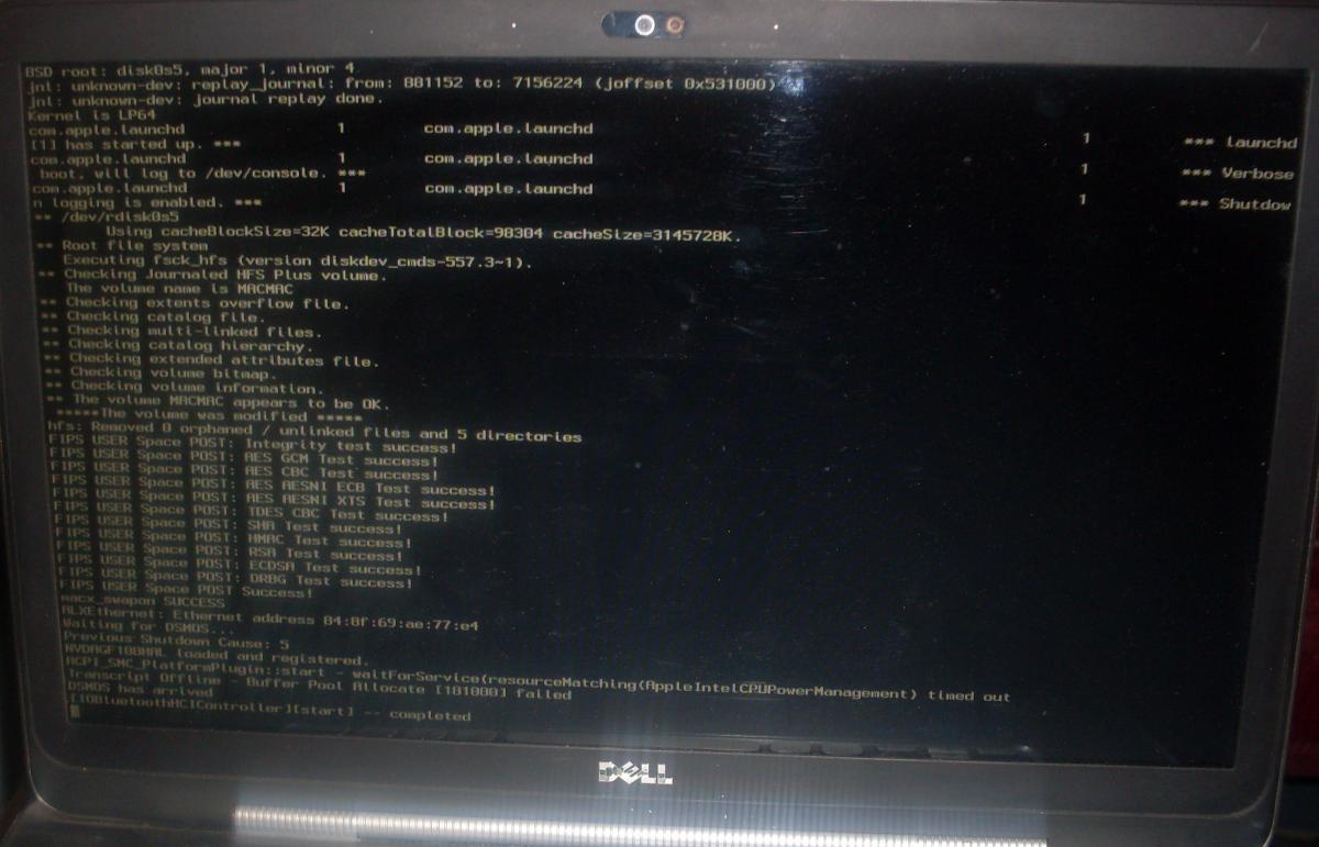

and after boot from partition with
this is the freeze
i don't know which files exactly i supposed to delete
i can access now macdrive
Also when boot with just -v
it gives me
still waiting for root device
you can try: any video settings in bios; GraphicsEnabler=No; plugging in external monitor
What your seeing is not frozen, the desktop has now loaded but you just can't see it

your problem is what you not have delete all kexts NVDA, in your screnshot I see NVDGF100Hal.kext load an registered

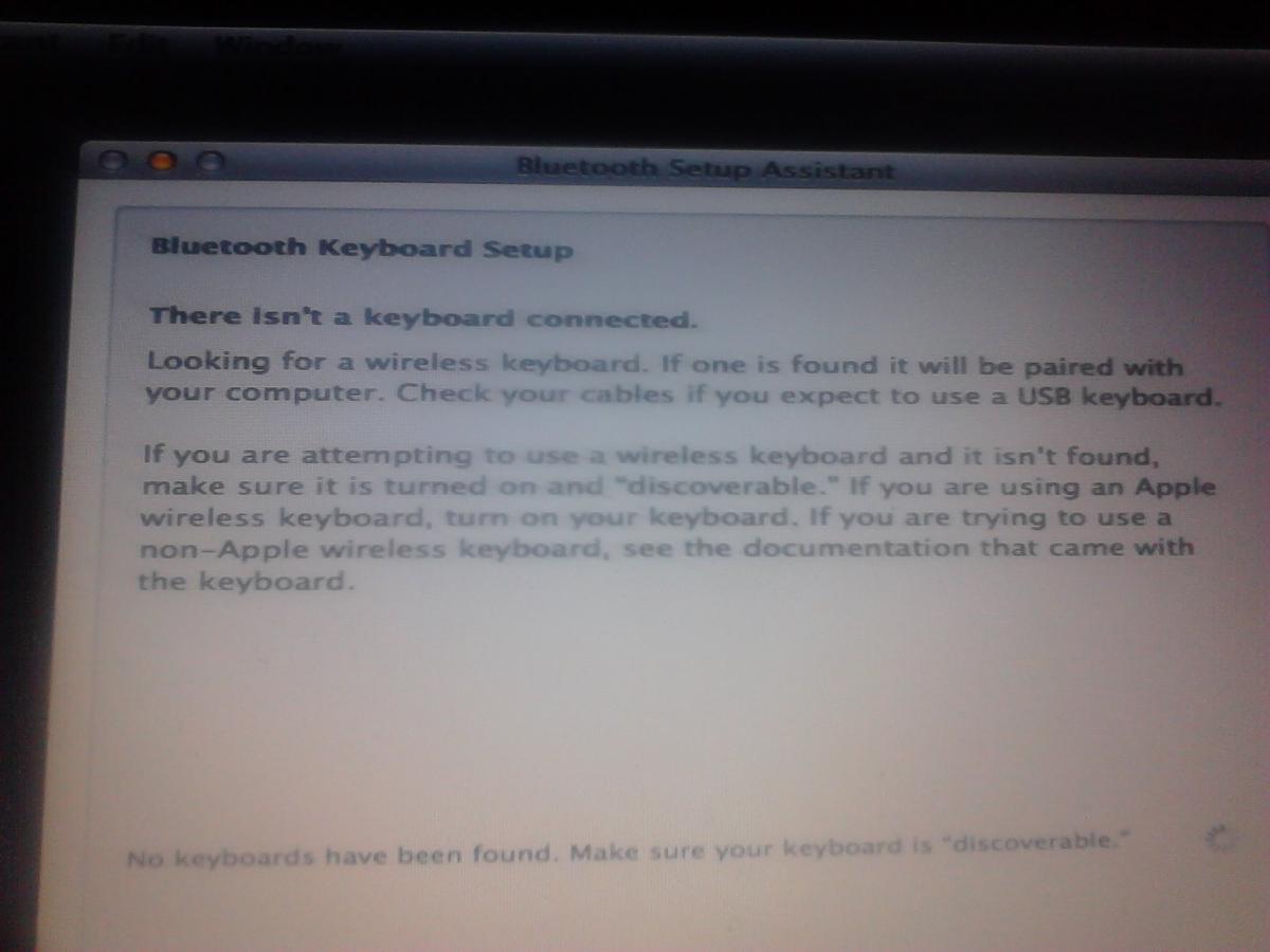

the problem now that keyboard and mouse don't work to complete instillation
thanks with your help i completed the instillation :)
by delete AppleHPET.kext from /System/Library/Extensions/
and put the attached kexts in /System/Library/Extensions/
but only the keyboard works till finish instillation and log in OS !!
but after log in still mouse and keyboard not working !!
and this message appears to me
and second problem is i can log in the OS but in safe boot only !
i can't log in normally with out boot flag (-x)
any help please !!!
