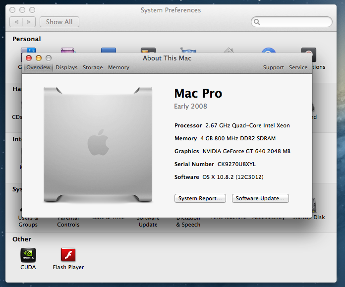

defuse Posted February 23, 2013 Share Posted February 23, 2013 Hi, I just installed a Gigabyte GT 640 on a GA-EP45-UD3P motherboard. I have the drivers installed through nVidia and everything seems to be working. I'm currently running it through dual dispaly (HDMI + DVI). Well is there some sort of test like Prime 95 or something to know that my card works fine or I will just have to find an issue down the road and fix it? Link to comment https://www.insanelymac.com/forum/topic/286586-test-to-find-out-is-my-video-card-works-100/ Share on other sites More sharing options...
WhatTheTech Posted February 23, 2013 Share Posted February 23, 2013 Well the general test to see if QE/CI is working is documented here. I believe that the same test applies for Mountain Lion. This is the main issue with graphics card on a hackintosh. Prime95 is a stress tester, and won't give you much information beyond whether your system is stable. Some other general tests: 1) Check System Information to make sure that everything looks good in the graphics department. 2) In System Preferences, take a look at "Display(s)" and see what resolution options you have. If you're running a 1920x1080 monitor and OSX is displaying at this res, this is a good sign all is right. 3) Try playing a DVD. Any playback issues? 4) Try installing Steam for Mac and give one of their demos a try. Gaming performance on OSX will almost certainly be less than what it is on Windows, but it's worth a shot. The above tests are good for general info - apart from OSX updates you don't need to worry too much about issues down the road. Hope this helps! Link to comment https://www.insanelymac.com/forum/topic/286586-test-to-find-out-is-my-video-card-works-100/#findComment-1891500 Share on other sites More sharing options...
defuse Posted February 24, 2013 Author Share Posted February 24, 2013 Thanks! The ripple effect works fine so QE/CI works. The DVD player wont launch but I think there is a tutorial on how to fix it. Link to comment https://www.insanelymac.com/forum/topic/286586-test-to-find-out-is-my-video-card-works-100/#findComment-1891569 Share on other sites More sharing options...
