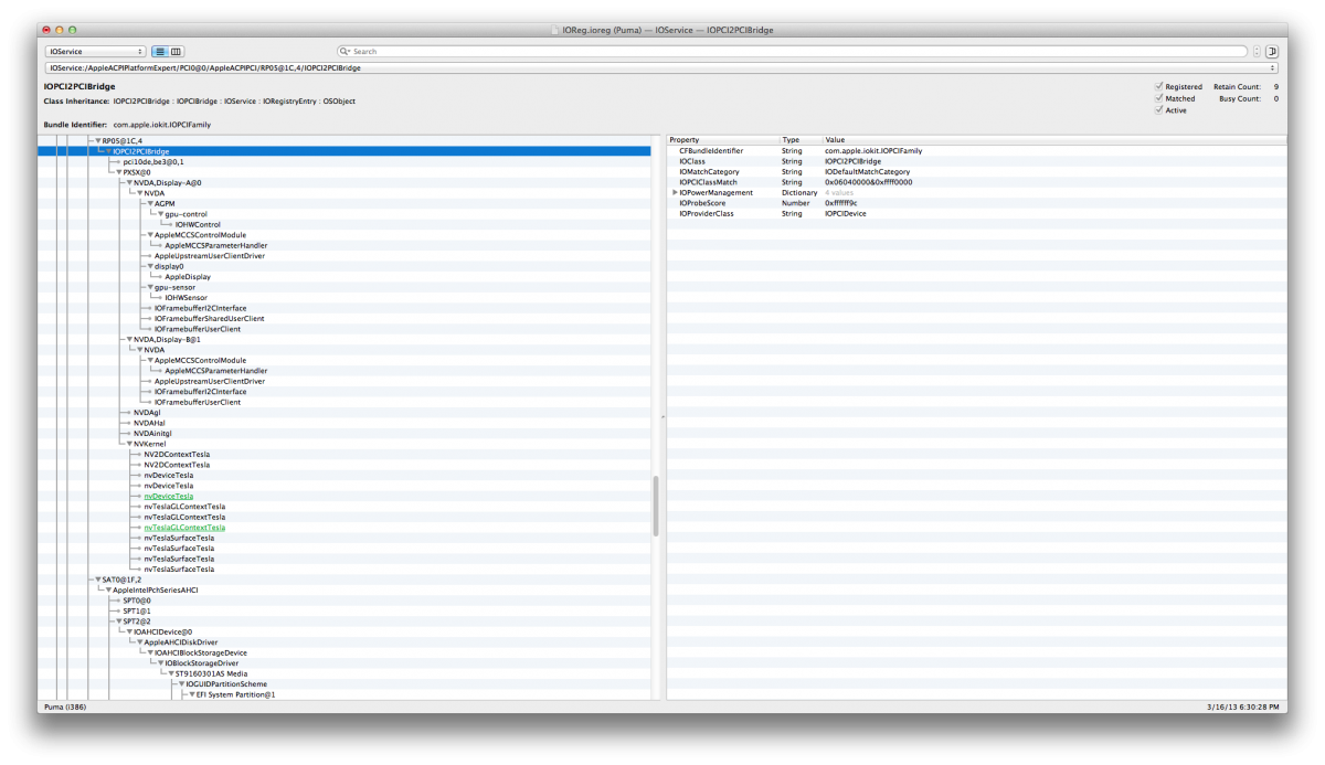

theconnactic Posted March 16, 2013 Author Share Posted March 16, 2013 Hi, Rampage! Done with the IOReg! Where do i find Driver-IST? Here's a screenshot: And IOReg itself: IOReg.ioreg.zip Best regards! Link to comment https://www.insanelymac.com/forum/topic/286474-about-using-discrete-and-integrated-graphics-at-the-same-time/page/2/#findComment-1897641 Share on other sites More sharing options...
Rampage Dev Posted March 17, 2013 Share Posted March 17, 2013 Under GFX0 for that card... Click on there and then its on the right side. Link to comment https://www.insanelymac.com/forum/topic/286474-about-using-discrete-and-integrated-graphics-at-the-same-time/page/2/#findComment-1897731 Share on other sites More sharing options...
theconnactic Posted March 17, 2013 Author Share Posted March 17, 2013 Found it -> IOService:/AppleACPIPlatformExpert/PCI0@0/AppleACPIPCI/RP05@1C,4/IOPCI2PCIBridge/PXSX@0 Now, i think i must inject it in my DSDT, right? Where and which format do i use? All the best! Link to comment https://www.insanelymac.com/forum/topic/286474-about-using-discrete-and-integrated-graphics-at-the-same-time/page/2/#findComment-1897738 Share on other sites More sharing options...
Rampage Dev Posted March 17, 2013 Share Posted March 17, 2013 Yes, inject that code... 0x00, 0x0x...........0xff, 1 Link to comment https://www.insanelymac.com/forum/topic/286474-about-using-discrete-and-integrated-graphics-at-the-same-time/page/2/#findComment-1897741 Share on other sites More sharing options...

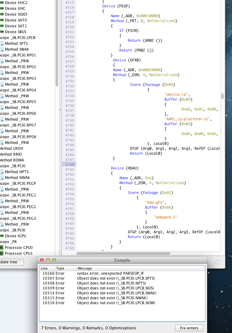

theconnactic Posted March 17, 2013 Author Share Posted March 17, 2013 Is this format and patch acceptable (the G210 appears in the DSDT as PXSX, not GFX0)? Device (PXSX) { Name (_ADR, Zero) Name (_PRW, Package (0x02) { 0x09, 0x04 }) Method (_DSM, 4, NotSerialized) { Store (Package (0x1C) { "device-id", Buffer (0x04) { 0x0A, 0x65, 0x00, 0x00 }, "vendor-id", Buffer (0x04) { 0xDE, 0x10, 0x00, 0x00 }, "driver-ist", Buffer (0x30) { /* 0000 */ 0x00, 0x01, 0x5a, 0x18, 0x80, 0xFF, 0xFF, 0xFF, /* 0008 */ 0x01, 0x00, 0x00, 0x00, 0x80, 0xFF, 0xFF, 0xFF, /* 0010 */ 0x00, 0x01, 0x5a, 0x18, 0x80, 0xFF, 0xFF, 0xFF, /* 0018 */ 0x02, 0x00, 0x00, 0x00, 0x80, 0xFF, 0xFF, 0xFF, /* 0020 */ 0x00, 0x01, 0x5a, 0x18, 0x80, 0xFF, 0xFF, 0xFF, /* 0028 */ 0x03, 0x00, 0x00, 0x00, 0x80, 0xFF, 0xFF, 0xFF }, }, Local0) DTGP (Arg0, Arg1, Arg2, Arg3, RefOf (Local0)) Return (Local0) } Best regards! Link to comment https://www.insanelymac.com/forum/topic/286474-about-using-discrete-and-integrated-graphics-at-the-same-time/page/2/#findComment-1897786 Share on other sites More sharing options...
Rampage Dev Posted March 17, 2013 Share Posted March 17, 2013 Yep, you got it. Search for PXSX and replace with GFX0 but make sure you replace GFX0 to IGPU before doing this. Why are you not using the full edit? Link to comment https://www.insanelymac.com/forum/topic/286474-about-using-discrete-and-integrated-graphics-at-the-same-time/page/2/#findComment-1897797 Share on other sites More sharing options...
theconnactic Posted March 17, 2013 Author Share Posted March 17, 2013 Thank you, Rampage! The replacement of GFX0 by IGPU was previously done for getting the HD4000+9800GT to work together, so i can just change PXSX to GFX0. Gonna test it and report back. All the best! Link to comment https://www.insanelymac.com/forum/topic/286474-about-using-discrete-and-integrated-graphics-at-the-same-time/page/2/#findComment-1897798 Share on other sites More sharing options...

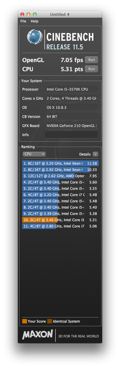

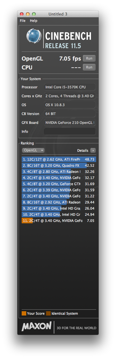

theconnactic Posted March 17, 2013 Author Share Posted March 17, 2013 Thank you very much indeed, Rampage! Worked exactly as you told it would! Best regards! P.S.: Here's some benchmark results (the crappy performance is what's expected from the G210 - conversely, a measure of how comparatively decent integrated solutions can be): 1 Link to comment https://www.insanelymac.com/forum/topic/286474-about-using-discrete-and-integrated-graphics-at-the-same-time/page/2/#findComment-1897935 Share on other sites More sharing options...
