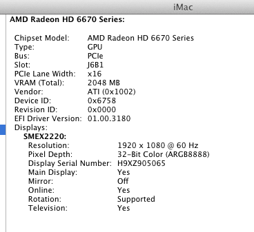

Slice Posted February 18, 2013 Share Posted February 18, 2013 Hi, srsx May be you miss this thread and the post inside. My graphics and my config config.plist.zip Sleep/wake, DVDplayer and 4x4Evolution works fine. Link to comment https://www.insanelymac.com/forum/topic/286432-sapphire-radeon-6670-recognized-as-amd-radeon-6xxx-1024mb/#findComment-1890147 Share on other sites More sharing options...
srsx Posted February 18, 2013 Author Share Posted February 18, 2013 @alexander - Rampage's Guide. Something about DIGA and DIGB or similar in the editing section @Rampage Dev - I couldn't understand it, for the personality editing part. It was too confusing. Booting with AtiConfig=Lotus, and Ipomoea do not yeild a working framebuffer (Just AMDRadeonFrameBuffer from ioreg) @Slice I'm not using Clover. But it looks like you got it to work, although yours has only 3 ports. My ROM output has 4, I believe I need a personality with 4, despite the back of my card having only 3 ports. Would I need to use Clover to get these settings? Trying yours now. Where is the sense ID in my rom? : 194X1306.S22: TURKS XT C33302 GDDR5 64Mx32 Subsystem Vendor ID: 174b Subsystem ID: e194 Object Header Structure Size: 246 Connector Object Table Offset: 3e Router Object Table Offset: 0 Encoder Object Table Offset: b5 Display Path Table Offset: 12 Connector Object Id [19] which is [DISPLAY_PORT] encoder obj id [0x20] which is [iNTERNAL_UNIPHY1 (osx txmit 0x11 [duallink 0x1] enc 0x2)] linkb: false Connector Object Id [12] which is [HDMI_TYPE_A] encoder obj id [0x21] which is [iNTERNAL_UNIPHY2 (osx txmit 0x12 [duallink 0x2] enc 0x4)] linkb: false Connector Object Id [2] which is [DVI_I] encoder obj id [0x1e] which is [iNTERNAL_UNIPHY (osx txmit 0x10 [duallink 0x0] enc 0x0)] linkb: false Connector Object Id [2] which is [DVI_I] encoder obj id [0x15] which is [iNTERNAL_KLDSCP_DAC1 (osx txmit 0x00 enc 0x10?)] linkb: false Link to comment https://www.insanelymac.com/forum/topic/286432-sapphire-radeon-6670-recognized-as-amd-radeon-6xxx-1024mb/#findComment-1890199 Share on other sites More sharing options...
Slice Posted February 19, 2013 Share Posted February 19, 2013 @Slice I'm not using Clover. But it looks like you got it to work, although yours has only 3 ports. My ROM output has 4, I believe I need a personality with 4, despite the back of my card having only 3 ports. Would I need to use Clover to get these settings? Trying yours now. Where is the sense ID in my rom? : 194X1306.S22: TURKS XT C33302 GDDR5 64Mx32 Subsystem Vendor ID: 174b Subsystem ID: e194 Object Header Structure Size: 246 Connector Object Table Offset: 3e Router Object Table Offset: 0 Encoder Object Table Offset: b5 Display Path Table Offset: 12 Connector Object Id [19] which is [DISPLAY_PORT] encoder obj id [0x20] which is [iNTERNAL_UNIPHY1 (osx txmit 0x11 [duallink 0x1] enc 0x2)] linkb: false Connector Object Id [12] which is [HDMI_TYPE_A] encoder obj id [0x21] which is [iNTERNAL_UNIPHY2 (osx txmit 0x12 [duallink 0x2] enc 0x4)] linkb: false Connector Object Id [2] which is [DVI_I] encoder obj id [0x1e] which is [iNTERNAL_UNIPHY (osx txmit 0x10 [duallink 0x0] enc 0x0)] linkb: false Connector Object Id [2] which is [DVI_I] encoder obj id [0x15] which is [iNTERNAL_KLDSCP_DAC1 (osx txmit 0x00 enc 0x10?)] linkb: false This is an output from red sock_bios_decoder. If you want to see senseid then you need radeon_bios_decoder by bcc9. In my case iMac:test slice$ ./radeon_bios_decode <c0000.bin ATOM BIOS Rom: SubsystemVendorID: 0x1458 SubsystemID: 0x2557 IOBaseAddress: 0xe000 Filename: R667D32I.F1 BIOS Bootup Message: GV-R667D3-2GI/F1 PCI ID: 1002:6758 Connector at index 0 Type [@offset 44282]: HDMI-A (11) Encoder [@offset 44286]: INTERNAL_UNIPHY2 (0x21) i2cid [@offset 44356]: 0x92, OSX senseid: 0x3 Connector at index 1 Type [@offset 44292]: DVI-D (3) Encoder [@offset 44296]: INTERNAL_UNIPHY (0x1e) i2cid [@offset 44383]: 0x95, OSX senseid: 0x6 Connector at index 2 Type [@offset 44302]: VGA (1) Encoder [@offset 44306]: INTERNAL_KLDSCP_DAC1 (0x15) i2cid [@offset 44410]: 0x90, OSX senseid: 0x1 iMac:test slice$ Link to comment https://www.insanelymac.com/forum/topic/286432-sapphire-radeon-6670-recognized-as-amd-radeon-6xxx-1024mb/#findComment-1890449 Share on other sites More sharing options...
BuXb Posted April 5, 2013 Share Posted April 5, 2013 Slice, my Sapphire Radeon 6670 has the same values as yours. I see you are actively developing Clover, that's great and good for me to know. If you think it's better for me to switch from Chameleon to Clover to have this card function 100% I will. But before that I need to ask a few questions to find the right direction (10.8.3) (anybody else feel naturally free to answer, too): to which ports do you have monitors attached? I have one at DVI and one at HDMI. The problem with GraphicsEnabler YES is that BOTH turn black as soon as the GUI should load (I see a brief bright grey then black), regardless if Chameleon auto-sets the fb (Pithecia) or if U choose Ipomoea as you suggest. With VGA + HDMI all is OK. So I would need to know from you if you also have DVI + HDMI attached at the same time, and if you do NOT experience the balck screens. would Clover for sure solve the issue described in 1.? does clover install a boot or similar file to / which can be CHAINLOADED like Chameleon boot? I am using Grub4DOS as bootloader on a hybrid MBR/GPT partition HDD, which loads Chameleon just fine via title 10.8.3 via Chameleon_2189 kernel /Chameleon_2189.boot when I boot without GraphicsEnabler, I have full QE/Ci, and even DVD player launches. Wow. Oddly enough, when I run ioreg | grep ATY, it outputs the generic ATY,AMD,RadeonFramebuffer. Now that's new to me .. I thought DVD player REQUIRES a dedicated fb personality to launch? Since DVD Player does launch DESPITE generic ATY,AMD,RadeonFramebuffer, which benefit would I have with the correct fb set via plist? Thank you for your time, expertise, and efforts! Link to comment https://www.insanelymac.com/forum/topic/286432-sapphire-radeon-6670-recognized-as-amd-radeon-6xxx-1024mb/#findComment-1903945 Share on other sites More sharing options...
Slice Posted April 17, 2013 Share Posted April 17, 2013 BugsB, Sorry for delay with answer. 1. My monitor attached to DVI. I tested also with VGA and see no differencies (it supports less resolution but 1920x1080 yes). With GraphicsEnabler=Yes (GraphicsInjjector in the case of Clover) I got black screen if no connector patch is applied. With =No there is RadeonFramebuffer that works almost good. Just DVDPlayer crashes. I have no devices to attach to HDMI. What it may be? My monitor has DVI connector. 2. Clover works for me. 3. Clover's boot file can be started exactly as Chameleon's one. But boot1h for Chameleon has a bug corrected in boot1h2 distributed with Clover. 4. I said about this in 1. In my case DVD player requires dedicated framebuffer. Else crashes. 5. May be multimonitor configuration? Link to comment https://www.insanelymac.com/forum/topic/286432-sapphire-radeon-6670-recognized-as-amd-radeon-6xxx-1024mb/#findComment-1907990 Share on other sites More sharing options...
