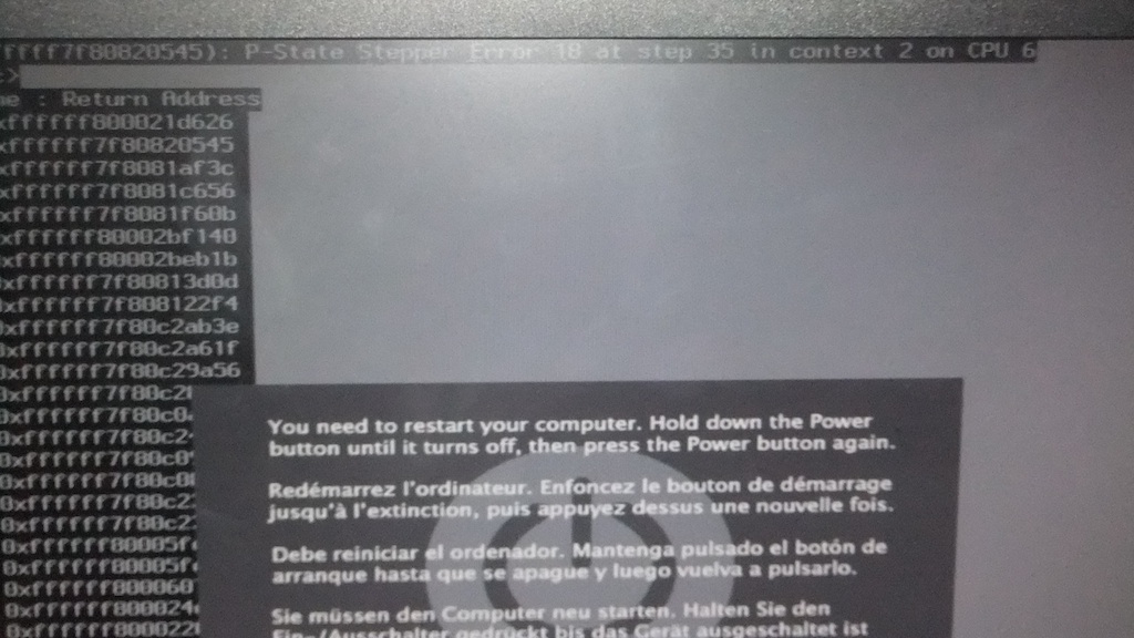

RCOO Posted March 7, 2013 Author Share Posted March 7, 2013 Ok. Some more problems. The battery icon in the menu bar has an X and says: "No battery is available", "Power Source: battery". Â This happens when I only have the AC charger connected, and no battery inserted. I tried replacing AppleACPIPlatform with the one from version 10.6.7, and nothing. The source of the power keeps being indicated as the battery, which isn't even in the laptop. Â Â Besides that: I patched AICPM and removed NullCPUPowerManagement. I have SSDT and it's being loaded according to bdmesg. P and C states are being generated. I am however having P-State stepper error 18. To try to solve this problem I followed the instructions on this topic (please read english instructions): http://olarila.com/f...start=60#p13534 (my SMBios is MacBookPro8.2. I removed the indicated keys: FanThrottledRPM and FanMax (although the keys appeared in a reverse order comparing to the guide). Attached is the KP generated. I am able to boot if I restore the NullCpuPowerManagement kext. Â Â Any clues on how to solve these issues? Link to comment https://www.insanelymac.com/forum/topic/286366-problems-in-my-installation/#findComment-1894687 Share on other sites More sharing options...
