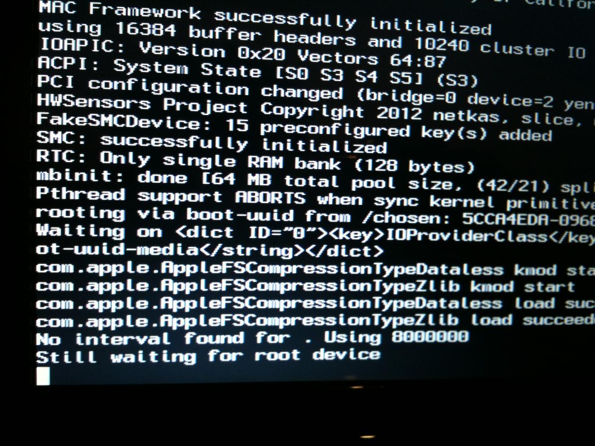

curt290 Posted February 12, 2013 Share Posted February 12, 2013 Hello my friends i just bought a sony vaio and i would like to install Mountain lion ooi it. The problem is that when i plug the usb installer i get the error "still waiting for root device " after the following "no interval found for . using 8000000" Please help me!!!!! Here are my specs: SONY VAIO SV-E1512H1EW INTEL 330 SERIES SSDSC2CT120A3K5 120GB Intel Core i3-3110M 4096 MB (1 x 4096 MB) DDR3 AMD Radeon HD 7650M Here is a photo Link to comment https://www.insanelymac.com/forum/topic/286313-still-waiting-for-root-device-during-install-on-sony-vaio/ Share on other sites More sharing options...
Onixs Posted February 12, 2013 Share Posted February 12, 2013 Try: 1. Plug to usb 2.0 port 2. Use USBBusFix=Yes 3. busratio=xx (google your xx) Link to comment https://www.insanelymac.com/forum/topic/286313-still-waiting-for-root-device-during-install-on-sony-vaio/#findComment-1888164 Share on other sites More sharing options...
curt290 Posted February 12, 2013 Author Share Posted February 12, 2013 Thanks for your reply. tried in usb 2.0 port and still the same, tried USBBUSFIX=Yes still the same... how to find my bus ratio? Link to comment https://www.insanelymac.com/forum/topic/286313-still-waiting-for-root-device-during-install-on-sony-vaio/#findComment-1888171 Share on other sites More sharing options...

iFIRE Posted February 12, 2013 Share Posted February 12, 2013 try this boot flag: -f -v rd=disk0s2 UseKernelCache=No npci=0x2000 in rd=disk, 0 is your disk , and s2Partition, see your partition, s2 in Example Link to comment https://www.insanelymac.com/forum/topic/286313-still-waiting-for-root-device-during-install-on-sony-vaio/#findComment-1888177 Share on other sites More sharing options...
curt290 Posted February 12, 2013 Author Share Posted February 12, 2013 Thanks iFire!!! - f -v did the work but now after install i get stuck after " iobluetoothcontroller completed" how too bypass that? Link to comment https://www.insanelymac.com/forum/topic/286313-still-waiting-for-root-device-during-install-on-sony-vaio/#findComment-1888307 Share on other sites More sharing options...
