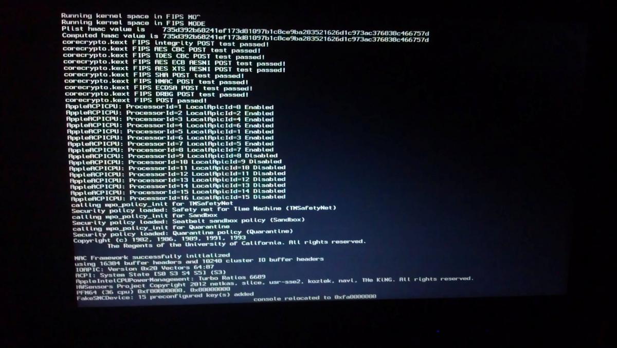

SRSR333 Posted February 2, 2013 Share Posted February 2, 2013 Well, as the title says, I am not able to boot to OS X desktop with a DSDT in my /Extra folder after I shutdown from Windows on my Samsung RF411 notebook. Verbose mode always hangs somewhere around System State [s0 S3 S5 etc..] What's the problem? Link to comment https://www.insanelymac.com/forum/topic/286084-solved-dsdt-error-in-os-x-verbose-after-windows-shutdown/ Share on other sites More sharing options...

SRSR333 Posted February 3, 2013 Author Share Posted February 3, 2013 And the screenshot now: Link to comment https://www.insanelymac.com/forum/topic/286084-solved-dsdt-error-in-os-x-verbose-after-windows-shutdown/#findComment-1885775 Share on other sites More sharing options...

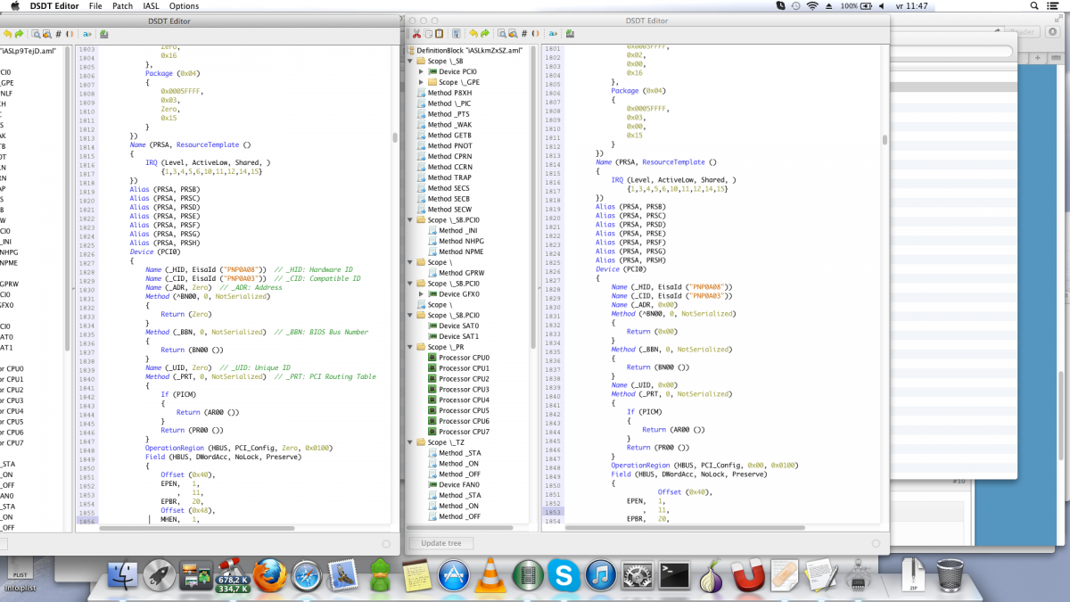

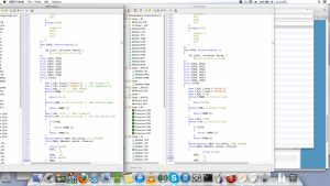

SRSR333 Posted February 7, 2013 Author Share Posted February 7, 2013 Alright, here's my extracted unedited DSDT.dsl, the patch file I use, and my currently patched DSDT. Please take a look... Thanks... DSDT_SRSR333.zip Link to comment https://www.insanelymac.com/forum/topic/286084-solved-dsdt-error-in-os-x-verbose-after-windows-shutdown/#findComment-1886826 Share on other sites More sharing options...
WaldMeister Posted February 7, 2013 Share Posted February 7, 2013 Thank you. Can you try the following file and see if it solves the problem? Applied basic patches and fixes. The 2 dsl files differ a lot, and the patched one, did not match the txt, had extra info in it that is not provided by the patch. DSDT.aml.zip Link to comment https://www.insanelymac.com/forum/topic/286084-solved-dsdt-error-in-os-x-verbose-after-windows-shutdown/#findComment-1886833 Share on other sites More sharing options...
SRSR333 Posted February 8, 2013 Author Share Posted February 8, 2013 Thank you. Can you try the following file and see if it solves the problem? Applied basic patches and fixes. The 2 dsl files differ a lot, and the patched one, did not match the txt, had extra info in it that is not provided by the patch. Right.. I'm not too literate when it comes to DSDT. What exactly do you mean when you say that the patched DSDT had 'extra info in it that was not provided by the patch'? I simply extracted my DSDT with DSDT Editor, applied the patch, then edited out errors and warnings with the 'Fix Errors' button in the compiler. I didn't do anything else.. Link to comment https://www.insanelymac.com/forum/topic/286084-solved-dsdt-error-in-os-x-verbose-after-windows-shutdown/#findComment-1886910 Share on other sites More sharing options...
WaldMeister Posted February 8, 2013 Share Posted February 8, 2013 Mostly these extra references. So you extracted the DSDT from within OSX? Link to comment https://www.insanelymac.com/forum/topic/286084-solved-dsdt-error-in-os-x-verbose-after-windows-shutdown/#findComment-1886985 Share on other sites More sharing options...

SRSR333 Posted February 8, 2013 Author Share Posted February 8, 2013 Probably a stupid question but does it hang when booting Mac without any DSDT file? You don't mention it explicitly in your first post. If it doesn't, does it hang with a DSDT with fixed errors only? No, its not a stupid question. Yes, I didn't address it in my first post. OS X only shows this error WHEN I HAVE a DSDT.aml in /Extra folder. As I mentioned earlier, I have to use the boot flag DSDT = null in Chameleon before I boot else I get an error. This error only happens after a shutdown from Windows. And @Lejenk, yes, I extracted this DSDT in OS X. I used MaciASL to extract, but I use DSDT editor to patch and stuff Link to comment https://www.insanelymac.com/forum/topic/286084-solved-dsdt-error-in-os-x-verbose-after-windows-shutdown/#findComment-1887023 Share on other sites More sharing options...
k3nny Posted February 8, 2013 Share Posted February 8, 2013 (edited) So it does! work with a DSDT without any problems whatsoever as long as you don't have any Windows boots in between? Then it is clearly not a DSDT issue. EDIT: What Windows version are you using? Things that you could try. - Use patched AppleRTC. I don't know if Chameleon can patch it, otherwise you will need to do it yourself. - Set Windows to use Unreal err, I mean Universal Clock Time (UTC) instead of Local Time (click) Edited February 8, 2013 by k3nny Link to comment https://www.insanelymac.com/forum/topic/286084-solved-dsdt-error-in-os-x-verbose-after-windows-shutdown/#findComment-1887044 Share on other sites More sharing options...
