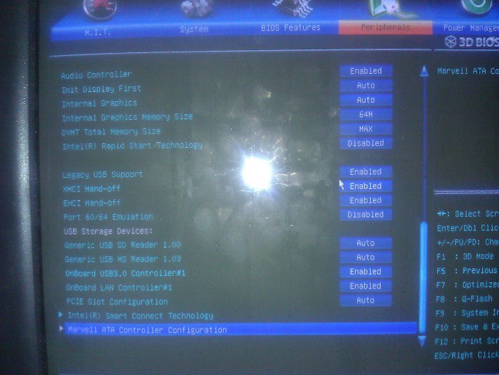

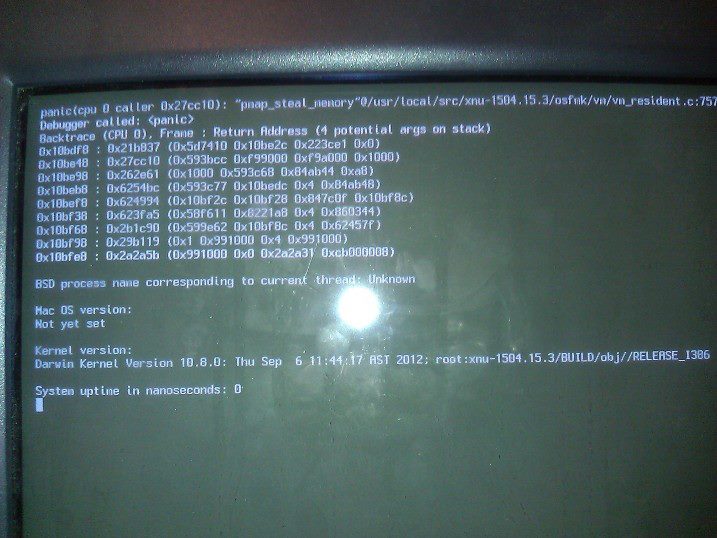

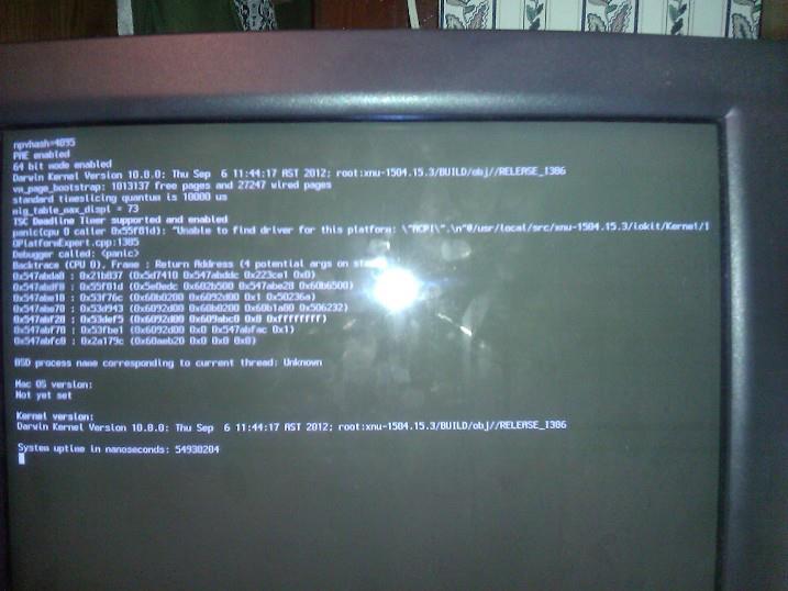

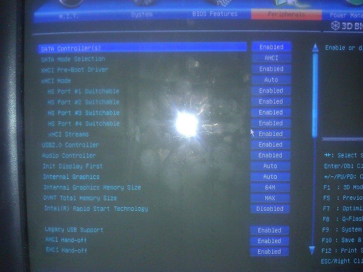

Cyris Posted January 25, 2013 Author Share Posted January 25, 2013 The First image is what i'm getting with the overclocking on and with bootline of -v graphicsenabler=yes npci 0x2000 as i have just booted back to windows and saw your reply. this is with iB00T ivy bridge boot cd to get the mac os x lion disc to boot. This is the kernel panic i get from using -v -x -f with all overclocking disabled and here are pics of my bios settings. bare with me as I'm ordering my new monitor tomorrow. Link to comment Share on other sites More sharing options...
artur_pt Posted January 25, 2013 Share Posted January 25, 2013 hello try to boot mountain lion , that have native support for u cpu, is u best chance to install mac os x use a legacy cd , the best way is to use a usb image in a pen... -f -v GraphicsEnabler=No good hack Link to comment Share on other sites More sharing options...
Cyris Posted January 25, 2013 Author Share Posted January 25, 2013 is there any other option as I do not have any DVD DL discs nor a 8gb flash drive at the moment either. is it possible to get this running on Lion then update to ML? I've seen lots of people on here and tonymac get snow leopard and up running on ivy bridge Link to comment Share on other sites More sharing options...
rockinron_1 Posted January 25, 2013 Share Posted January 25, 2013 Not sure what your HDD config is but you can create the installer on a HDD partition (its often a good idea to have this anyway). What I'd suggest: Partition your drive for ML with a small (~10GB) partition for the installer and the rest for ML. Use the guide in my sig to create the installer on the install partition then install to the ML partition. Vanilla installs are a far better way to go than distro. There is a kernel to allow older versions of OS X to work with your CPU but this is just making unnecessary work for you. Link to comment Share on other sites More sharing options...
