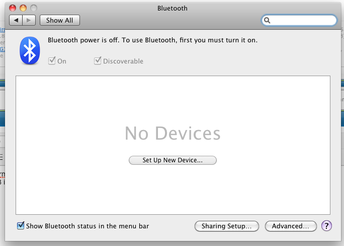

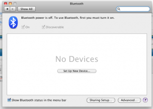

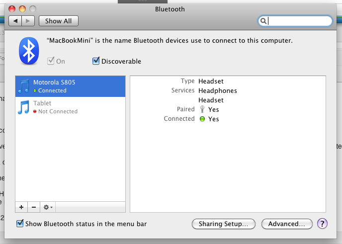

aikidoka25 Posted July 21, 2013 Share Posted July 21, 2013 UPDATE: I managed to have it works by turning on bluetooth using blueutil. I managed to compile IOath3kfrmwr.kext from github and it works on my 10.6.8 HDD (1). However, I have another 10.6.8 setup on another HDD (2) which reports the bluetooth is off and it cannot detect or detected by any other devices. HDD (1) was a copy of HDD (2), it is the image of HDD (1) at one point in time, but not used/updated. I did a diff of the 2 drives S/L/E and couldn't find any differences. Any idea why HDD (2) reports bluetooth is off? How to resolve my issue beside restoring HDD(1) to HDD(2) ? Link to comment https://www.insanelymac.com/forum/topic/285199-ar9002wb-1ng-wifi-combo-cardar9285-ar3011-bluetooth/#findComment-1933516 Share on other sites More sharing options...
