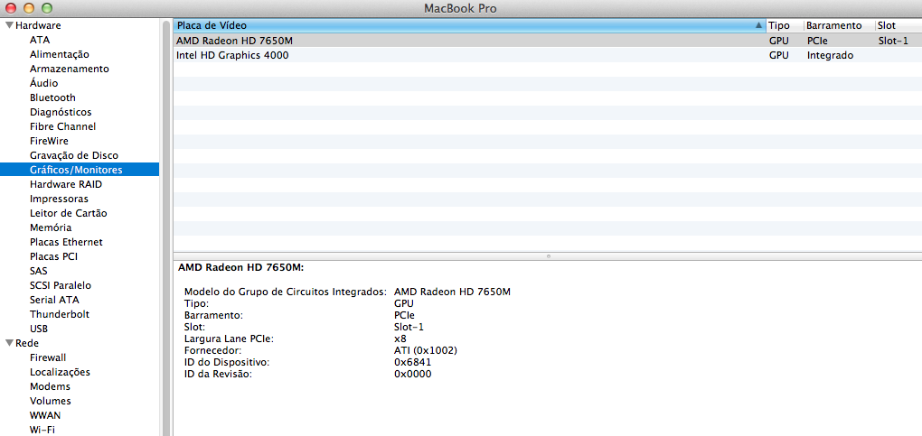

mendietinha Posted January 4, 2013 Share Posted January 4, 2013 75 1 0xffffff7f8165e000 0x72000 0x72000 com.apple.kext.AMDSupport (8.1.0) <65 10 9 7 5 4 3 1> 76 0 0xffffff7f816d0000 0x1e7000 0x1e7000 com.apple.kext.AMD6000Controller (8.1.0) <75 65 10 9 5 4 3 1> 80 0 0xffffff7f81d8c000 0x3b8000 0x3b8000 com.apple.AMDRadeonAccelerator (1.0.6) <73 67 65 10 7 5 4 3 1> same card, i did some modifications, in agpm and boot, but what i can see is that we dont have the framebuffer loaded. for me, the aty_init does make any change. mine load the ati6000 because this card is listed on it. i can put in both or erase from the ati6000 and insert in ati7000 without any change. if i boot with ge=y the gpu apears and some info pops up, but it loads the same things. but at least something diferent happens. sorry for post some info from my gpu. im here to test and help as much as possible. cheers. the lack of vram and output monitors is because of the framebuffer who doesnt load? again, sorry if im causing any trouble. Link to comment https://www.insanelymac.com/forum/topic/284997-enabling-qeci-on-sve1711x1eb/page/2/#findComment-1878102 Share on other sites More sharing options...

styrian Posted January 7, 2013 Share Posted January 7, 2013 i have the latest enoch here with no changes. when i boot with ge=y the info of the ati shows up in the start of the boot info. Which options do you have in bios for gfx output? You have written, that you have the HD4000 on board. If this is active and you have in bios no option for only descrete gfx, your 7650m will not work. Perhaps a bios mod can make this possible. Have fun. Link to comment https://www.insanelymac.com/forum/topic/284997-enabling-qeci-on-sve1711x1eb/page/2/#findComment-1878838 Share on other sites More sharing options...

styrian Posted January 8, 2013 Share Posted January 8, 2013 yes. i need a bios mod. but i never needed before. where can i get some? thanks. At first you should look at your dsdt, it there is the verb "descrete" or "dedicated". If one of these verbs are not in your dsdt, I think it is not possible, to mod your bios for this option. If one of this verbs is there, the option might only be hidden and can be unlocked. You have to "google" for a mod of your bios or ask at the usual places for it. But installing a moded bios is a little bit risky. It can brick your laptop and make it unusable. It something goes wrong and there is no way to reinstall an original bios at booting up your device without entering the bios, you have to send it back to factory for repair at your own costs. Risky is it especially, if the mod is not yet confirmed working. Have fun. Link to comment https://www.insanelymac.com/forum/topic/284997-enabling-qeci-on-sve1711x1eb/page/2/#findComment-1878934 Share on other sites More sharing options...
