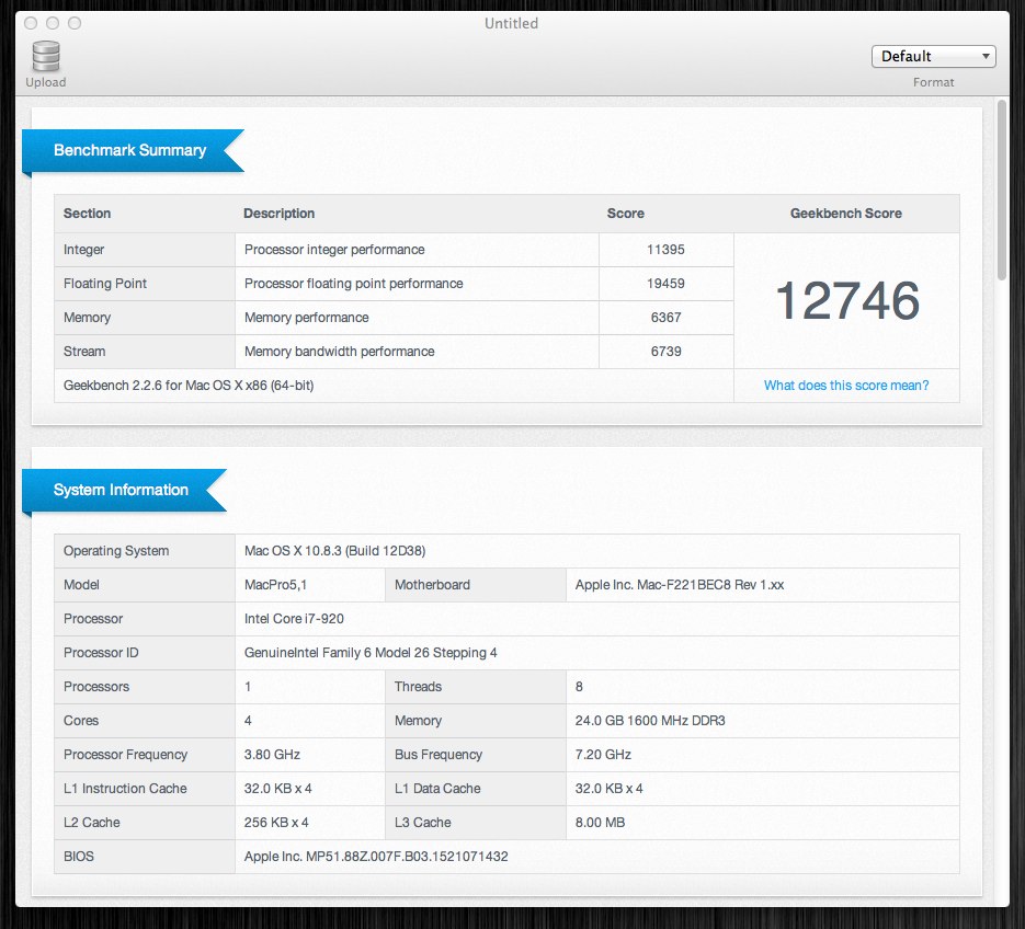

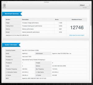

eep357 Posted December 13, 2012 Share Posted December 13, 2012 (edited) OK, this interest's me, I'm making a new topic and will move this post and the others about to it. Â Â And with that bit of house cleaning out of the way...I took a look at activity monitor to see what files/folders it had open and also sampled the process to do the same, nothing stood out as a 2nd possible location it's getting info from, so the question remains, is this a DSDT issue or is Geekbench also looking somewhere else? Is it the same when using iMac or any other DSDT's? I have a Xserve DSDT laying around somewhere I can dig and see what it thinks about that? Edited December 13, 2012 by eep357 Final post moved from http://www.insanelymac.com/forum/topic/278907-permanently-banned-from-tonymacx86/page__st__20 1 Link to comment https://www.insanelymac.com/forum/topic/284987-geekbench-show-macpro51-while-real-mac-show-mac-pro-mid-2010/#findComment-1873153 Share on other sites More sharing options...

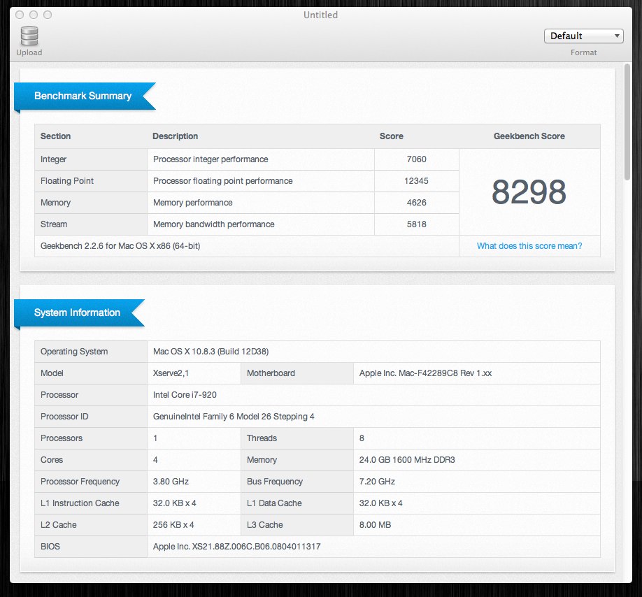

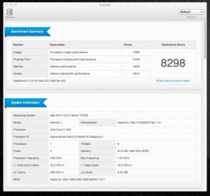

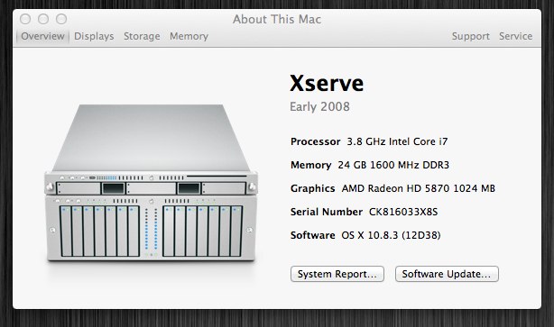

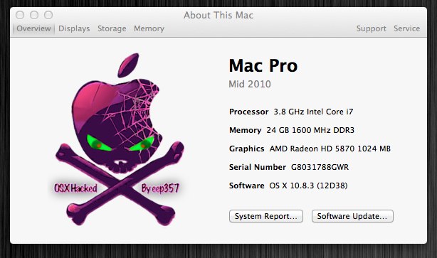

eep357 Posted December 13, 2012 Share Posted December 13, 2012 Very interesting indeed. Thankfully this seems to confirm more that it's just Geekbench, but hey why not strive for perfection?  So....xServe.. Not a good choice of smbios for x58. With that being the only difference: vs  And epic fail at making Geekbench show xServe (Early 2008) as the model too 1 Link to comment https://www.insanelymac.com/forum/topic/284987-geekbench-show-macpro51-while-real-mac-show-mac-pro-mid-2010/#findComment-1873283 Share on other sites More sharing options...
eep357 Posted December 14, 2012 Share Posted December 14, 2012 So after doing a little playing around with About this Mac and System Profiler strings, adding CPU sub model amongst others it occurred to me Geekbench already had i7-920 when nothing else did. Then stepping info too, so it must be calling CPUID direct and not getting all its info from the OS. Opened it in hex editor and sure enough it does, so if it does infact use processor info as a basis of "real" vs "hack", you'd have to spoof it somehow. It could also be a if, then, else thing where if it's not in a certain file location it will move to next option to get system info, which would explain the bootcamp vs osx on real mac difference. There's at least a few different places this info could be gotten in OSX's file system I'll dig into as time permits. I would think maybe CPUID were mandatory for it to run low level instructions on the benches, but if so, don't think the xserve bench wouldn't have been so low just by changing a smbios. 1 Link to comment https://www.insanelymac.com/forum/topic/284987-geekbench-show-macpro51-while-real-mac-show-mac-pro-mid-2010/#findComment-1873511 Share on other sites More sharing options...
solarein Posted December 14, 2012 Author Share Posted December 14, 2012 Hmm...is it possible that while running the Xserve DSDT the CPU power states are not being set correctly? Is there a way to reliably get the CPU multiplier and core utilization while running Geekbench? Link to comment https://www.insanelymac.com/forum/topic/284987-geekbench-show-macpro51-while-real-mac-show-mac-pro-mid-2010/#findComment-1873515 Share on other sites More sharing options...

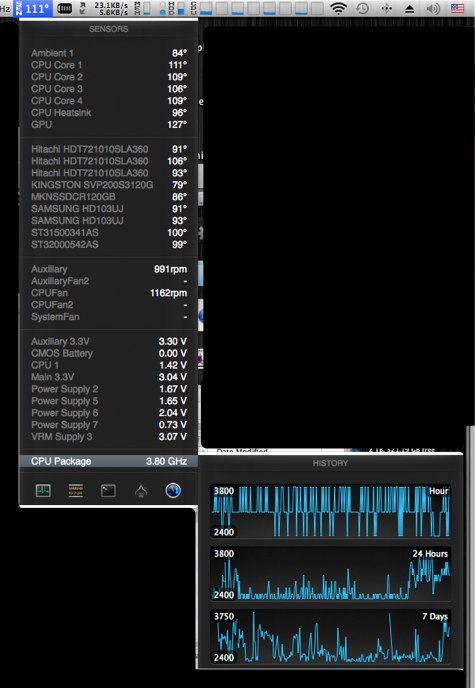

eep357 Posted December 14, 2012 Share Posted December 14, 2012 Like iStat4? Also history graphs CPU activity, but it doesn't work on xServe, just yellow caution triangles in the menubar, probably not a mac model on their supported list. Still I'm not a big fan of changing smbios too often as it creates different profiles in all preferences files and screws up local dns discovery. Small annoyances but still. Link to comment https://www.insanelymac.com/forum/topic/284987-geekbench-show-macpro51-while-real-mac-show-mac-pro-mid-2010/#findComment-1873539 Share on other sites More sharing options...
eep357 Posted December 14, 2012 Share Posted December 14, 2012 OK, so after playing around with different stuff like this: nothing affected GeekBench, until I changed the Model in smbios from MacPro5,1 to MacPro (Mid 2010), Geekbench then listed my Mac model as "Hackintosh". So my only conclusion then would be, that right now, it must at least have it's doubts that it's a hack. Link to comment https://www.insanelymac.com/forum/topic/284987-geekbench-show-macpro51-while-real-mac-show-mac-pro-mid-2010/#findComment-1873557 Share on other sites More sharing options...
